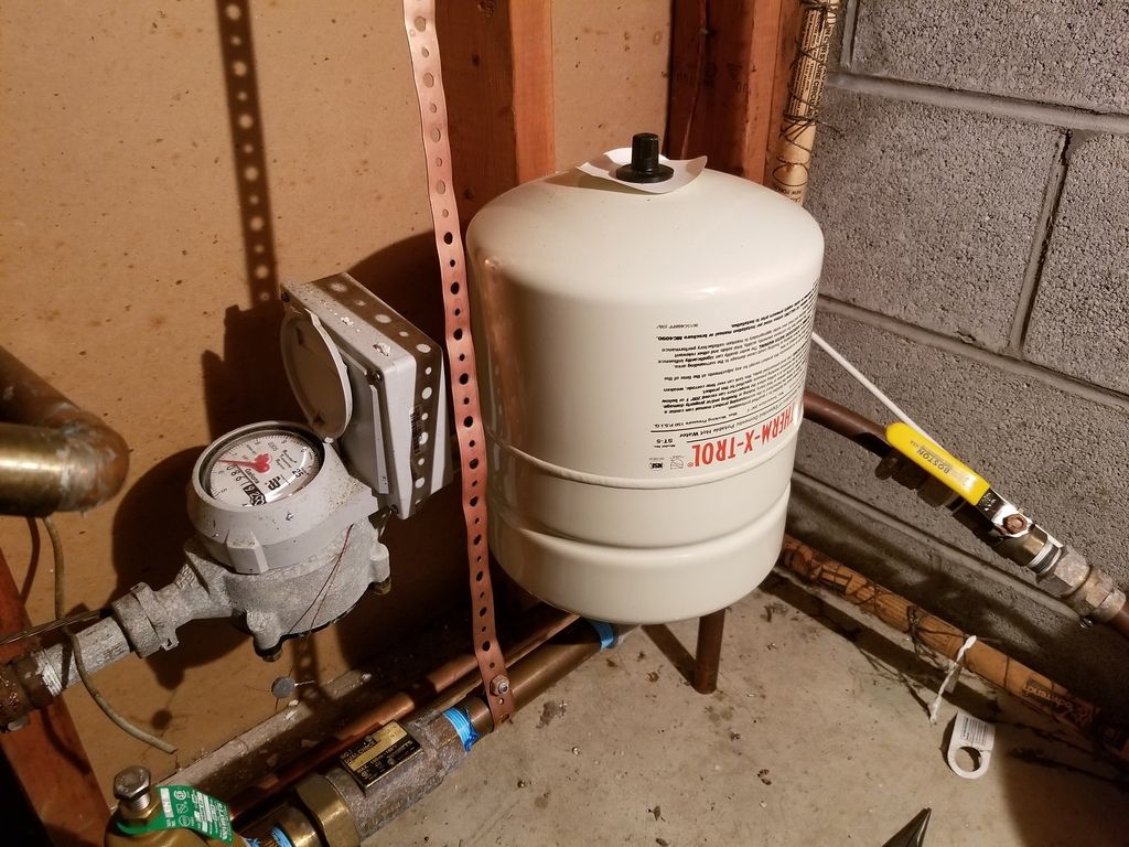

It's the valve inside the house. I walked around our front lawn but can't find the valve outside the house. Our water meter is just a meter attached to the outside wall of our house -- I don't see a valve there.
When I turn the valve inside the house, I hear a very faint clicking sound.
I'll see if I can remove the valve handle and try that.

I was able to remove the handle and can turn the stem with a wrench.
I hear a faint clicking sound -- two soft clicks in succession, actually -- when I turn the handle but can't place where it's coming from. It feels like it's coming from the left side of the valve.
I'm still waiting for the town water dept. to arrive.
I took some photos.

The town water dept came and had a look at the valve but can't find anything. He doubts it's the valve but just said it could happen. He also bypassed our water softener so it's not that, he said. He suspects it could be the "things" -- I can't remember the terminology he used -- on the left of the valve around the meter. So I'm calling a plumber now.

Problem solved. It was the pressure reducing valve. The plumber came and loosened it and water started running.
He said when I turned off the water, I probably just turned it back on quickly after I was done with my plumbing work (replacing the faucet washer).
He said when turning water back on, I should do it slowly and not just jerk the lever back to horizontal (parallel to the pipe) position. Turning it on slowly will allow tiny solid particles (which is normal) inside the pipe to flow through instead of blocking the pressure reducing valve.
He showed me how to loosen the pressure reducing valve it in case it happens again.
