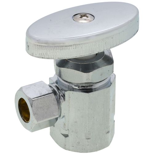

You could unscrew the piping from where they drop down and use brass nipples with flexible hoses. No welding or spacing issues to worry about.
Old 09-03-18, 05:14 PM
Z
Join Date: Sep 2005
Posts: 6,124
Received 425 Upvotes on 378 Posts
I'd go with Audioslave22's idea. I'd remove a few of those nipples and replace with a 1/2" FIP angle stop. Then flexible supply lines to connect to the faucet.
Something like this:

Thanks for the ideas! Yeah, it is probably a good idea to get some turnoff valves installed either way. Right now I have to turn off all the water in the house to fix =/
