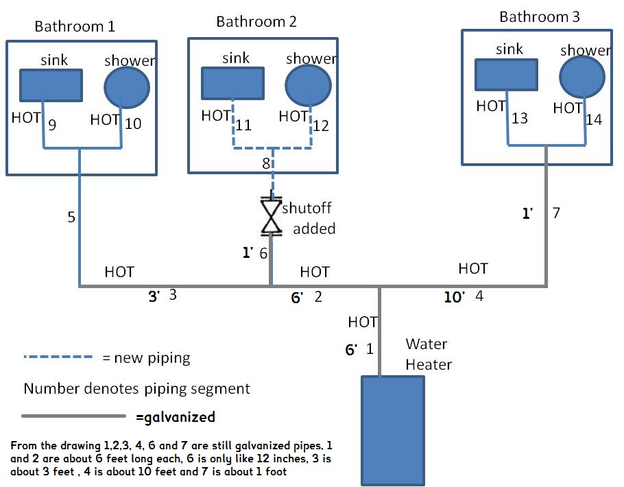

ok sorry for late reply this was happening. First of the problem only with the hot water in the 3 showers, cold is fine and all sinks are fine. Prior to me remodeling the bathroom there were 3 working showers. The piping for all the water lines under the crawlspace for both hot and cold are 3/4 steel, once they get to each bathroom they turn to 1/2 copper. From the water heater a 3/4 steel pipe comes out down to crawlspace (about 6 feet) into a "T" connection, the right side of the "T" goes to one bathroom, kitchen and laundry, the left side goes to the other 2 bathrooms.
I remodeled the first of the 2 bathrooms on the left. I replaced about 10 feet of steel 3/4 pipe leading to this bathroom with 3/4 copper and added two shut off valves where the steel and copper meet so i could shut off water while i worked on bathroom
There is a good chance that rust or debri got loose when i had to cut a section with saw. But I didnt think that could be the issue since all the other sinks are fine. But now I think that might be it.
Well Iím picture happy and I did this for myself to kind of pictorially represent the puzzle Ė to my mind anyway, so here it is for what itís worth. How are 10,12, and 14 affected after the new piping was installed, but everything else is still OK?

Easy, something occurred in #1 at the time of the rework!

How did it NOT affect 9,11, and 13 when it DID affect 10,12, and 14?

Which pipes in the drawing are galvy? If there are 3 disparate low-volume points, it kinda point to 3 problems. No one point would cause it. Random bits of debris /might/ be an explanation. Or not. Like I said, I'm here looking at a monitor. It might be three balancing spools that are stuck, but that would be an unlikely coincidence. Things need to be taken apart by two people. One to look and one to turn the water on & off. Then you might get a better idea.
And, come to think of it, when's the last time anyone saw intact galvanized water pipe? I don't think it's been installed much since the '60's (a decade from an earlier century).

Man that's a good drawing!!!. That's exactly how my setup is, i was trying to use MS paint to draw it lol
I didn't come back to this post since I had given up and was going to just wait until I have money to re-pipe everything at the bottom (although I think since everything else is working fine I could have gotten a couple of more years out of it),
From the drawing 1,2,3, 4, 6 and 7 are still galvanized pipes. 1 and 2 are about 6 feet long each, 6 is only like 12 inches, 3 is about 3 feet , 4 is about 10 feet and 7 is about 1 foot (not sure if those numbers help.
I haven't had time to look at cartridges since when i looked at one i couldn't figure out how to remove it, looked kind of old. One thing my wife notice was that now when we turn hot water it makes a tapping noise but again sinks work fine.
My guess is there is some debri restricting it at number 1 pipe in the diagram. Here is the dumb question of the day, if I remove the valve from the hot water from one of the sinks so that only the 1/2 copper pipe is sticking out so it has full flow, can i then go tap/hit on pipe 1 to loose any debris and hopefully flush out through the open pipe ? maybe do it to the cold also.
Look at picture of clogged pipe in post 19, chances are if it's plugged, it's plugged along the entire length of pipe, it's not going to be flushed out!

I guess we will be saving on water for a while until I re-pipe everything. Thanks to everyone for your help!!

While repiping is a good first step, I believe it won't entirely solve your problem till you back flush the hot lines leading to the tub/shower faucets. I had a similar yet slightly different problem in a 2 story house (90 years old) and back flushing solved the problem.....for a year or two anyway. I found that extremely fine sediment wouldn't stop the flow to toilet or Kohler faucets with stems, not washerless, but it would drastically reduce flow to the Delta tub faucet. I had installed ball valves and dielectric unions in the basement to separate the new copper lines in the basement from the galvanized steel lines that run through the walls to the 2nd floor bathroom. It was easy, but just took a few trips up and down stairs connecting the three levels. That was the hardest part. I see a good application for pex pipe to be fished through the walls to feed that bathroom in my future.

The drawing got me curious and I've updated it to reflect the OP's input. There are two tees that -- if debris were loosened -- could impact all three showers. The 2-4-1 tee and the 2-3-6 tee. Sawing where the new shutoff is indicated could've vibrated both of them enough to free up some chunks of rust.
