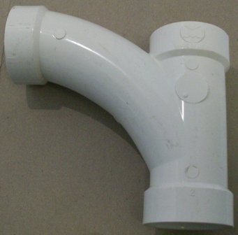

My home was built in 1987. Since moving in the toilets have backed up many times. Not within the toilet itself, but I am pretty sure the toilet paper and waste is becoming lodged at the many sanitary tees used. Below is a typical connection where my hall bath toilet joins the main drain line. The waste from the 1/2 bath toilet upstream travels down to this connection. Just looking at it I could see how waste and paper could get lodged where these meet.
[IMG]
<script async src="//s.imgur.com/min/embed.js" charset="utf-8"></script>[/IMG]
It would seem you would want a connection more like the Combo below.
I have many connections exactly like the first photo. Here is a basic overview shot of the last half of the main drain line.
[IMG]
Could someone who actually knows how this stuff please help me understand how this should be?

No plumber here, but I know enough to know that the sanitary tee in the first picture isn't allowed to be laid down like that, that calls for a Y fitting .......or combo. The way it is connected it's easy to see that waste from the half bath toilet and sink just drops into the main line with nothing to point it in the right direction so it just sits there. I am sure that is where your clogs are.

Joe is right, the sanitary tees should have never been used. It also looks like the drain down the left wall doesn't have a very good slope (though it may have to do with the photo). It's also odd that the drain makes a huge U around the basement, it seems like it should have just cut across the crawl space.
Are you considering re-piping it all? It might be worth adding a clean-out and snaking for the next time you get a clog to figure out exactly where the clog is occurring.

Thank for your reply. Yes, I am planning on changing out the fittings that are wrong. As far as the layout of the plumbing I have drawn a simplified picture of how it is laid out. The are no Combos anywhere.
[IMG]
Are you saying I would be OK with codes if I replace all those sanitary tees with combos or should I be doing something else?

I would try to reconfigure the pipes so they don't have to go through as many turns. From the half-bath on the right, it needs to make 3 90deg turns. It would be better for the half bath to drop directly into the main run to the septic.
Same with the half bath on the left, why not just drop into the main drain that's right there. The whole round and round isn't helping things - unless the pipe really needs to follow that path.

I understand. The thing on my mind is something I read about having too steep a grade in a drain line can be bad. For me to tap directly in the the line going straight to the septic tank would make a fairly steep grade. Does it matter in a main drain line?
If the drain lines can run at a steeper grade I could do something line this.

I have never had problems with lines pitched more than 1/4" per foot. My main drain line slopes at 4-6" per foot after it exits the house and I've never had a clog or slow drain problem. Also if you consider buildings in a city. They don't maintain 1/4" per foot. Their drain lines must fall whatever is needed to meet the sewer main.

I've heard of code issues with too-steep pitch. Supposedly the water can run faster than the solids. I don't know the truth of this, but I probably wouldn't push it. Doing some research, I haven't been able to find any code reference, but some plumbers do report more clogs on longer steeper runs.
That said, there's no reason you couldn't do a standard 1/4"-1/2" pitch, then 90 elbow straight down into a combo into the main drain. It's how many drains tie into a main usually.
I think with a standard 10-20' run, it doesn't much matter.

"That said, there's no reason you couldn't do a standard 1/4"-1/2" pitch, then 90 elbow straight down into a combo into the main drain. It's how many drains tie into a main usually."
Yes. After thinking about it further I came up with the same thing.
At the beginning of this I was just thinking of replacing the fittings with long sweep combos, but your idea of simplifying the system makes total sense and not with too much additional work. I guess my lack of plumbing knowledge never allowed me to consider this in the first place. Thank you.

I have a question with regard to changes in direction. Combo vs. 2 - 1/8. I was looking at the need for cleanouts and saw the pic below and it made me wonder which was better for flow; a single combo fitting or 2 - 1/8 bends as shown.
[IMG]
I just want the crap (sorry) to flow. Do you guys have any opinion on which is better?

I use both interchangeably so it usually comes down to which I have on hand. If I'm buying the fittings I'll usually pick a sweep 90 or two 1/8 bends as there's less work involved with installing the sweep 90 but because of so many more joints in the two 1/8 bends it has a lot more adjustability if your having trouble to get things to line up.
And, I'm a big fan of clean outs. I install them anywhere I think they might be helpful in the future. I'd much rather snake out a drain in a dirty crawl space than remove a toilet and deal with a poo covered drain auger in the finished part of the house.

Hey guys, thanks for the replies. Based on what you have provided I will put in a clean just prior to a "sweep 90". I assume this means a long sweep 90 elbow.
A question regarding long sweep 90s. When looking at them at home depot I expected to see a very large sweep 90 degree elbow. What I found them calling long sweep looked remarkably like the standard 90. So much so that I had to check the box part number to the part to be sure.
Should the long sweep 90 be significantly different looking?

Yes, a sweep looks very different than a standard 90. To me a standard 90 looks like a fitting while a sweep looks like someone bent a piece of pipe.

I went by HD and laid the standard 90 side-by-side with the long sweep. See below. They do look different.
[IMG]
I guess what confused me was I was expecting a much wider sweep like the combination wye.
I wish I could lay one side-by-side with a long sweep 90. The sweep on the combo fitting is much larger.
