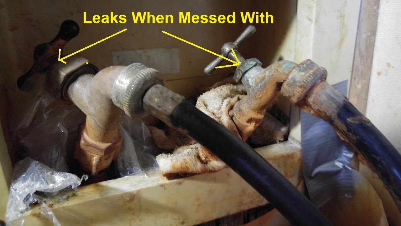

Ok. So, these brass valves began leaking several years ago and for whatever reason they were never replaced. Sometimes they'll leak, other times they don't. The problem is, I'm worried about breaking something when I go to unscrew them because they haven't been replaced since my mom got this mobile home about 30 years ago. Is there a way to make it unscrew without breaking anything?
Sometimes all it takes is to tighten the packing nut on the valve stem.

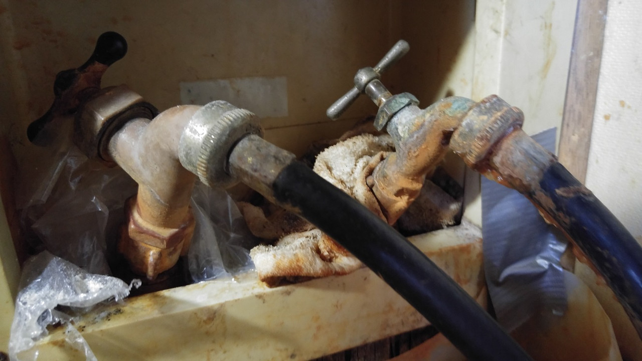

Here is a picture of the old valves. I am going to clean up the wall box, replace the valves, and replace the hoses. Can you tell from this pic if they screw off or are soldered on there? I can't take anymore pics because my smartphone camera died on me.
Very strange. That is a metal valve connected to what looks like possibly PEX or some type of flexible line. The valve will unscrew off that fitting I'm just not sure what that fitting is. It looks like it's plastic.

Where is it leaking? Are the shut offs leaking or is it a constant leak into the washer? Also, it the shut offs are leaking, point to where the leak is so we can better guide you.

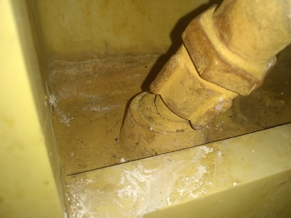

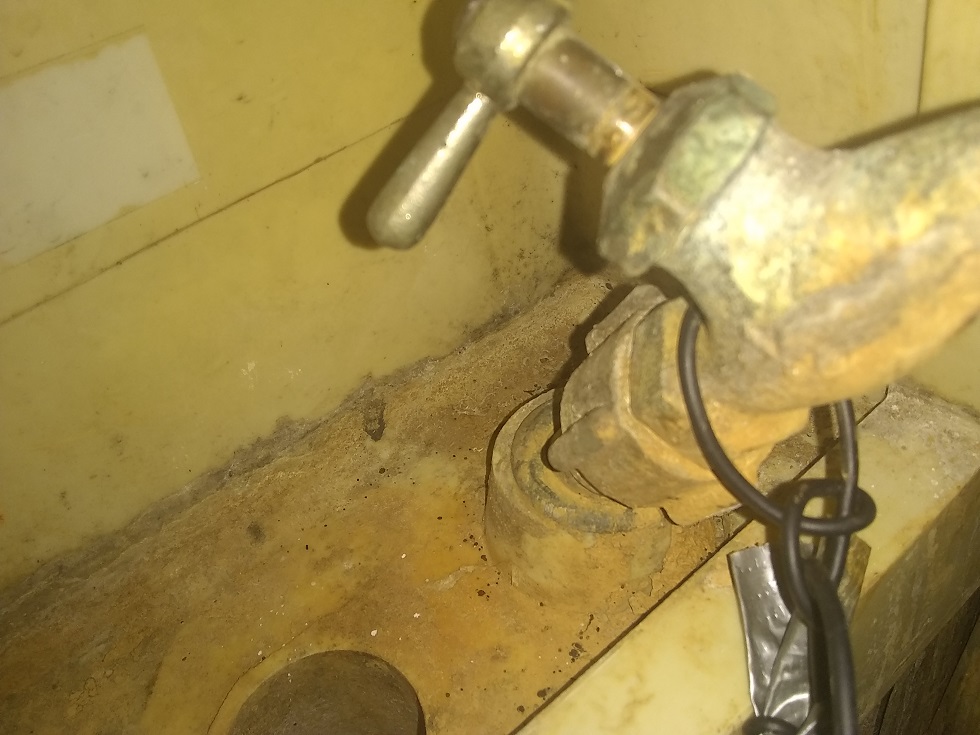

They start leaking when I mess with the shutoff valve or sometimes when the washing machine is getting water. When it starts leaking, I have to play around with the shutoff valve to make it stop. Sometimes it will leak for a while then stop. Since they're not leaking now, I won't bother them because I might catch hell trying to get it to stop. And here are closer pics of the valves I took with my niece's phone. Looking at these pics, can you tell me if the valves screw onto the pipe or does the pipe screw onto the valves?
Yeah. I tried that before. It did tighten a little bit. I'm just scared of breaking something but I suppose I can tighten it a bit more.
Yeah. Those are the threads. Now I know what kind of shut-off valves to get. Those and the hoses. One last question. I noticed the two shut-off valves are different sizes. Is the hot water valve the smaller of the two?
