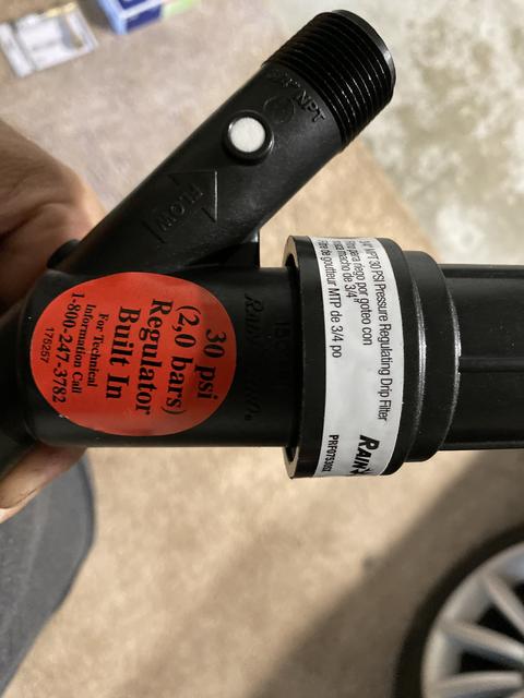

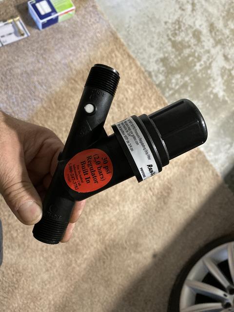

I was thinking to add 3/4 sprinkler water valves , then some how i came home with
1" sprinkler water valves! I was going to downgrade from 1" pipe to 3/4 then to add 3/4 sprinkler water valves , maybe this way pressure will be less at the Zone 1 and 2.
I asked homedepot about it, and they told me to add at zone 1,2 a water regulator 30 psi like this one:
but do i need to add that before the sprinkler water valves or after?
Also others mention to adjust the water pressure here :
and see if i still have the hammering (of course i may have to replace the valves with new ones. The ones at zone 1,2 looks kind old, and not sure how to turn psi down or if can be done)

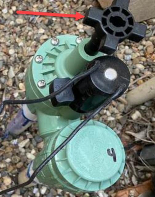

Hi, Wow a lot of info here. So here's my two bits. Shut the water off, take apart the valve clean and inspect it pay close attention to the diaphragm. If it looks good put it back together and give it a try.

So i took the two Lawn Genie 1" sprinkler water valves apart, at first i took the right side to see if water will raise up then you know u have a bad valve, all good there. Then i open the left side where the main flow pipe comes in and both valves looks clean and like new. So i guess the valves are ok.
I did try to open kind manual the valves and still does the water hammering , is kind if you open zone 1 and let it run for 30-sec a minute and then shut it off and switch to zone 2 it does it also , but going back in forward it is kind not doing so loud, this is telling me that maybe there is a water back flow because there is no "check valve" installed on the sprinkler main pipe that's coming from the main house water valve.
So i have to dig and install a check valve first and maybe will also install a "T" with a 3/4 tread and cap it, so if the check valve will not work to be able to add a "water hammer arrestor" .
