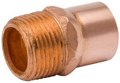

I've lived in this this house for 15 years, several years ago I replaced this spout with one from the store, it was a simple buy and replace procedure at the time. I recall it just screwed right on. However, now the diverter is starting to give problems and I want to replace this tub spout again, but this attachment seems to have been welded on by the contractor when the house was built. I've been to Home Depot and the local hardware store and none seem to be any kind of simple screw on replacement as all of the new one's I'm finding are of a smaller diameter fitting. Any advice like what brand or type I need to be looking for? I apologize because I hate plumbing and pipe work, I'm much more comfortable dealing with electrical.

That is a slip on spout. If you can't find the same exact spout you might also have to replace the mounting adapter on the pipe. Usually though I convert them to a threaded type by sweating a male threaded adapter onto the pipe.

That's a new one for me. Every one that I have ever has is the type that screw on using the adaptor that PD is showing.
I've seen others that have an o-ring that fits over just a piece of pipe.
You appear to have one that screws onto some type of adaptor, bet that is a flat sealing washer on the end!

Click on the link. Go down a little ways to "Tub Spouts with Brass Adapters - Threaded or Slip-on."
Tube spout repair
Looks like you should be able to replace the spout with the existing brass adapter.
If it leaks it may need a new o ring.
