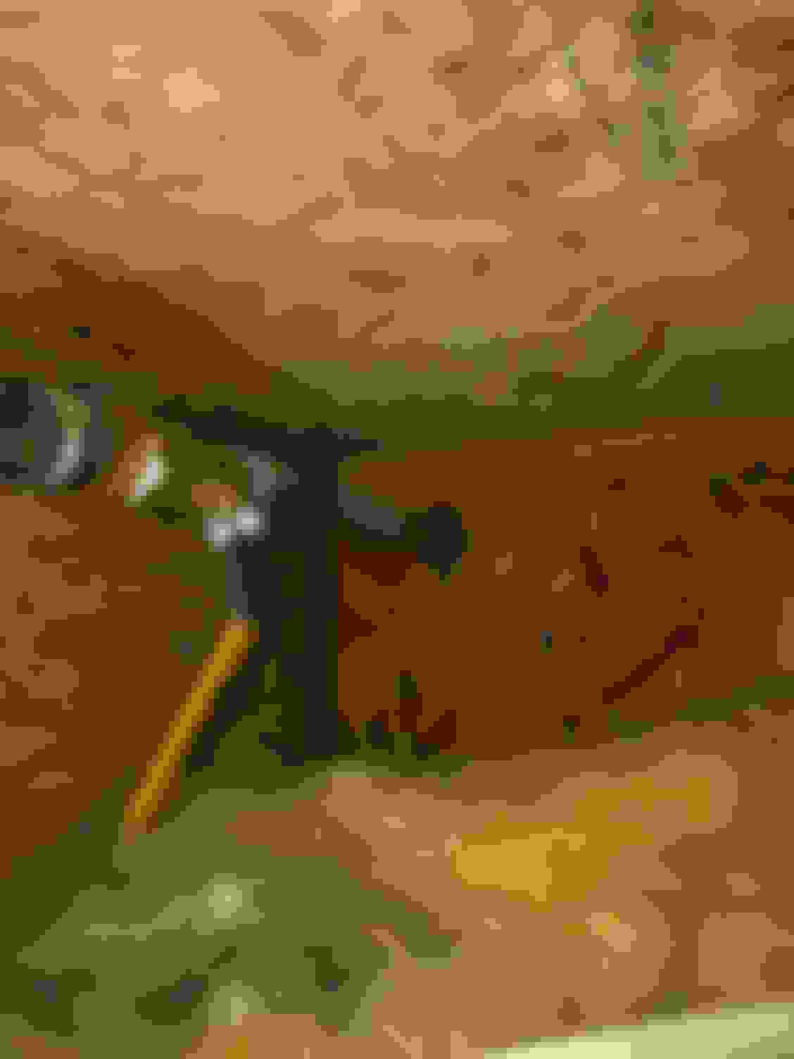

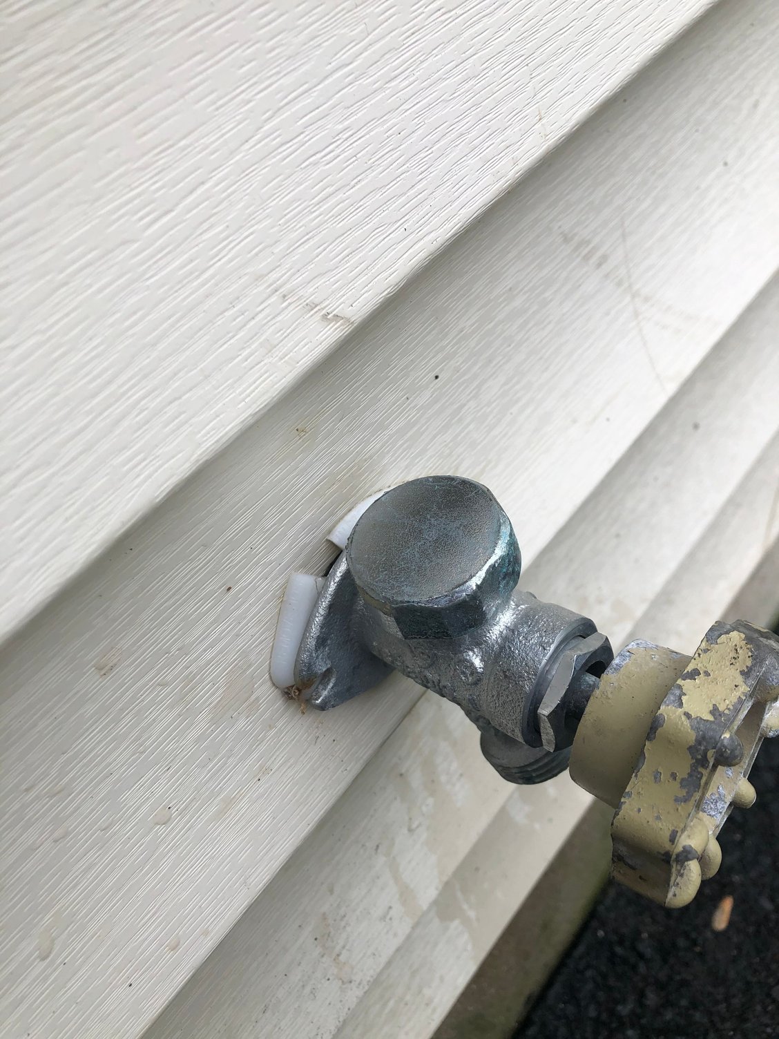

I have a leaking exterior hose faucet that spews water when turned on. I don't have many options given the current quarantine and I didn't notice a matching faucet at Home Depot. Do I need to match it exactly? I've attached pictures for reference.

The length of the frost free spigot and the type of pipe it hooks up to inside are the most important things you need to know.
Dont match it exactly... that one leaks. LOL

Do I remove it from outside or inside the home?

Disconnect it inside... assuming you have access to it... Then remove it outside.

Where is the water spraying from? If it's coming from the vacuum breaker you can repair that. They sell kits with the required parts.
This photo and part number are just an example. I don't know if this is the vacuum breaker for your faucet.

Good point, Pilot Dane. Hard for me to tell in the photo where it's leaking.

Water is leaking from the under the cap.

Are the kits universal? I checked the basement and found the pipe. It has a shutoff valve and then it's a single pipe to the outside. Do I need to remove that and match up the diameter/thread? Or do I just kill the water and remove the cap/etc. as shown above?

You have two options. Shut off the valve and replace the entire frost free spigot, or shut off the valve and remove the cap and look for a replacement. Can't say the kits are all universal. If you want to replace the breaker kit I would take it apart and take it to the store.

108-903 is the exact one I need to replace. Thanks!

https://www.homedepot.com/p/Vacuum-B...-183/100157182 is available at my local home depot but doesn't include the piston and it's black gasket. I need all 3 parts, right?

I think HD just has a incomplete pic....this is the same thing via Amazon
