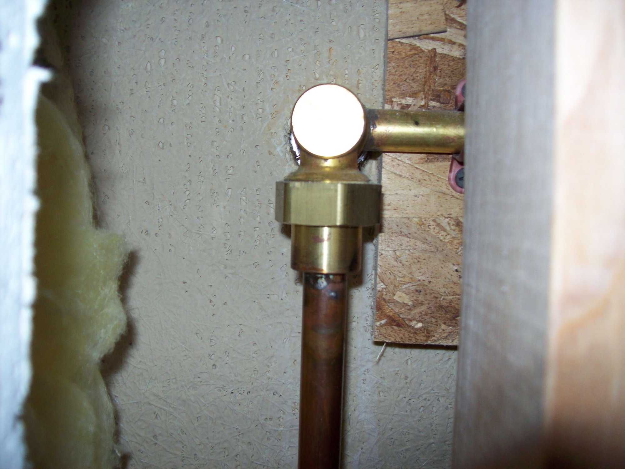

I am curious.
In this drain pipe in the basement crawl space there is a tiny nipple, just below the band of red tape. It is not dripping but it looks to be clogged.
Would anyone have any insight as to what that nipple is for?
The house was built ca 1930. The drain pipes are all cast iron. The section in question just came down vertically through the walls above and turns (nearly) horizontal to get to the trunk line going out to a septic tank.

Wow.... that's interesting. What could that possibly be for ?
Is that threaded into the pipe ?
It would almost appear to be some type of drain but it would surely clog in that location.

One could surmise that the tape once held a small hose that was connected to that tiny pipe nipple... must have been some sort of condensate line perhaps... maybe from an appliance that is long gone. Look for more red tape or abandoned small tubing in the vicinity. Strange place to locate it though.

That pipe is so corroded that my guess is that is that it leaked at that spot and that's a makeshift plug, not a nipple.

My guess was along the lines of RocketJSquirrel. I assume it would be more of a plug even if it looks like it should be open.

I'm used to seeing pared down dowels hammered in as plugs.
