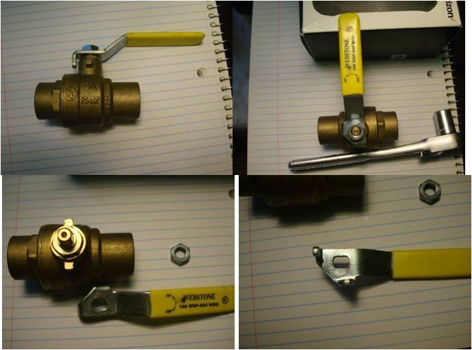

Maybe the people at WebStone misunderstood – or maybe I do. Here are pictures of one of my valves with the handle connected and then removed. You can also see the handle in the 90 position (fully closed) as other have shown with pictures.
I removed that nut holding my handle with 1/2 socket. Worst comes to worst you could always buy another valve just for the handle. If you put PB Blaster all over that rusty nut you might be able to get that handle off.
As others have stated just because the handle is all rusty doesn’t mean the valve is locked up.
(I don’t know what you mean by the handle hits the cement. It only has to rotate 90 as others have pointed out.)

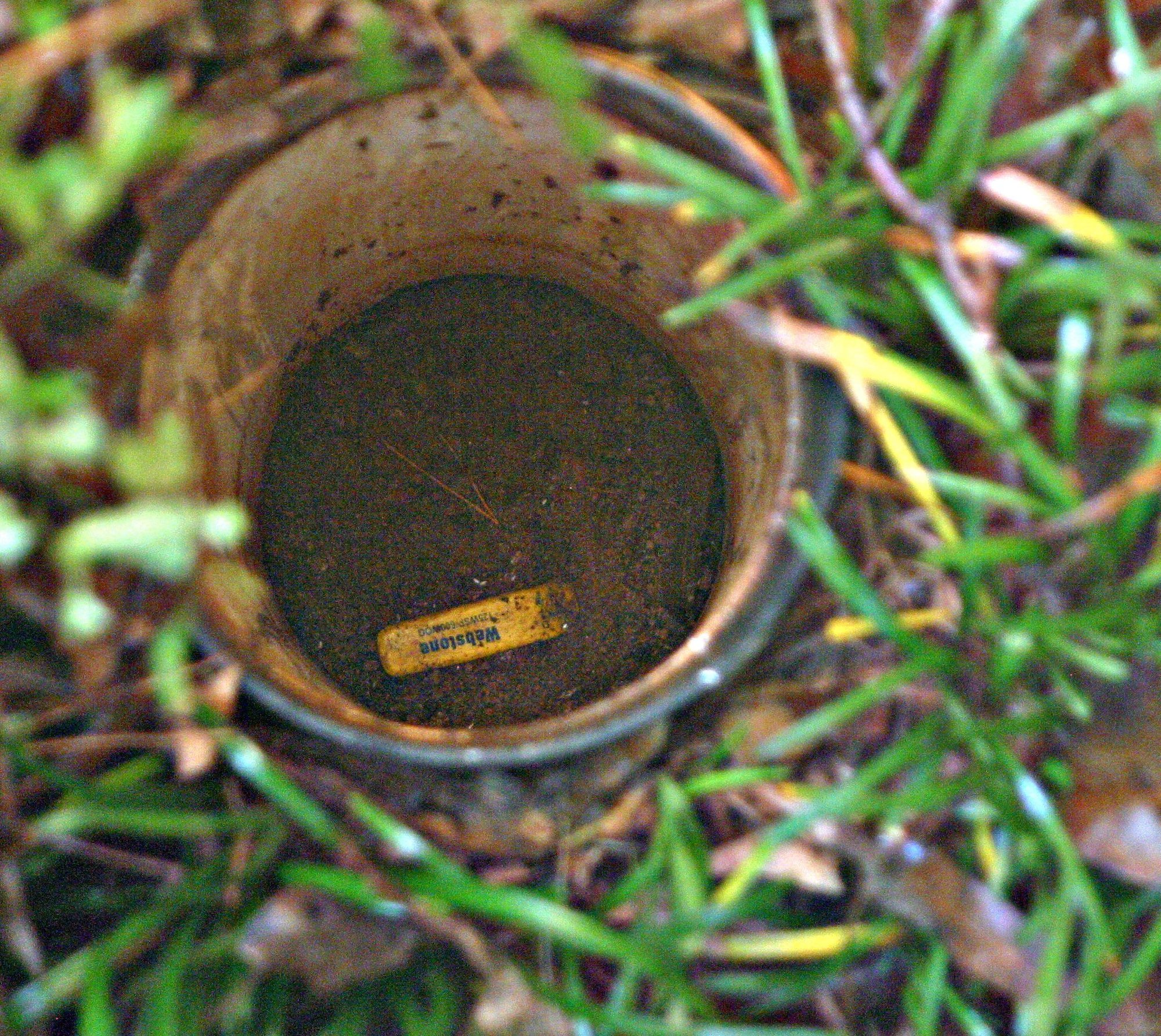

The valve is brass but the handle is steel. May just be a rusted out handle.
What was done was when the water line ditch was covered they put that access pipe over the valve and backfilled. Now you'd need to dig around that pipe to get it out of the ground to work on the valve.
I wouldn't consider replacing that valve a DIY job.
I wouldn't recommend even trying to turn it off. If it broke it would need immediate replacement.
Try removing more dirt from around the valve to assess its condition.

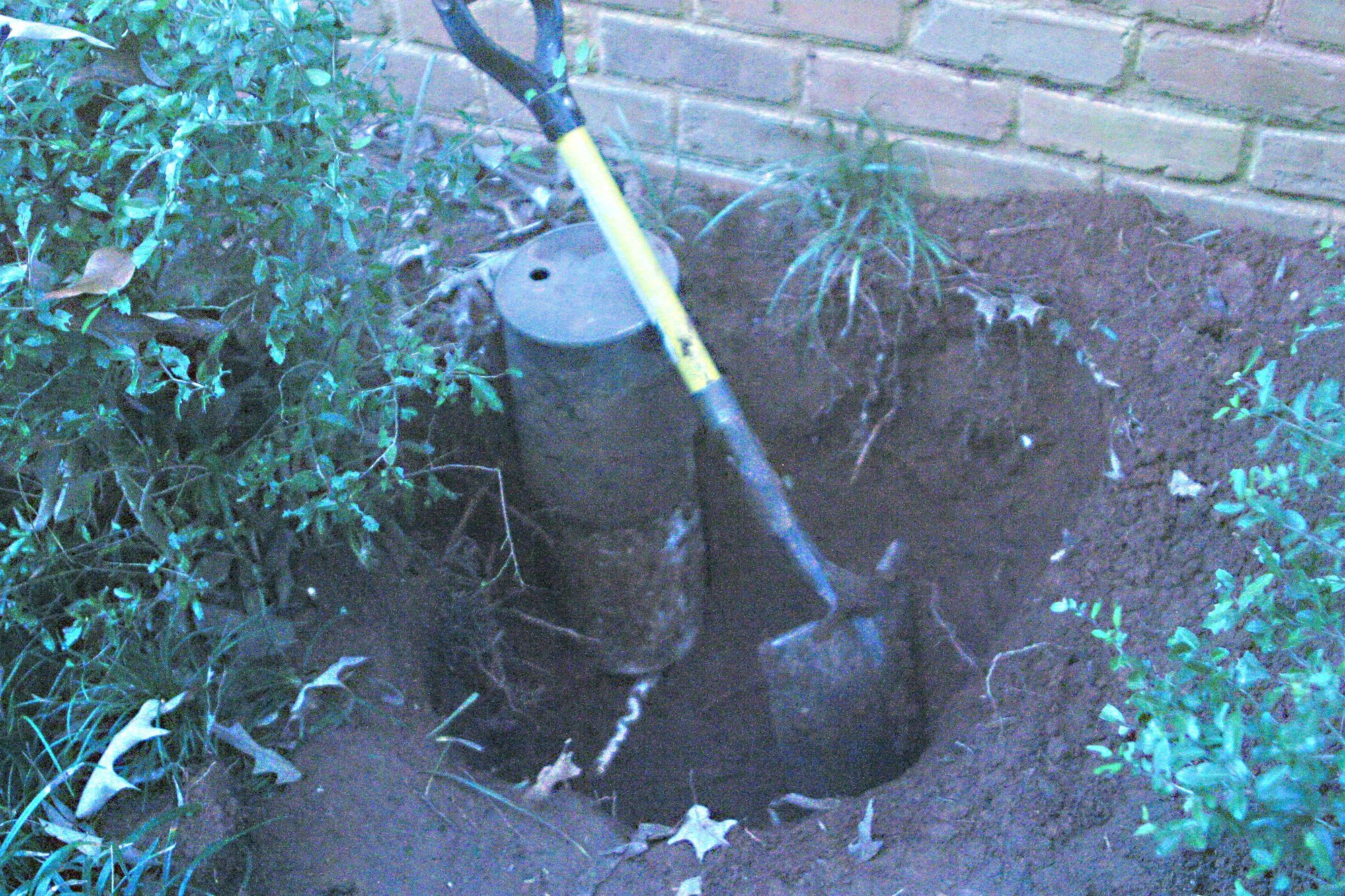

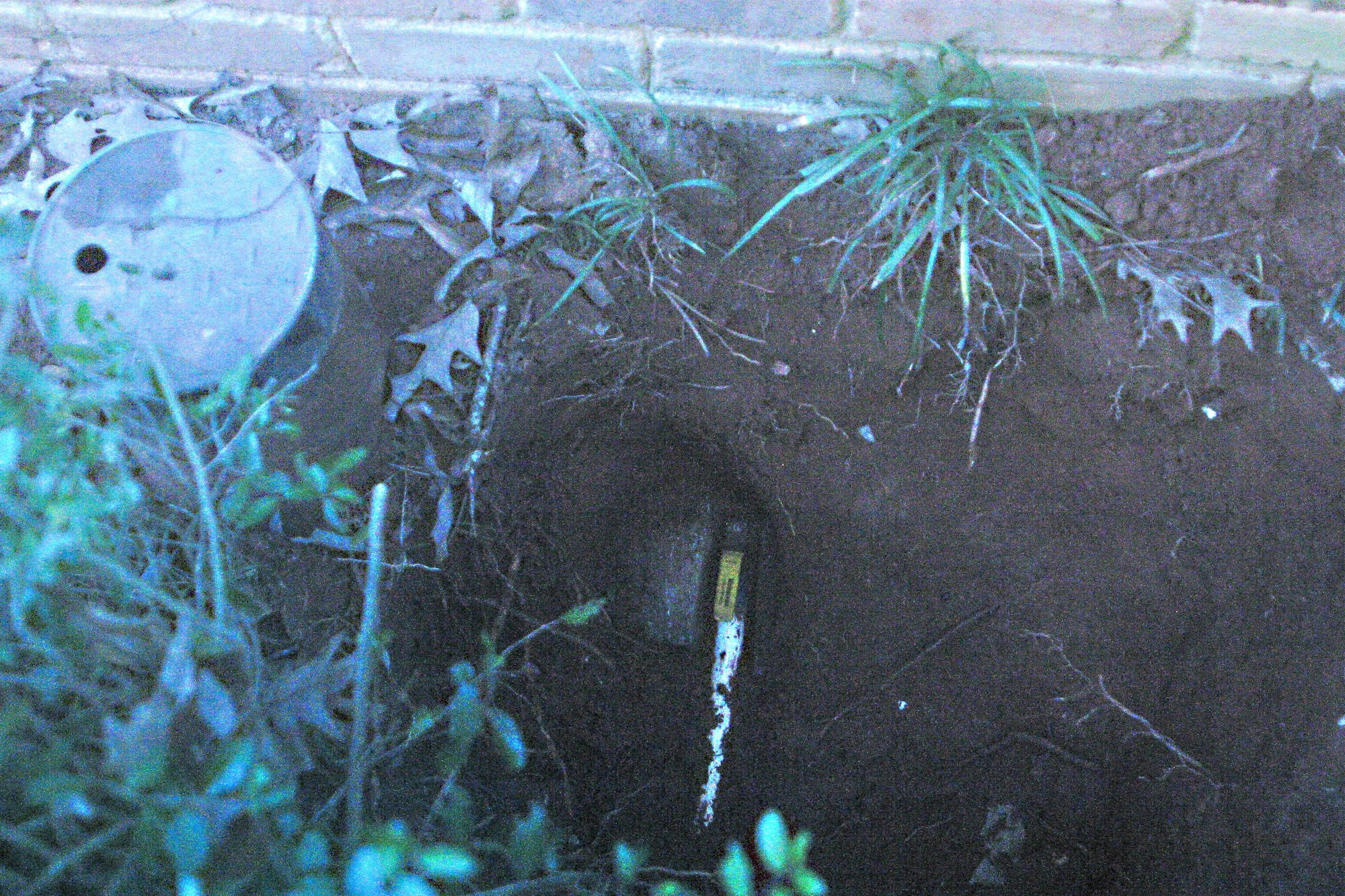

Cleaned out the dirt and got a better look. It appears to be pvc coming from the street side of the supply line into the valve, and then copper pipe out the other side of the valve into the house. The cement is on either side of the pipe, pretty snug but not touching, and just dirt below the pipe. Was surprised to see the white pvc, the house was built in 1962..........Still hard to see the valve itself.....will probably have to dig a hole around the pipe,and pull the enclosure out, to get a good view.......

They put the water line in cement..... on either side of the valve.
That's not going to make servicing too easy.

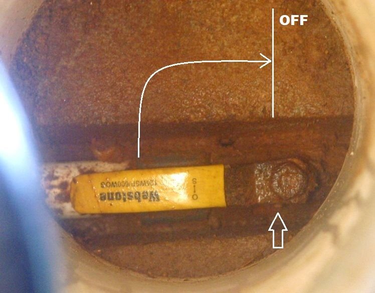

Better Pics of Valve
Here's a better pic of the valve. Looks rusty, PVC is to the left and it transitions into copper on right. Going to call the valve maker on Monday to see if the valve can be repaired in place, or if it needs to come out. The flat area is cement.....I didn't try to turn the valve handle, but it looks like it will hit the cement after a quarter turn.

Looks like a stop where I put the arrow. That means the valve is off in the direction shown.
It really doesn't make a difference if the valve can be rebuilt.... you still need the city to turn the water off and your working in a tight area.

The stop shown is the "full on" stop, turn the handle up 90 degrees and you will hit the "full off" stop.
The valve and ball are made of brass, this should prevent seizure of the valve. The handle and nut are made of metal, so that is what you are seeing as being rusted and corroded. See attached spec sheet.
If the handle were to hit the cement, you could bend it up some to prevent this. The cement is kind of a good idea, acts as a backer wrench for turning valve on and off.
Use a wire brush, clean up nut on top of valve. Shut off water at main, just to be safe. Use a six side socket, extension and ratchet. Place socket properly on the nut and see if you can get ball to rotate in valve. May take a littler force, but not to much. You will be able to tell.
Once broke free, use handle to move back and forth several times. Get a fill for it. Once working. You will need to remember to come out and give a turn every once in awhile.

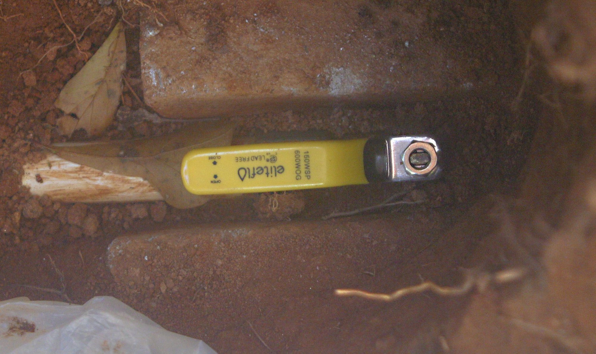

Received 1 Vote on 1 Post
Update. Received the valve that was supposed to be a webstone, but turns out it is an Eliteflo, that looks almost identical to the webstone, but is made in China. The plumbing supply place invoiced for the Webstone model but sent the Eliteflo..the Eliteflo hasn't proprietary threads.....so the webstone valve may not be available anymore....that appears to be the case. Dug a hole to get a better look at the situation and to try to ratchet the nut off the valve......the nut is too rounded and chunks of rust came right off......Tried gripping the nut with pliers, etc.....not going to happen. So will probably call a plumber Monday...the hole is dug so that should make the job easier. The valve is only about a foot from the brick wall....the pipe is 3/4" on the copper side.....I think, if I could get the nut off, the handle and nut from the Eliteflo may fit right on, but don't see how that nut can come off without possibly damaging the pvc or the valve stem.

Oscillating Multi Tool removes rusty nut
Went to Harbor Freight got a $20.00 multi tool oscillating saw and very carefully cut the nut off the stem, from the top. The saw only has one speed - high speed - so it wasn't the smoothest operation, but managed to get the nut off without damaging the threads on the brass stem - took about two minutes. The brass stem has the same threads (I believe M8 x1.25) as the elite-flo valve so the nut off that valve fit fine on the webstone - so nothing proprietary about that, contrary to what the Webstone tech suggested.
The valve turns the water on and off without any problem, very easy and smooth, from the first time it was turned.....pretty impressive for not having been used in at least fifteen years.
The bad news is, the handle on the webstone valve is stuck on the stem, must be rusted on....trying wd 40 for now, but will try the other product (PB Blaster) suggested below - or something similar.....The original handle is weakened but may last a few more years.....The handle should just slide off, but it's fused somehow to the brass valve body/stem.......Afraid to try the oscillating tool on the handle, as there is nothing between the valve body and the handle so i may damage the valve body......the handle acted as a barrier between the valve body and the nut, when I sawed off the nut......

Final Resolution
Couldn't gt the handle off with WD-40 or any other solvent....Had a plumber working on another issue today, asked him to take a look at the rusted on valve handle.....he said he might be able to get the handle off with a tool he had....so he gets a tool made for getting stuck handles off of valves ....it grips the edges of the handle and has a screw in the middle which tightens down on the stem....took about 15 seconds and the rusted handle came off. The replacement handle fit right on....so the ball valve is good for another 20 years. Pics below: new handle on top and rusted handle below.
