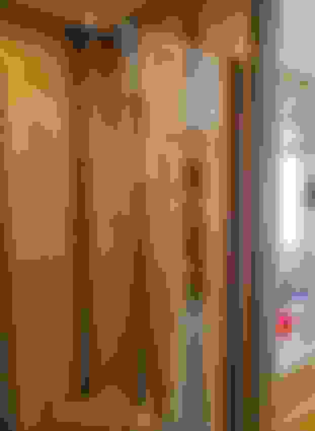

I am considering adding a showerhead to a tiled shower in a home we recently moved into. I am hoping people can comment on my thought. My goal is to keep it as simple as possible but also not create a bunch of unnecessary holes that I have to patch. A few questions in addition to the above.
1. If this works will i get good pressure utilizing the sink pipes as the source? Would i have to T off before the lines to the sink or could i leave all that alone and add the water connections after the shutoffs?
2. Do you think that I could have the pipes go behind the medicine cabinet as that would be ideal?
3. What is going to be the easiest way to cut the tile and minimize it breaking to add the valve? Can I do this from the shower side or do i have to do it from behind?
Above is the attic and the back wall of the shower is an outside wall so I can't put piping in either location.
Below are some pictures and further detail of what I am considering.
Thanks for the help.
I would like to have these go behind the cabinet if possible. Otherwise I would try and run them along the side like shown below
Showerhead location. I would also try and place the valve i think below the medicine Cabinet
I want good pressure. If i T off the water lines to the sink and run them behind the drawers and then up what do people think? If this would work would the T be best place before the shutoff? Not sure if the shutoff restricts flow.

1. What pressure you get depends on how your house is plumbed. If the entire bathroom is fed by 1/2" lines then that's going to be a limit but if 3/4" pipes feed the bathroom where it's dropped to 1/2" for each fixture then you might get good flow.
2. No, you will have to remove the medicine cabinet as it's occupying the stud cavity where the faucet body and piping would go.
3. You can drill and grind tile with carbide and diamond bits. Ceramic can be worked relatively easy while porcelain tile is more difficult. As for breakage... there are never any guarantees.

I would definitely tee off before the shutoffs. The shutoffs are 3/8" while the pipes are 1/2" - which is about double the area/volume. I would add a pair of 1/2" ball valves to as a separate shutoff for the shower in that same cabinet.
Unfortunately it's hard to say what kind of pressure/volume you'd get. One very unscientific way would be to turn on a second shower in the house and that one too and see what happens. Or an outside hose faucet on full. If you don't see much pressure drop, you'll at least know the main/house can support it.
For cutting the tile, I'd use a rotary tool with a diamond or carbide bit. In a pinch, and angle grinder with a tile cutting blade could work, but would be more of a octagonal hole rather than round.
