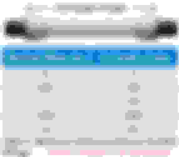

This is 3/4 pex-a . Found this chart that says there should be a minimum gap between connections??
look at these connections i have there not ure usual!?
I wanna put a 3/4 tee with 1/4 shut-off on the white pipe that the builder accidentally painted.....im trying to attach a pic but its too large and this site blocks image hosting argh
Even this site mentions a minimum gap between connections
https://www.plumbermag.com/how-to-articles/pex-plumbing-fittings-commercial/the-contractors-checklist-for-installing-commercial-pex-systems
