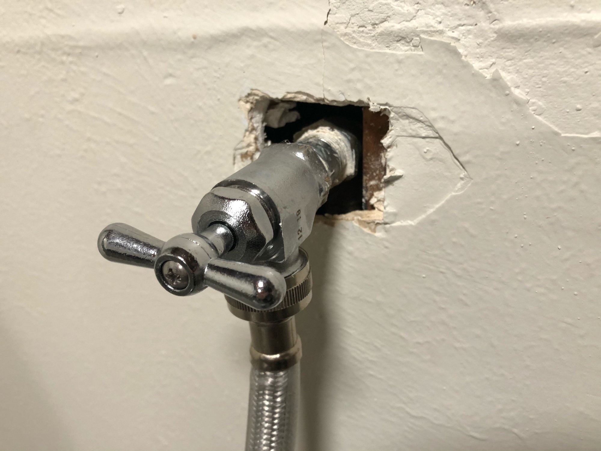

I am in the process of fixing up an old house I bought and have run into a minor issue with some old pipes in the laundry room. The old laundry hook ups were leaking so I am replacing them with new valves at the moment. When removing one of the valves I noticed that corrosion has caused the pipe threads to fuse with the main water pipe -- pictured here:
I've tried a few tools to remove the small portion of the thread that is fused with the pipe, but nothing is working. I have yet to try a pipe nipple extractor tool but am thinking that might not even do the trick due to the shape the pipe is in (it's in bad shape).
Ideally, I want to make sure the threads are all clear before I insert a new pipe/valve and hook up the new laundry machines. I am worried also that in general these pipes are in really bad shape beyond just the issue highlighted above.
Looking for expert advice on if I should continue to try and extract and clear the corroded portion of the pipe with a nipple extractor and move forward with the small project myself or if this might just need the expert eyes from a plumber or professional.
Any advice is appreciated and I can provide more answers/details as needed here!
Thanks!

That is an awful lot of corrosion in that pipe.
Do you have steel pipe in your house ?
In other words...... is the plumbing not all copper ?
Based on that mess the previous washer valve screen would have to been plugged.
Possibly that's a well system ?
I wouldn't even mess with trying to get the threads out of that elbow.
Solder on a new one.

Thanks for the feedback and comments -- the piping that is visible to me is mostly galvanized steel and the water source is a public water system.
I am worried about the level of corrosion and general quality of the pipes here as I work on the area. Here's an image of the laundry hookups and area when I first started working on them - notice the staining on the walls stemming from the valves.
The valve on the left was more straight forward to fix and less corrosion and build up was present. The current set up looks like this as I build out the laundry room in general (with a snapshot of the valve that was already replaced) -
Overall, I am just having some reservations about the valve and pipe on the right since it's in considerably worse shape. I am considering consulting a plumber to get a better eye on the overall situation.

Are you sure your pipes are steel? In post #1 picture 2 that just looks like a copper female elbow and somebody used a steel pipe nipple to connect a female valve to the elbow. I’ve done that already and the nipple corroded after a while, since I have very acidic well water. The copper won't corrode like that. Maybe you just have some corroded pipe nipples and other piping is OK.
But you don’t have to use steel pipe nipples. If you get brass male valves they can screw right into the female copper elbow. Like these for example:
https://www.amazon.com/American-Valv...052EDY52&psc=1

Anyway thought you might be interested in a pic of a steel nipple I used and how it corroded. You can see the buildup inside. My understanding is that usually the steel pipes corrode from the inside. I don't even think I had that nipple installed for that many years. But my water is very acidic. You can see how the water flow would be obstructed in that pipe. I make sure I don't use steel pipe anywhere.

I think you are correct! I dug up the older valve that was already replaced and the buildup/corrosion looks identical.
I'll have to rethink the approach and make sure to limit the use of steel and ID where it's currently being used..
