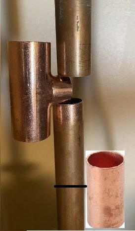

I am adding a water line for my new humidifier, and my plan is to tap the 3/4" hot from the water heater. I've been practicing my joints, and I feel comfortable enough to do it. I'm having a bit of trouble in that I expected more flex with the 3/4" line. I cut out a section about 3/4" to accommodate the tee. I'm able to move the pipe about an additional 1/4" comfortably. I'm not quite sure how much space I would need to insert the tee but I know I don't have enough space at the moment. I checked in the ceiling and this pipe goes to a 90 elbow. I'm not sure what is considered too much pressure, and if I can safely force it a bit more. My last resort plan is to use a Sharkbite slip joint fitting and get a plumber in to make a permanent connection. I'd like to avoid that if possible, but it's an option. Also, I am about 8" from the drywall. Is this a safe distance or should I get one of the fireproof mats to put back there? I've enclosed a picture so you can see.
By the way, I haven't cleaned or deburred anything yet. I will definitely do that before soldering.

You are kind of going about it wrong. When you are inserting a fitting or section of pipe between 2 immovable objects, you need to cut out a larger section of pipe, (say 6" or so) then use a repair coupling.
A repair coupling does not have a "stop" in the middle of it, so it will fully slide up onto the pipe you cut (6" above). Then you replace your tee (below), and then measure from the tee to the cut end of the pipe above. Then you sweat that pipe into the tee. So your 2 pieces of pipe will be touching, or very close to touching. Then you flux up the pipes and slide the repair coupling
You would clean all the pipe, clean the fitting, flux it up, and then slide the repair coupling down over the seam and solder the 2 pipes together.
8" is PLENTY of room, you don't have to point the torch at the drywall, you will have enough room to put it behind and aim it back toward you.

You might need to use a repair coupling. Here is an example:
https://www.menards.com/main/plumbin...4449318747.htm
The coupling slides over the copper pipe. You can then slide the coupling over a gap and onto the next piece of pipe to close the gap and then solder. In other words, you can cut the piping to fit a tee or whatever, and then use the repair coupling to close the necessary gap you had to make.
If you can’t spread the pipes more than 1/4 inch I think you would have to use the repair coupling. See what others say.
Also, I think 8” is more than enough room to solder. I use cookie sheets or pie plates or whatever, and fasten them or fix them somehow to block any flames from hitting flammable material.
(coupling pictured is 1", you would need 3/4" - and they come in different lengths. I think you can buy a 12" and cut it in pieces as required. Think so. It's been a while since I bought one)

A union could also be used,

That almost looks like a no-stop tee in the picture. Does it slide completely on the 3/4" pipe ?
As mentioned.... you could always use a no-stop coupler in the 3/4" line.
