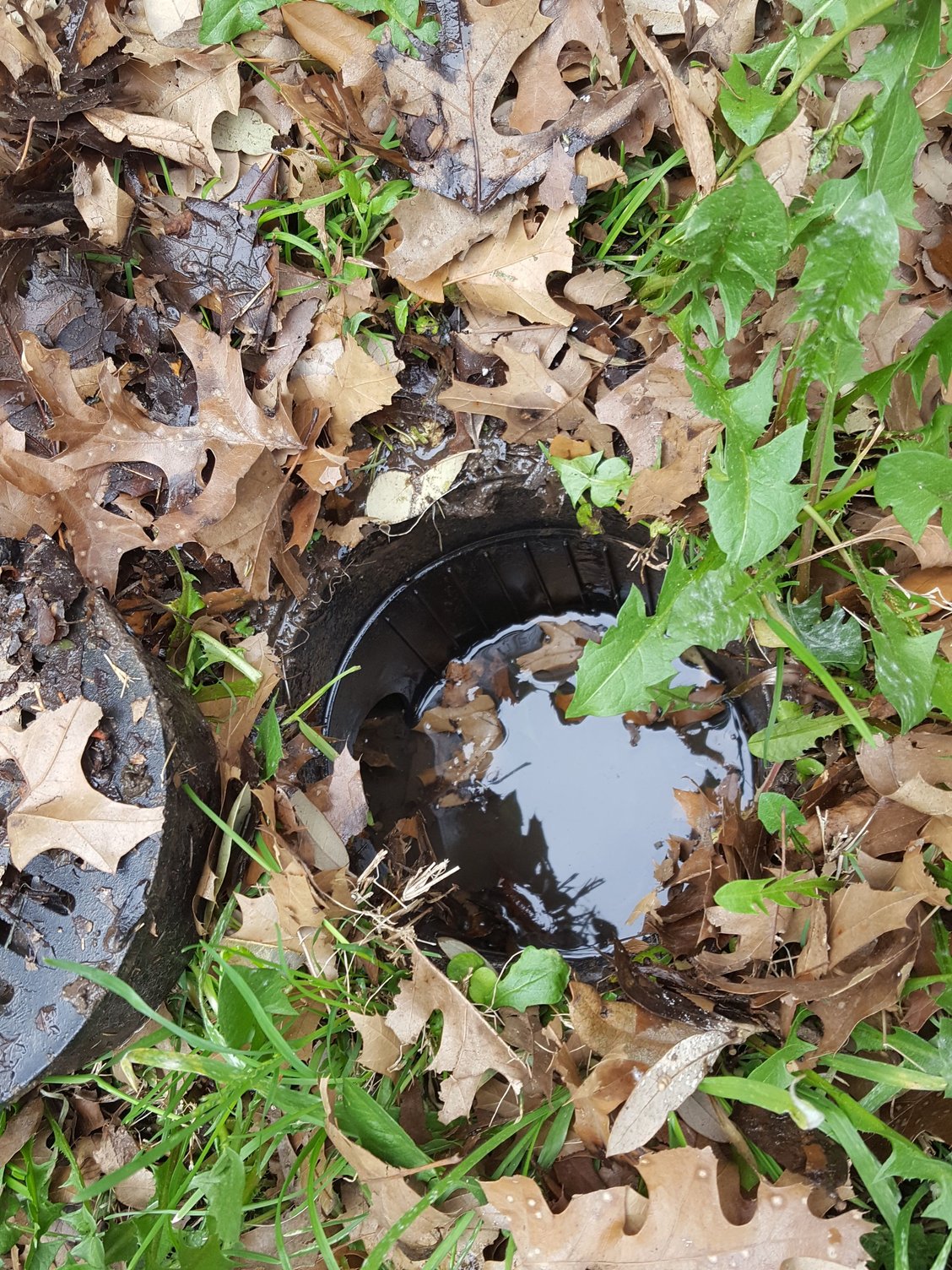

My backyard is directly against two neighbors (one on the side and one on the back). Over the last year, there has been frequent standing water on my side of the fence of my neighbor on the side. I have asked her multiple times if she has a leak in her pool (she says the water level does not drop to indicate one) or if she is over-watering with her sprinklers (she said she has them turned off along that side of her fence). I do not have a sprinkler system, so since this is my backyard (water/sewer are at the front) and the water is along the fence and not near my house, my assumption has always been that it is something coming from her property, which is a little higher than mine. What type of person would I call to figure out the source of the water? It doesn't sound like a 'plumbing problem', so I don't know that paying a plumber makes sense or if they would be able to identify where the water is coming from.

I will try to get some photos, but they are not that interesting: they are puddles. One other thing that I didn't mention: there is a french drain in the back yard that my gutters feed into, but this standing water occurs even after long periods without rain.

Here are some photos

I think you misunderstand. We all know what a puddle of water and leaves look like. What we need to see is your yard. The big picture. We want to see the lay of the land, the fence and anything else in the area that might be the source of the water.

Sorry - photos showing their fence as well as an example of the moisture creeping from that direction.

Where does the French drain go to and dump out?

Part of it does run along the fence. It hasn't rained in over a week, and popping one of the grills shows water, but it isn't flowing or blocked. I have no idea where it dumps out.

If a French drain overflows then it is not working properly or is not constructed properly. It must empty out somewhere.

The french drain does not overflow - I was just saying that the water currently in there is not flowing.

You need to fill in the puddles so the water goes to the French drain inlets.
