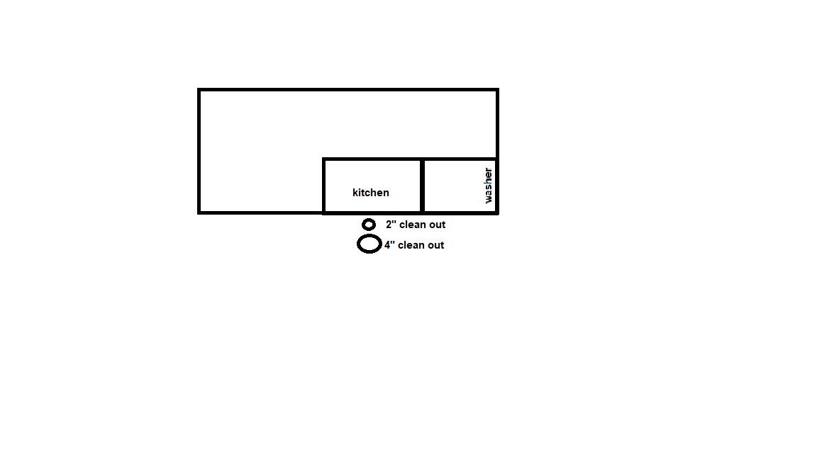

hello all,
I have a problem with my new washer backing up and wasting water on the floor.
A little info about the setup. I moved into this home about 2 years ago and at the time i had a front load washer and had no problems(I assume because it uses less water), that washer stopped working so i bought a new top load washer. now when i wash clothes the water, while draining, backs up and spills over onto the floor. you can hear the pipe fill up with water and then it will overflow then gurgle and then drain some more then repeat the process.
so far i used a snake and snaked the whole line all the way to the septic tank. I removed the two clean out caps that are outside the kitchen window in the ground between the house and septic tank and seen that when i put the snake down the washer drain it came through the 2" clean out so i am assuming the 2" pipe drains into the 4" pipe at some point between the clean outs and the septic tank.
An help would be great.

about half way through the drain cycle is when it starts to back up.
I have read others saying it could be that the top loader uses more water and drains faster.
A sink could be a solution but i would like to stay away from that if possible.
could it be a vent issue?

You showed the 4" clean-out. Where is the main stack in relation to the washer?

I think there is a vent above the kitchen and the washer too. I will have to get in the roof to double check.
what is the best way to make sure they are cleared out?
