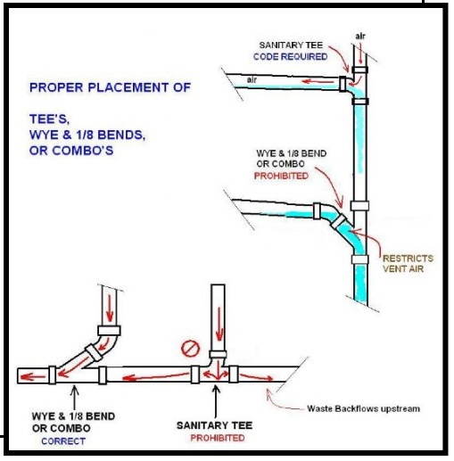

Definitely replace the trap. I wouldn't worry so much about when you notice the leaks. The important part is that you caught the leak and can fix it before you have a bigger mess on the floor.
Just an FYI about tee's and wye's on a vertical drain pipe.
