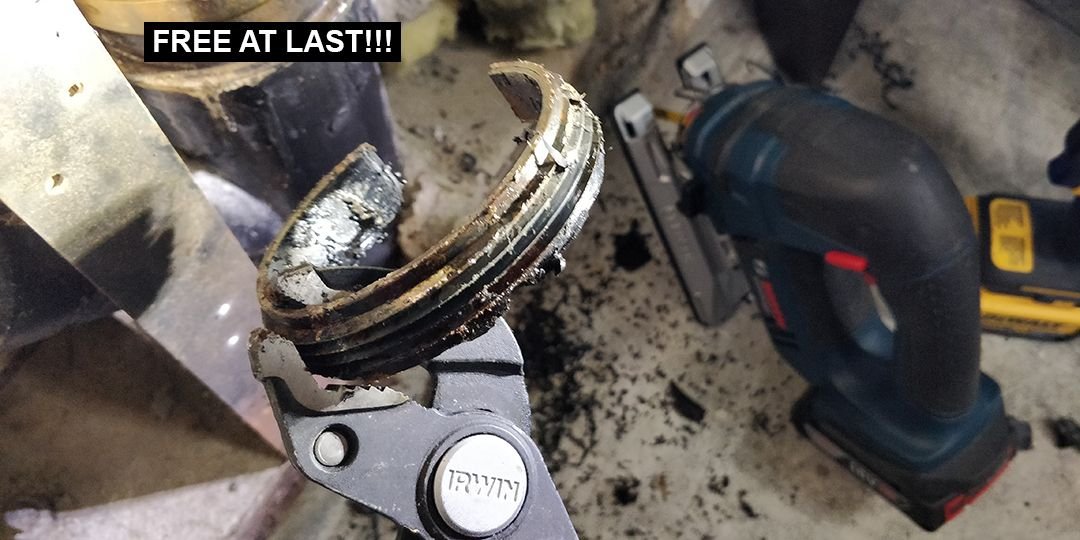

Old 05-10-21, 12:53 PM
A
Join Date: Apr 2014
Posts: 155
Received 4 Upvotes on 4 Posts
Situation resolved...
In case there is a poor soul in the future with a similar predicament, here are some tips.
1. I started drilling the plastic cap with a step bit. Could have used a multi tool, but felt more comfortable holding a drill.
2. Once you get yourself some big holes, you can start pulling away the pieces with a channel lock plier or something.
3. The biggest problem will still remain, the thread from the plastic cap will not be pulled away during this process because it is so stuck and corroded. So you end up with a big hole, but a plastic ring that still hugs the threads of the Tee.
4. So now you need to cut into that ring, once you break the circle, it should come off with a plier. I had to make two cuts, pulled out that section. Then the bigger section was able to be pulled off by a plier. I found that the multi-tool was uncomfortable. So I used a jigsaw, held it upside down in my hand. Grazing the top little by little until I could pull it off. Because you don't want to cut too deep and ruin the Tee's threads. I felt more precision and control with the jigsaw.
5. Once it was freed, I used a wire brush to cleanup as much as possible the Cast Iron threads.
6. I first used THIS BRASS PLUG with a flush square, and I used THIS CLEANOUT WRENCH to tighten. The result was terrible. First, the plug is thin, not a lot of threads. So with this, you want to make sure you can thread it all the way in. But these wrenches are not a perfect fit. Their square heads are slightly smaller than the square slot. So when applying a lot of torque, it just slips off. Secondly, I was trying to screw on brand-new brass threads to old threads. So the wrench had to do so much torque right from the get-go. I could not thread it all the way in, and leaking was still present.
7. I ended up using THIS ABS PLUG with the square protruding. I then used a good olé' plumbers wrench to grip the square. These plugs are much thicker, and I was able to thread it in a little past the halfway point. And instead of teflon tape that I used with the brass-plug, I used Rectorseal pipe dope this time. Lots of it! LOL! No more leaking!
