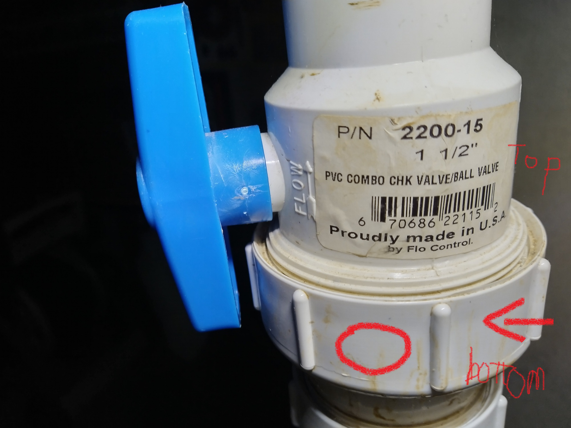

The PVC Combo CHK Valve/Ball Valve seeps water from the thread.
After I unthread the bottom part pointed by the red arrow, I found a round shape object in the middle of the coupling.
It seems to me when I rotate the handle on the top part, it will rotate the bottom rounded object to open/close the pipe.
