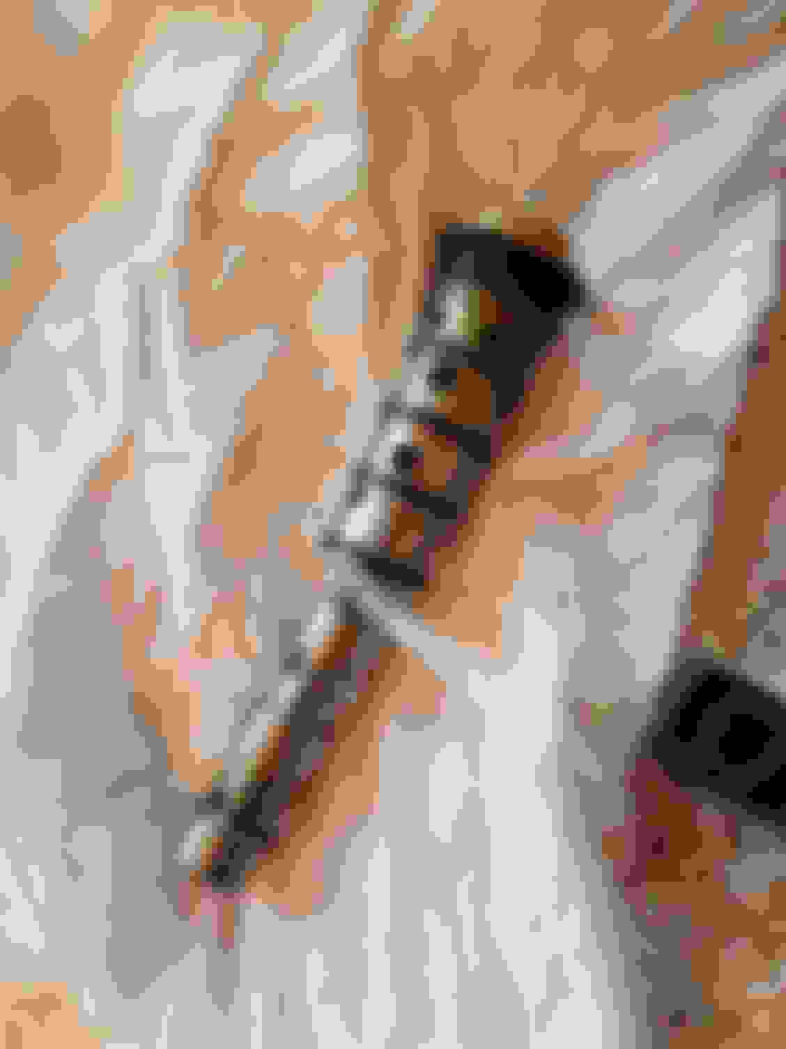

Thanks Pilot Dane.(tak for det).. Working on the issue and did as you suggested below..and it didn't work unfortunately...however I think what that did do was confirm (I believe) that there is no obstruction/blockage in the pipes. With the HW off at the tank and the cold water on at the main, I shut off /tightened down the cold water (right) service screwdriver shutoff on the faucet body..(I know the HW is ok..) and removed this larger flat screw to reveal this 'thing'. I backed off the screwdriver shutoff and water came charging out thru the CW screw shutoff and the hole from the 'thing/regulator'...I'll call it. I removed the inner portion of the regulator, replaced it, backed off the screw shutoff and water came flowing out of both the HW and CW holes in the faucet... So that how I figured that the water flow to the faucet is good but something is out of wack with this 'regular'. When I put its insert back in and reinstalled the regular.. I'm back to the original problem..being hardly any CW pressure. So the problem must lie there...somehow. It seems clean, no crud or buildup but I have it sitting in some vinegar right now as I'm writing this update. Maybe this 'regulator' is supposed to 'float' and move back and forth to regulate the hot and cold water and is not sliding anymore......!?! I don't know...but at least I know that the pipes are not the issue.....Ugh..

PS. I have the Installation Guide for this faucet..Delta 824,828 and that 'thing/regulator' is the Balance Spool Assembly (part #574)... the search continues. It's in vinegar right now..but I don't see anything wrong with it...?? ...

After cleaning the spool assembly I put a film of plumber grease on the piston (inner piece), installed the whole assembly. That didn't do anything. Removed it, cleaned of all the grease etc and re installed it. That too, didn't do anything. No improvement to the water pressure. I removed the whole thing, removed the piston and re installed only the assembly/cylinder. Pressure is good, but no hot/cold...just warm. Not able to increase the Hot or Cold.. Soooo, what now...UGH...!!
Todays update to say that I finally got the fix. Apparently it was the Balance Spool Assembly. I shut down the water and removed the sleeve/cylinder, placed the piston in the cylinder with the holes kind of lining up tho they weren't really even with each other, applied a little grease to the O rings and reinstalled it. I left a CW sink tap opened a bit and turned on the main. Went upstairs and turned on the shower and low and behold...Voila.. Cold water..with pressure..and HW with pressure and able to mix the 2. I'm so excited it works. After process of elimination it had to be the Balance Spool.. Why it didn't work the 1st time I cleaned it....who knows...!?!
