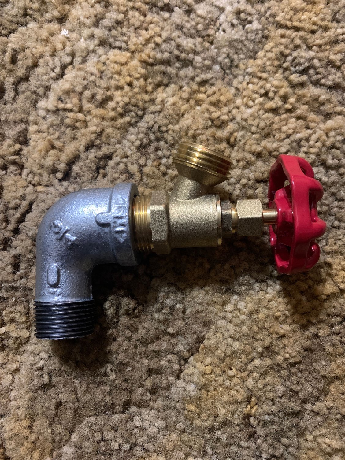

New problem (or at least I think it is): I bought the boiler drain valve and the 3/4” elbow. I was testing it out to make sure it all fit and when I screw the valve into the elbow, the hose connection is in the upward position when it is screwed in all the way.
Any ideas?

You need to put some thread sealant or teflon tape on the threads.
When you tighten..... you tighten to where the valve is pointing in the wanted direction.
Take the valve back out. Put some tape on the threads and screw it back in but stop before it's tight and pointing in the correct direction. It shouldn't leak. If it does.... you'll need to tighten it more to get it to come around a full turn.

How does this look?

Good job. Back in business. ..............
