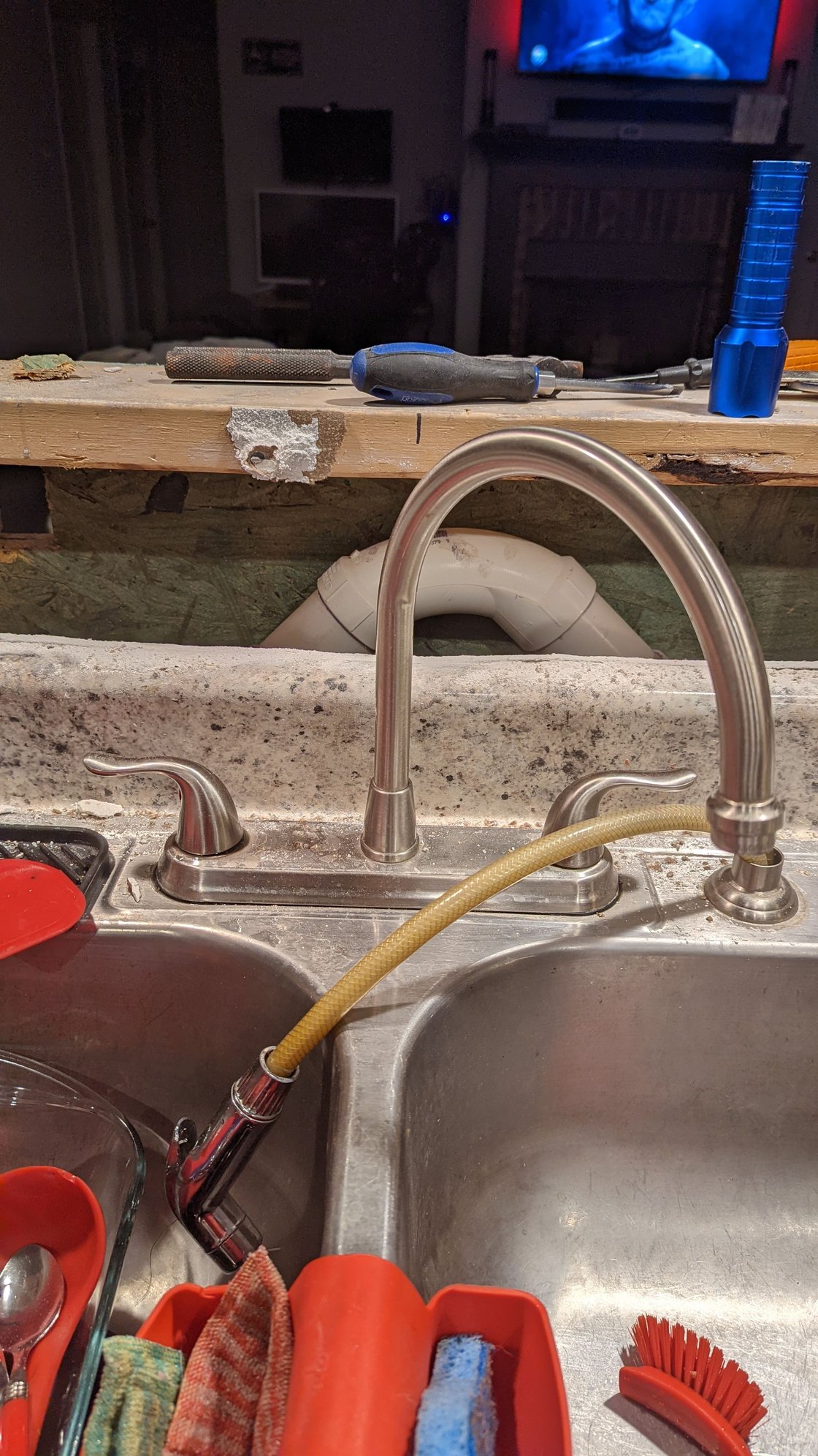

Turning counter with high rise breakfast bar into just an island, I'm no plumber and I believe what I see is the loop vent for the plumbing to my sink. It is a tad to high so I was curious if I could just simply trim these 2 lines down to make the height go right under a new countertop. As I stated I'm no plumber haha just trying to get advice before destroying something. Thank you in advance!
Is there a good way to unglue those fittings? I would hate to not be able to reuse them, cause I simply can't seem to find those specific angled pieces online at all
No. You need to access both pieces of vertical pipe from the opposite side of the wall and cut out a section of that vertical pipe on each side of the loop vent. (You will reuse everything above the cuts you make) However much you need to lower it is roughly what you need to cut out. You need to be able to rejoin that top section of loop vent to your cut pipe with two pvc couplings, purple primer and pvc glue.
You cut the pipe, not the fittings. And since you need to use a coupling, you need to leave at least 1 1/2" of pipe above or below a fitting like a 45 elbow in order to have some pipe to glue to.
In other words, don't cut the loop vent off right at the bottom of an elbow. Cut it at least 1 1/2" below the elbow to leave some pipe sticking out. More is better, in case it needs to be redone in the future.
Totally makes sense now. Will I need to turn off the water for doing this, I would think not cause it's simply air in there correct? Just covering my bases and thank you so much for the help l, truly appreciated. Doing my first big home DIY so trying not to screw it up.
Just an update, started work again 9n it this morning, got the pipes exposed from the backside. Just a question, been working with a saw saw, can I use that to cut the pipes or would that be a bad idea?
In a spot like that with wires and sheet rock close by, I sometimes use one of those cheap wire saws (in the camping dept.) Just takes longer than a power saw. Draw a line around the pipe with a marker so you can keep the cut "square".
A sawzall will work just fine, you just need to be careful and make a very straight cut. Having someone help by holding on to the pipe for you while you cut would be a good idea.
