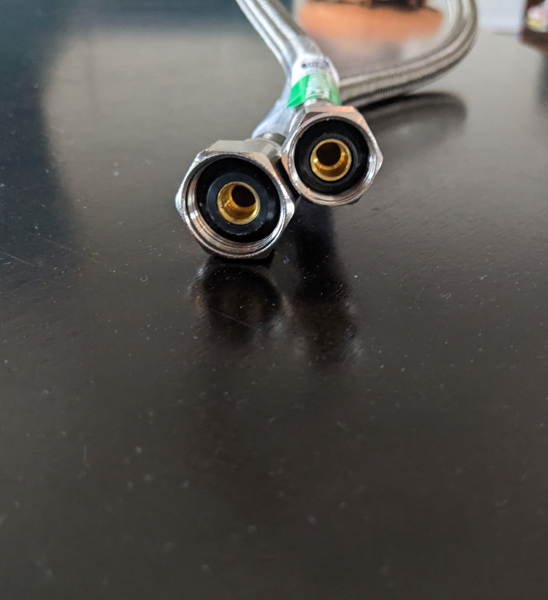

Hello, I purchased this faucet connector hose from Home Depot and I'm trying to figure out what type of adaptor and what size I need.
The description says it is 1/2 in. Compression inlet x 1/2 in Female Iron Pipe outlet, but when you look at the ends, you can see that one end is a little larger than the other. I need an adaptor to make the smaller end the exact same size and type as the larger end (which might actually be 5/16")
You bought a hose that goes from steel pipe to a faucet.
You are connecting a faucet to a valve.
You should need a hose that is 3/8 in. Compression inlet x 3/8 in. Compression inlet.
or possibly 1/2 in. Compression inlet x 3/8 in. Compression inlet.
It would be easier to exchange the hose for the correct one then trying to find an adapter.
@zoesdad - it is for my shower retrofit. Basically my shower valve had a threaded fitting installed on it by the plumber which will then connect to my shower retrofit: https://www.homedepot.com/p/VIGO-Orc...265825#overlay
Seems like then it is just extending a 1/2 pipe, so 1/2 FIP x 1/2 FIP would seem to be correct - if the pipe size is in fact 1/2. So your new choice in post #3 seems right. But I’m not an expert.
Maybe you could try the 1/2 FIP end of the hose you now have (post #1) and make sure it fits on both connections, before you buy the new hose.
