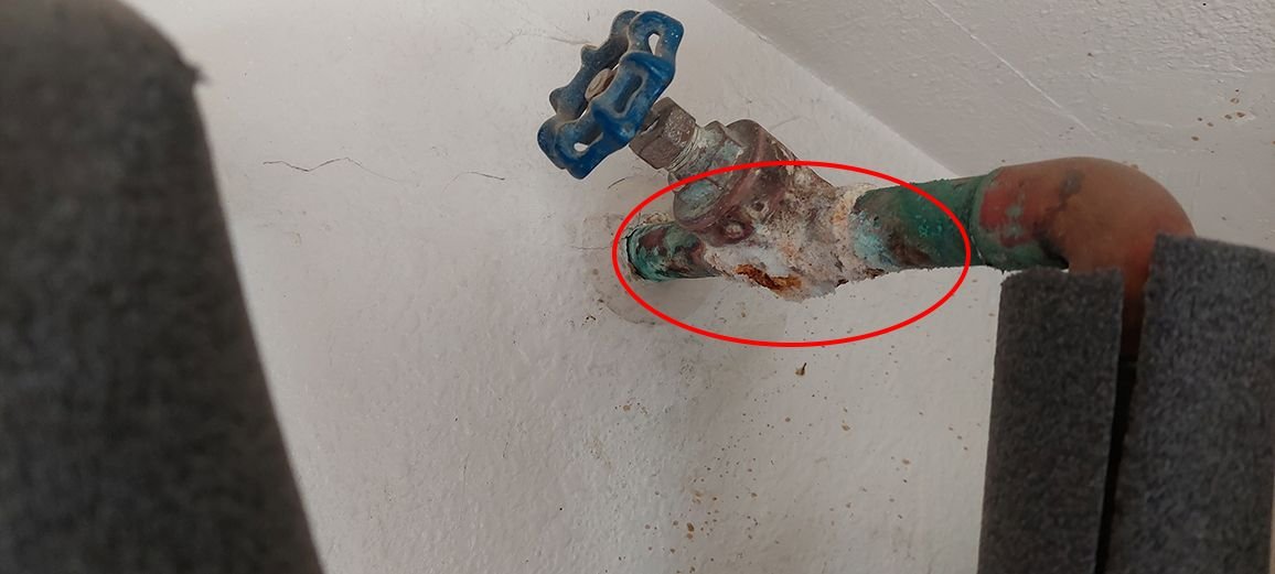

is this corrosion on a copper pipe?
Today I found this pipe that leads to my gas water heater. Is this corrosion? Do I need to replace it or can I sand it and use a cleaner?

Yes that's corrosion! And good luck trying to shut off that old gate valve.
They should have been outlawed long ago. Replace it with a ball valve!

It is but a normal occurrence with exposed copper. Think of the millions of miles of copper in every house where it's used for gas and water lines, nothing to worry about.

Marq1 won't that leak water at some point?

It's surface oxidation, patina, creates a coating on the copper that protects the metal, your good!

I would assume a lot of that is galvanic corrosion caused by the dissimilar metals. I didn't even know that soldered copper was ever permitted for gas lines. Like the others I wonder if the valve still works. If not that's a safety issue not to mention making it a much bigger job if you ever have to work on the heater or replace it.

I think it's a water line feeding the HWH. The corrosion is verdigris and is a common patina on copper. It's nothing to worry about.
Gate valves like the one shown should be cycled every now and then because they have a tendency to freeze if left in one position.

Yes, it's a water line. Would cleaning off the white flaky stuff make it worse or no difference? This is a rental unit so I figure it would leave a better impression if it's clean (at least between tenants) but not if it causes problems.

You can just leave it. After all, it's been that way a long time.
There might be a very small leak somewhere that is helping the corrosion. Notice how the corrosion starts at the elbow fitting joint and everything to the left is corroded but the elbow is clean.

I agree with Pilot Dane, it's likely a very small leak that's causing the mineral buildup. The good news is it's unlikely to get worse anytime soon. I wouldn't touch it - and plan to have it replaced when the water heater is replaced.
A simple battery powered leak alarm wouldn't be a bad idea, assuming the water heater is on the older side too, especially on a rental, since tenants seem to never notice anything.

Verdigris on a pipe connection does not necessarily mean a leak. Condensation is probably a more likely cause. If you need to clean it off scrub it with a stiff toothbrush and lemon juice. If you are concerened about a possible leak wrap the joint in paper towels after cleaning.
