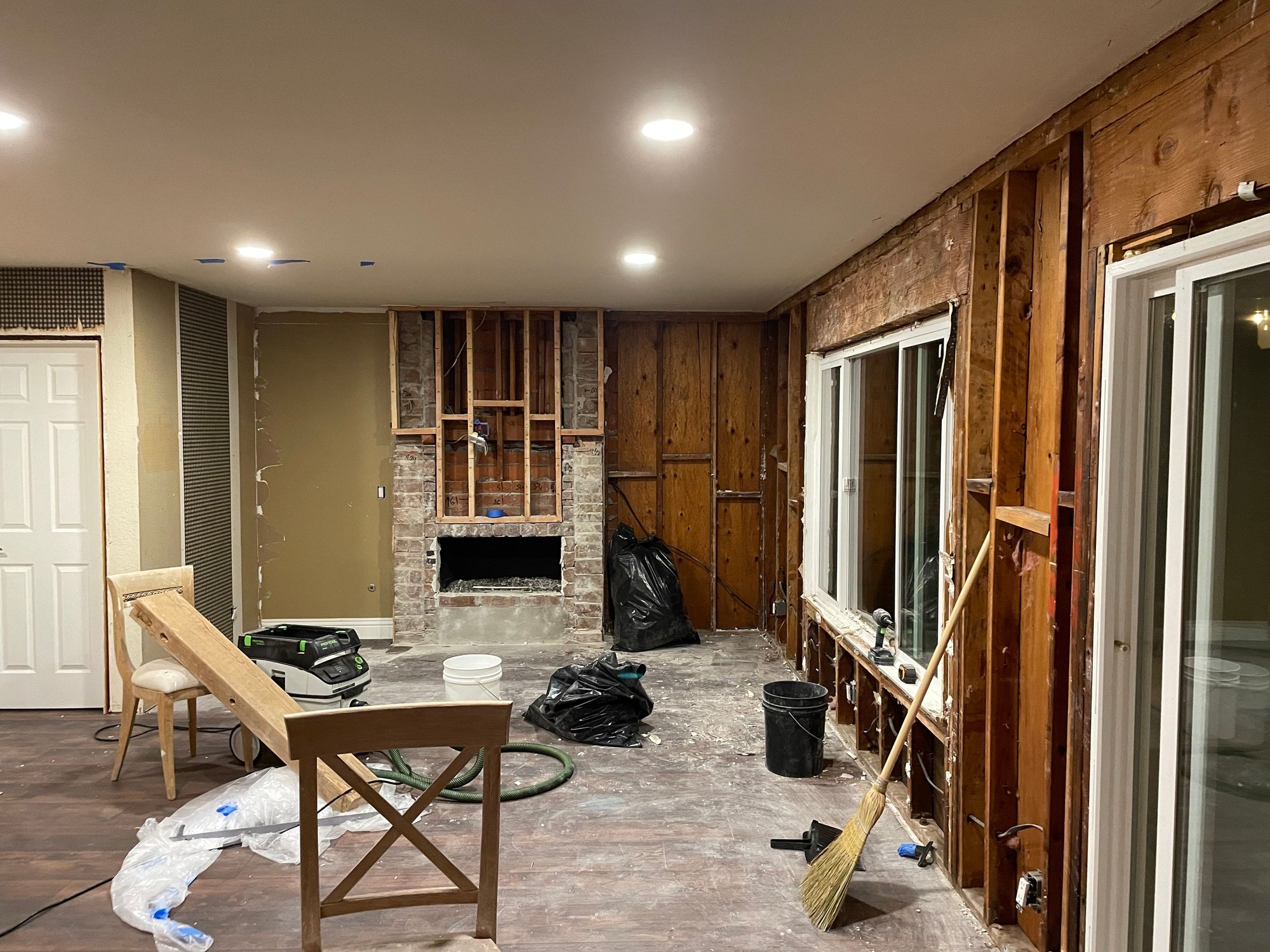

I bought a house that has a gas line running all the way the entire width of the house on the back, on the outside. My goal is to move it to the inside.
My question is on advice on where to run it without impacting my home structurally too much.
Top contenders:
- through 2x4 framing in the rear of the house (upstairs, due to patio door downstairs)
- through floor joists between 1st and 2nd story
- through roof rafters above 2nd story, I believe that there is no attic space.
I attached 2 pictures of the outside and 1 picture of the inside. The inside picture shows the downstairs, to the right is the back wall. The back right corner in is where the gas line would enter the house from the outside.
Run it where you have the best access and what you want to destroy installing it. You only told and showed us it running across the back of the house but didn't say where it needs to go (what it must service). If you look at the house and see where the gas needs to go it might help make your "where to run" decision.
You'll probably use CSST because of its flexibility which can make it a lot easier to retrofit install in wall studs and floor joists. If putting it in your attic (really, you don't know if there is an attic???) you might be able to run threaded steel. You can also use soft copper but my gut says it's an expensive option right now.
The pipe is for the stove in the kitchen and the outside BBQ, which are both pretty much at that corner of the house where the gas pipe is going.
I didn't realize that there is a type of flexible gas pipe that is allowed inside walls! Thank you, that helped a lot. I thought I would have to use the threaded pipe, which I imagined being very difficult alongside a 2x4 wall.
The flexible gas line is yellow and is called CSST.
It is not strong like iron pipe. It must be well protected where it's run.
Good luck.... it's not going to be a simple job.
If you do end up using CSST I do recall that the cuts had to be square and clean in order to get a leak free connection to the fittings. With careful work a fine toothed hack saw and then cleaning with a file can work.
Also, check your local codes and the manufacturer's installation recommendations to see if connections/fittings are permitted in concealed locations like buried inside a wall. I personally like to run the tubing continuous through walls and inaccessible locations and only have fittings were they are open and accessible. If there ever is a leak I want it to be in the open where it can vent naturally, I can smell the leak and fix it. I don't like the idea of gas potentially leaking inside a confined space.
I guess my question is why, aesthetics of just removing the pipe from the wall?
With the other items up there, looks like electrical, maybe some type of custom conduit/channel to contain everything might be an easier/cleaner option.
