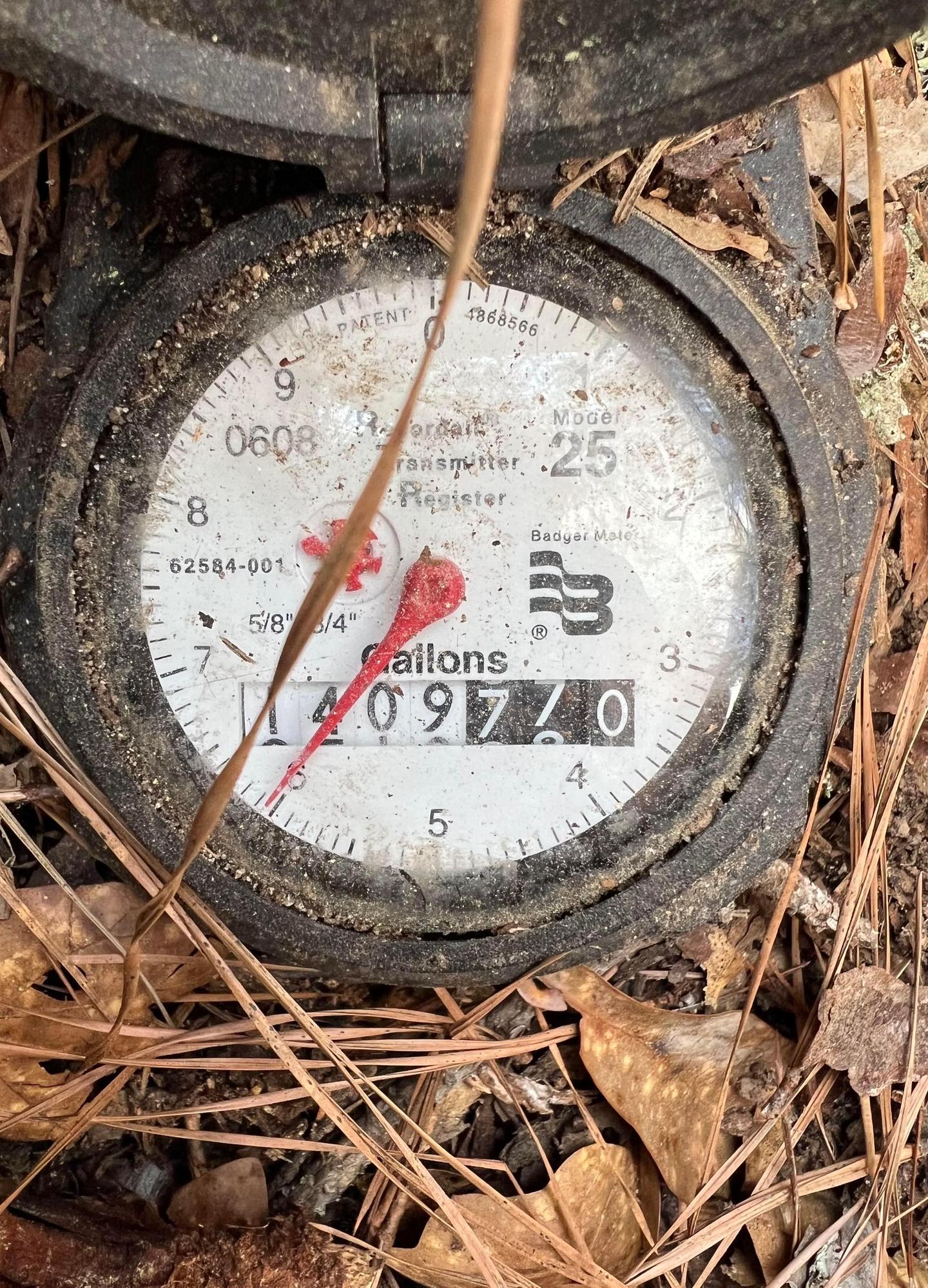

I am looking for advice on a water mains leak, we recently moved into a home we purchased and since the inspection something happened with the water and even worse the mains, ( we did not notice the water was turned off on our final walk through. ) I have fixed no less than 9 leaks now, and in the end bit the bullet and called a plumber as the water meter was still spinning, they could not find any leaks and suggested the main line from the meter to the house had failed. due to the plumbing and other unexpected work in the house, i simply can not afford the 2500-3000 for a new line to be dug. today i think i found where the water enters the house, and it is very weird as it enters the furthest point of the house AWAY from the meter. i think it is the mains anyway and have attached a photo, i am not sure why it goes down maybe 10 inches and AWAY from the meter direction also though. i have not found any thicker pipe as yet as it disappeared under a exterior wall and i am frankly fried physically and mentally today.
i have attached 2 photos of the meter and feel stupid for saying but i am not sure how much i am using, the 2 photos were taken over the course of 90 mins, and the plumber said its literally like a fast dripping tap.
i guess my real question here is whether i should dig a trench and lay a new line to the 1st corner of the house before entering the crawl space and plumbing into the water system ( there are plenty of pipes that end of the house. ) i hope i have made sense and not come over as more foolish than i feel, as i am just trying to get this sorted as cost effectively as possible.
thank you for reading.

I would very rarely attempt to repair main line leaks or breaks. If there is a leak it can indicate the pipe is nearing the end of it's life.
I would run a new line from the meter to the closest or easiest part of the house where you can access the crawl space. Make sure to check your local codes for the minimum burial depth. If hand digging don't cheap out and try to go shallow. That minimum depth is there for your protection so the water doesn't freeze.
Do not attempt to go underneath the foundation. At or below the required depth pop/break/bore a hole through the cement blocks into the crawl space. In that hole mortar in place a short section of pipe. 2" or larger PVC or ABS works well and has extra room so pulling the new pipe through is easier. This pipe protects the water line from being damaged by the sharp edges of the hole. After the pipe is through and near the end of your project you can use spray foam or caulk to seal the space around the pipe if you want but it's not required.
Then once you have your waterline run into the crawlspace you can go above ground to connect to the old connection point. Depending on how your house is plumbed if you have a suitable cold water line near where your new line entered the house you can connect your water main line there and cap off the old location.

welp its confirmed, turned both of the stops off and the meter still spins. i guess its time to start digging.

Turn off the shutoff at the meter and see if the flow indicator wheel stops turning. If it doesn't contact your city or water department and have them repair the valve so it does close properly. Then when doing your work you don't also have to contend with the water from the city's leaking meter.

Yeah once turned off at the meter it stops, that was my initial hope, that the meter was busted, but sadly not the case.
