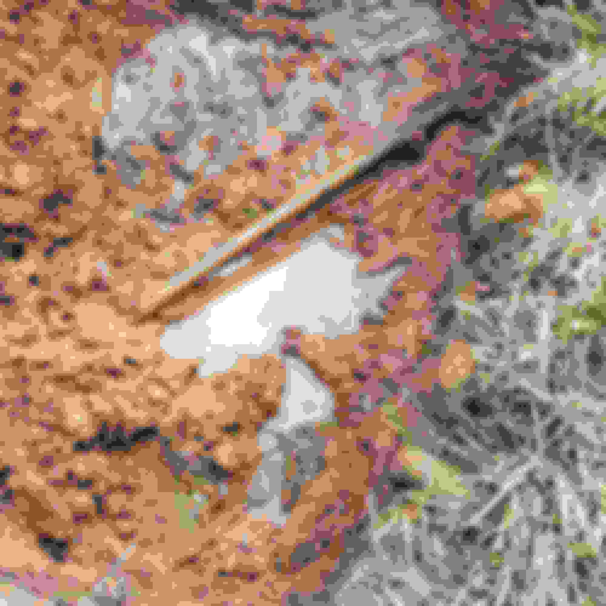

Had a wet spot in the yard and dug down until I found the culprit. A pin hole in my service line.
Going to have it shut off for repairs.
What would be the best method to fix that type of pipe?
thanks

Hard to tell exactly what that is.
It looks like 1" black polyethylene pipe.
Doesn't usually get holes in it like that.
If it is 1" poly.... you can use a barbed splice for repair with a few worm drive clamps.
You would require a heat gun to soften poly to insert the coupler.
What type of pipe is it?

I think it's the 1" poly mentioned above. It flexes.

Yup, exactly what Pete described. Other than helping get the coupler in, it should be an easy fix.

If it is black poly then a barbed coupling like PJmax mentioned will work.

Turned out it was 3/4 poly. Had a key and turned the water back on. Will check it in the morning.
thanks for the responses.

The installation of the black poly was probably not done correctly. It should not be springing leaks. I believe you are supposed to make absolutely sure there are no rocks/stones near the pipe. That can cause damage over time.
I would try to remove as many rocks/stones as possible. (I laid mine on a bed of sand).

I own and grew up in the house next door to this one. When I was kid all the houses in this area had wells. The blocks, bricks and broken tile I dug out of the hole told me that they ran that line through the same spot the old well was so it's no wonder it sprung a leak.

Oh -hopefully then maybe the other areas where the pipe runs are OK. Seems like a good chance that might be the case.
