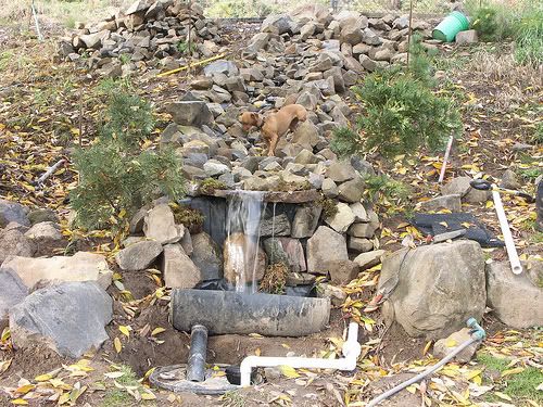

I will only tell you what I have and then you ask the questions.
I have a pondless (for the puppies) waterfall with a stream of about
10' and the waterfall is about 3' high. These measurements aren't 100% accurate but close. The pondless is about 2 - 2 1/2' deep.
I also have a drain in case it rains too much.
Hi TECH INFO BELOW:
Because of the height of the waterfall, the pump must be a certain size.
If your waterfall is less than or equal to 3' high I can tell you what I bought that will work for you.
AND I thought this was so sophisticated.................but it ain't.

Okay. Here are a couple of photos of my work in progress. So far my family and I are very pleased with the results. Still a lot of hard work to do.
Water feature in process on Flickr - Photo Sharing!
I posted your picture in the thread to make it easier for others to view - PilotDane

I like your design having a separate pump chamber. You have easy access to pull the pump out in winter or to do any repairs and with the catch basin full of rock you don't have the pool of water for a drowning hazard. You've got the best of both worlds. I also like the rock. It looks very natural in your surroundings.

I like the dog feature...but you should have water come out of it....or does it already? LOL
Looks like a lot of sweat involved.....

Are you referring to my puppy pond? If so I can tell you it has a 3 foot wide waterfall that is three feet high and about 13'
long and the water runs down the waterfall.

I sure hear you regarding sump pumps for water features. What I ended up with was a submersible pump designed for a water feature. It cost me about $85. It is designed to use either way, but I tried above ground, only to find it had unstoppable leaks. It is rated at 3200 GPH, and I have about a 15 ft. head. I end up with a decent flow, though you can never (rarely?) have too much. My pump burns about 250 watts. I'll post more as the project progresses. I'm disappointed that my captions did not download to this site with the picture. Click on the Flickr link to see all. Incidentally, Rusty dog does spray but generally in appropriate places.

The Rusty dog I was referring to is in my picture. Let's see some pictures of your creations... any of you out there. If I ever get out in the yard again (rain here for weeks) I hope to finish my 'disguise' enough to warrant another picture or two. I am still at the challenging part of my build... but there are still rewards.
