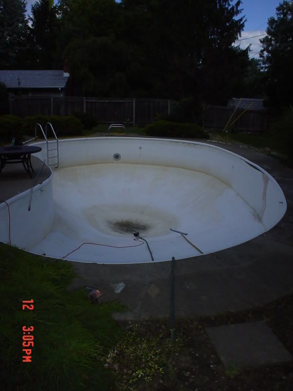

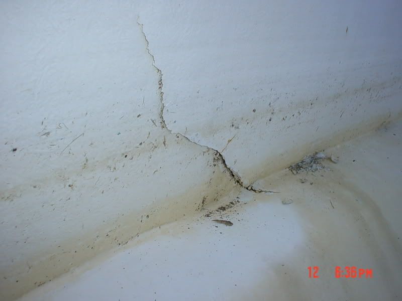

I'll post links to some pictures. Hopefully this will work:
The whole pool:
http://i100.photobucket.com/albums/m13/corinth134/pools002.jpg
You can see the entire pool here (toilet bowl view). An old repair on the right side with the wall leaning in a bit. Behind this wall you see some metal strips running vertically behind the concrete.

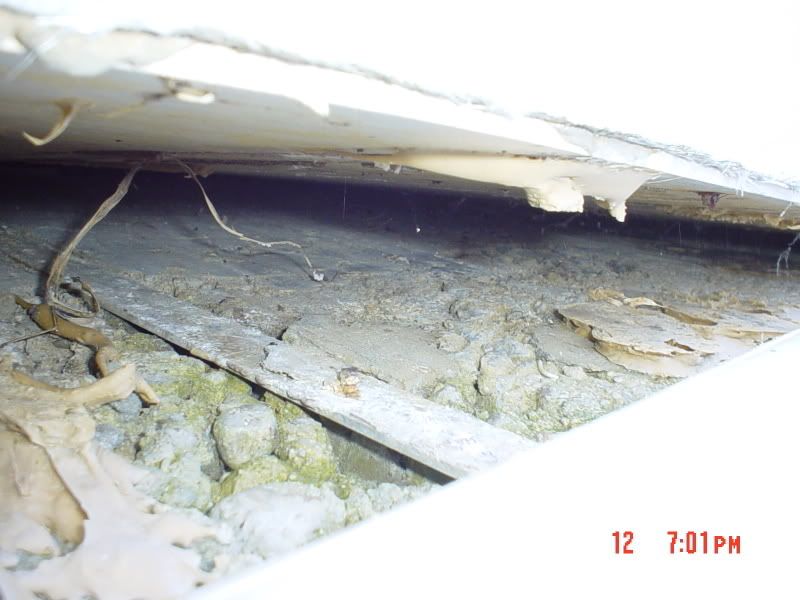

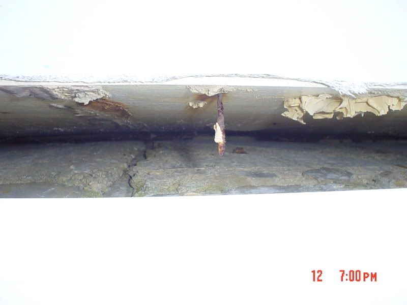

Behind leaning wall:
http://i100.photobucket.com/albums/m13/corinth134/pools008.jpg
Here you can see behind the leaning wall and the rusty screw.
http://i100.photobucket.com/albums/m13/corinth134/pools009.jpg
Here you can see behind the leaning wall, the concrete, and the metal strip. You can see the Liquid Nails that I attempted to use to attach the fiberglass to the concrete.

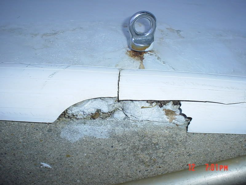

Damaged Coping:
http://i100.photobucket.com/albums/m13/corinth134/pools010.jpg
Here is a picture of some coping that I can't figure out how to fix.

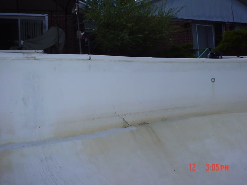

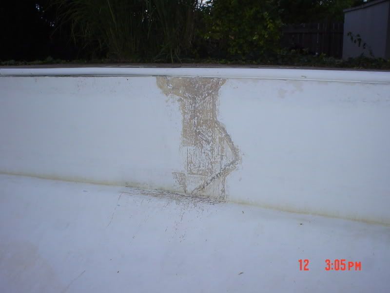

Crack in left side of pool:
http://i100.photobucket.com/albums/m13/corinth134/pools004.jpg
Here is a large crack where it looks like the wall has bulged in. I'd like to push this back in and reattach it to the concrete. I shined a light in the crack and I can see concrete but not why the bulge was there in the first place.

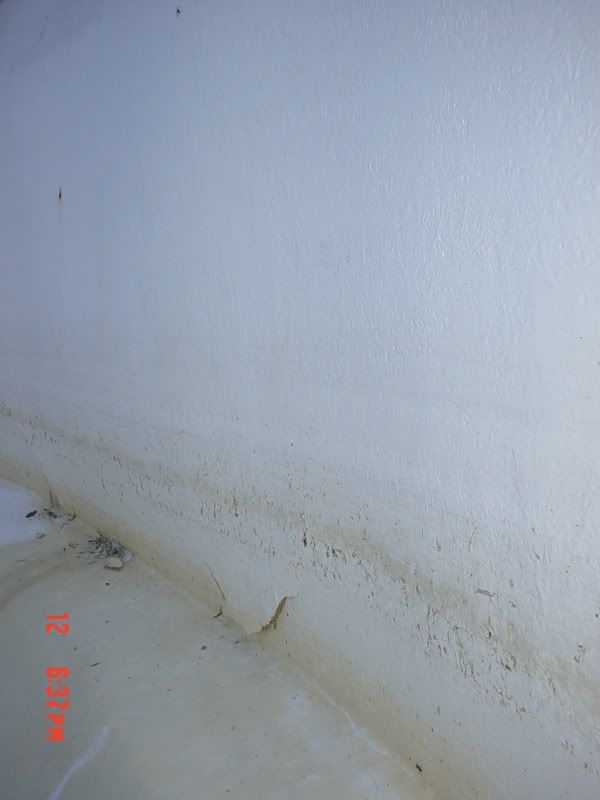

Closer view of crack:
http://i100.photobucket.com/albums/m13/corinth134/pools005.jpg
Another crack close to the last one viewed from the opposite direction:
http://i100.photobucket.com/albums/m13/corinth134/pools006.jpg

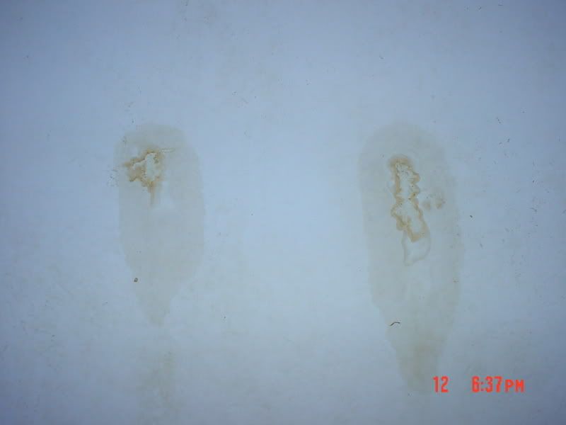

Lots of little cracks all over the floor of the pool:
http://i100.photobucket.com/albums/m13/corinth134/pools007.jpg
They range in size from 1/4 inch to several inches. The longest one I found was about 3 feet long.

So what it looks like is you have a pool that was originally built as a concrete bottom and fibeglass walls. Somewhere down the road it looks like someone had a thin fiberglass coating put into the shell. This fiberglass liner is what is giving the trouble.
Bad news is your problems are probably only going to worsen. I would suggest looking into puting a vinyl liner in pool. If you want to continue to patch, there is a adhesive called dynamix, it is a 2 part adhesive that is applied with what looks like a caulking gun, it has a tip that actually swirls the 2 componets together so it comes out of the tip mixed. It is STRONG...
I would use this to fill in behind all cracks then seal the top with resin. I would also use this for the wall problem and screws as mentioned earlier.

http://s100.photobucket.com/albums/m13/corinth134/?action=view¤t=DSC01696.jpg
Shows a lot of the repairs that I've made. Tons! Plus I re-repaired the crack on the right side, and fiberglassed over the light since there was water in it.
Here is a picture of the crack on the left side from a short distance for perspective. The structure that looks like a bridge is $36 in 2 x 4's for a platform. I kept sliding down to the drain when I tried to work on this area. http://s100.photobucket.com/albums/m13/corinth134/?action=view¤t=DSC01695.jpg
I pulled a section of fiberglass from the wall at the crack on the left side. Now I can see that what should be solid concrete looks like a mixture of dirt and concrete. Looks like there was water coming through here and deteriorated the concrete.
see: http://s100.photobucket.com/albums/m13/corinth134/?action=view¤t=DSC01694.jpg
So, what can be done with this? I dug out junk from about 6 inches back into the concrete. The area above the crack looks solid. Is there a way to spray something in there and seal it up, then fill it with something before I repair the wall?

WOW have you been doing some work... The more I look at your pics, it looks like your pool might have been a vinyl liner at one time. Does the coping around the pool have a track just under it? Maybe filled in with fiberglass? It is difficult to say what to do without being able to actually see and touch. I don't know what you could spray in the hole, you might be able to use hydrolic cement.

Just wanted to post a picture after it finally got painted.
Here is the pool repaired and painted. I used epoxy paint and it is very slippery under water but the surface is like a new pool!
http://i100.photobucket.com/albums/m...4/DSC01703.jpg
We actually got to use the pool before it got too cold too.
Hopefully, next season, it will be just as nice.
