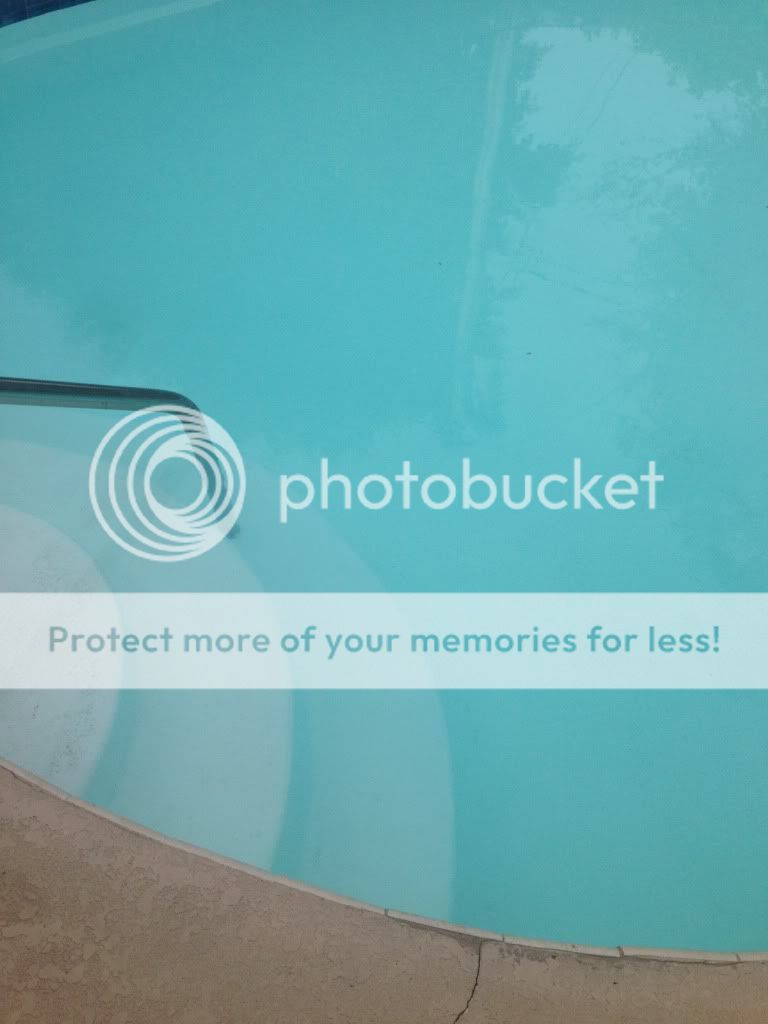

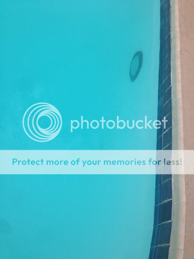

what color is the pool now?
Go ahead and chlorinate then... .. I found this... Basically this is what you want to di...

Old 09-16-13, 06:57 AM
Join Date: Sep 2013
Posts: 69
wow, Anyway, I have to try it.
this is my pool now.

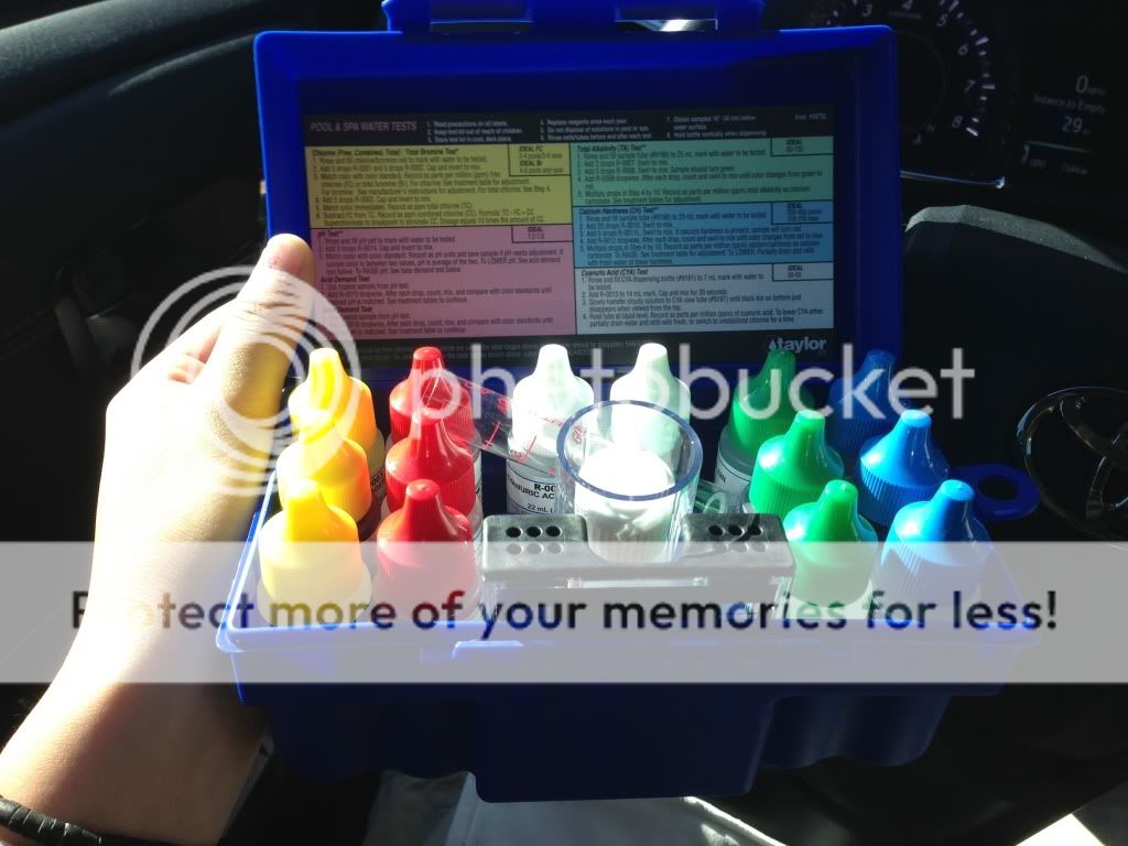

oh dear, i got the test kit at leslie's today.
new problem, it's only show at 5. am i bought the wrong thing?
update: the taylor FAS-DPD Chlorine test is on its way now.

I just received "FAS-DPD Chlorine test kit" this morning. I can not wait and want to get started quickly
but the work and time does not allow. This Sunday I will start it? I will post the test results before I start. have a nice day guys!

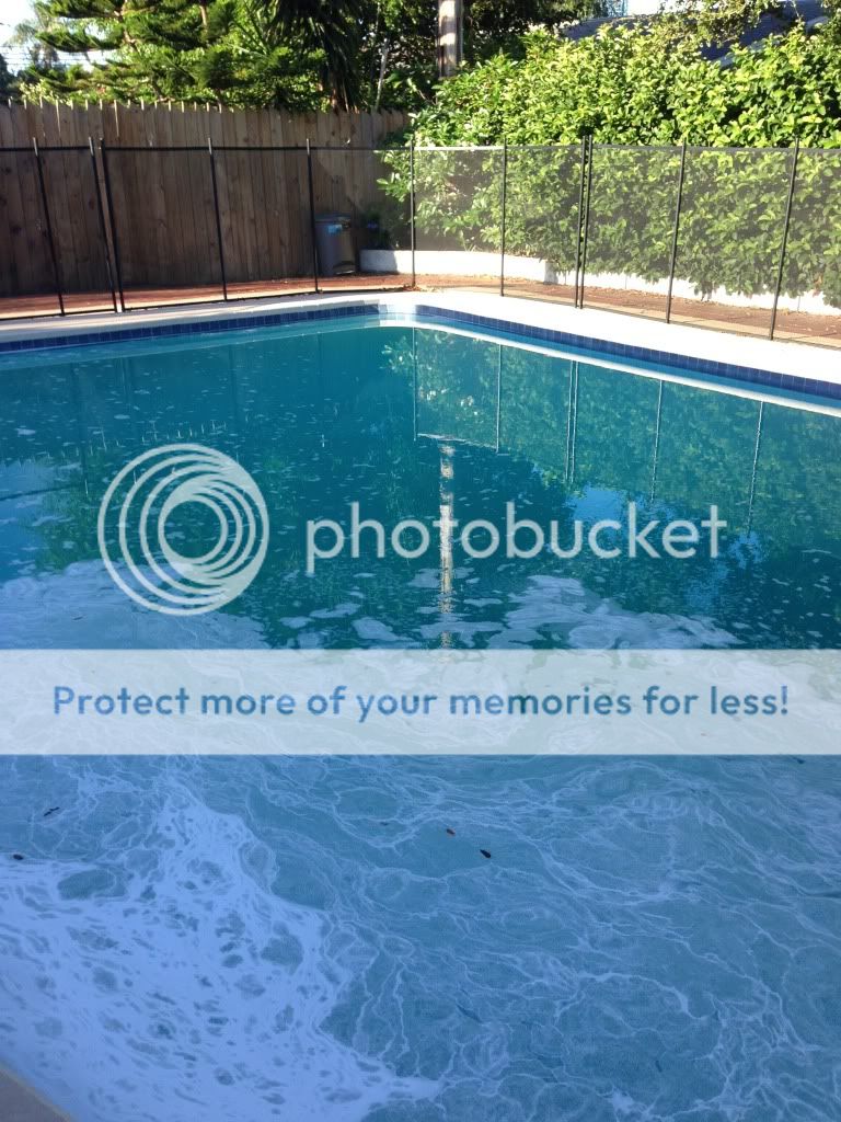

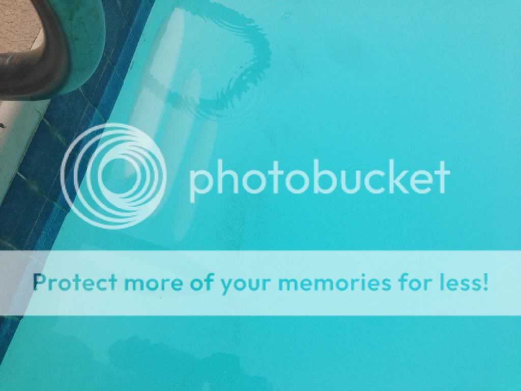

my pool this morning:
last night the FC level is 13ppm and CC is 1ppm
this morning FC = 8ppm and CC = 1ppm
water clear little bit.
i just added 3 more gallons to keep FC above 12ppm

Great keep it going. Important to keep chlorine up at all times. Like I said you may need to check hourly.
You may want to keep it a tad higher like 15ppm.
Whats that foam???? That is not a worry but probably added stuff from the pool stores that you should not have.

nothing, i just add bleach...

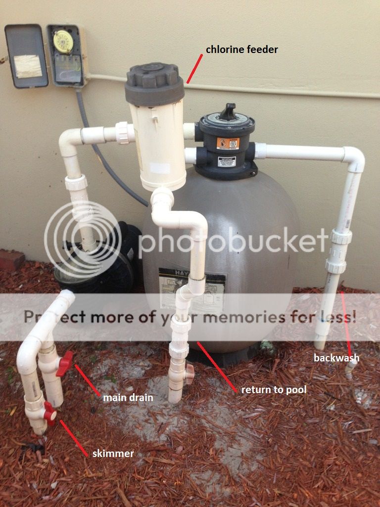

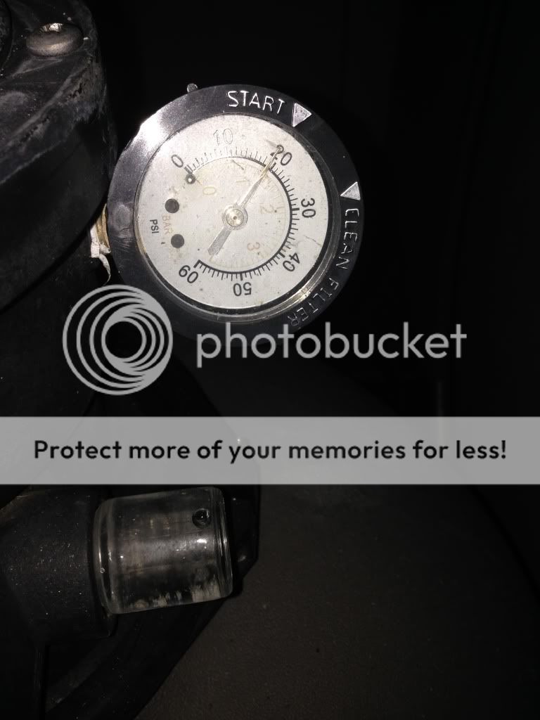

i was change the sand in my filter last week, but psi always read high "20", a little down when i backwash.

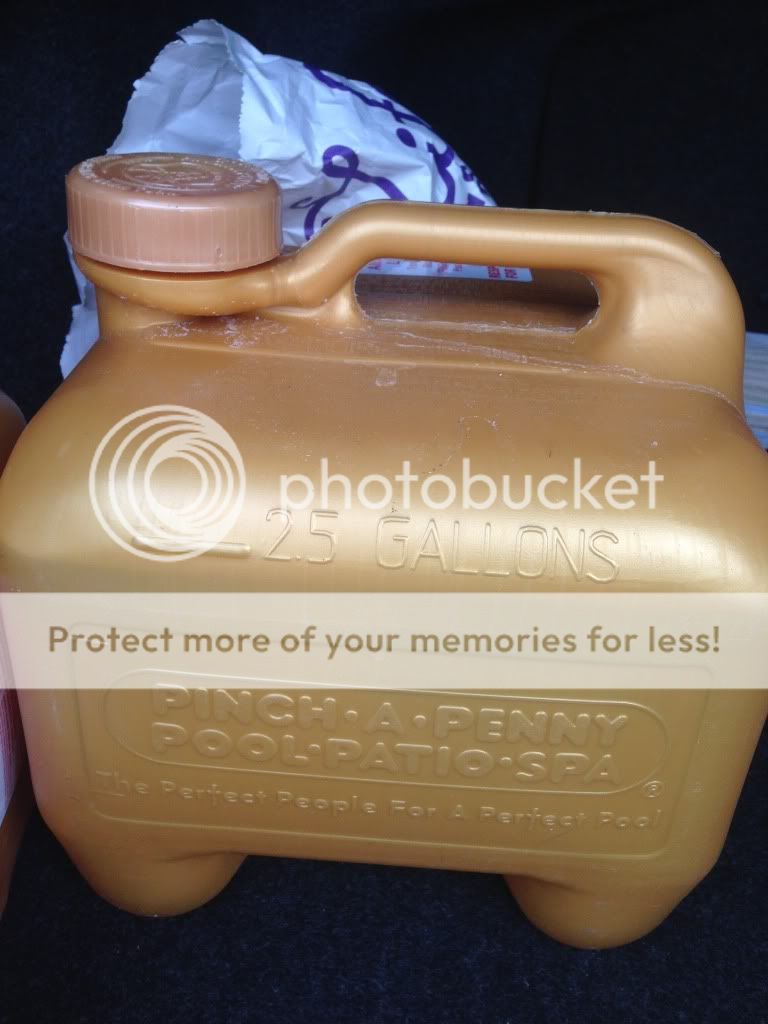

oh can we talk about price of liquid chlorine,
this is information about it:
Liquid Chlorine | Pinch A Penny Store
and this is what i have at home: 2.5 gallons of 10.5%
receipt: $3.49/each
Thats not bad. Whats the max psi on the filter? 30 psi?

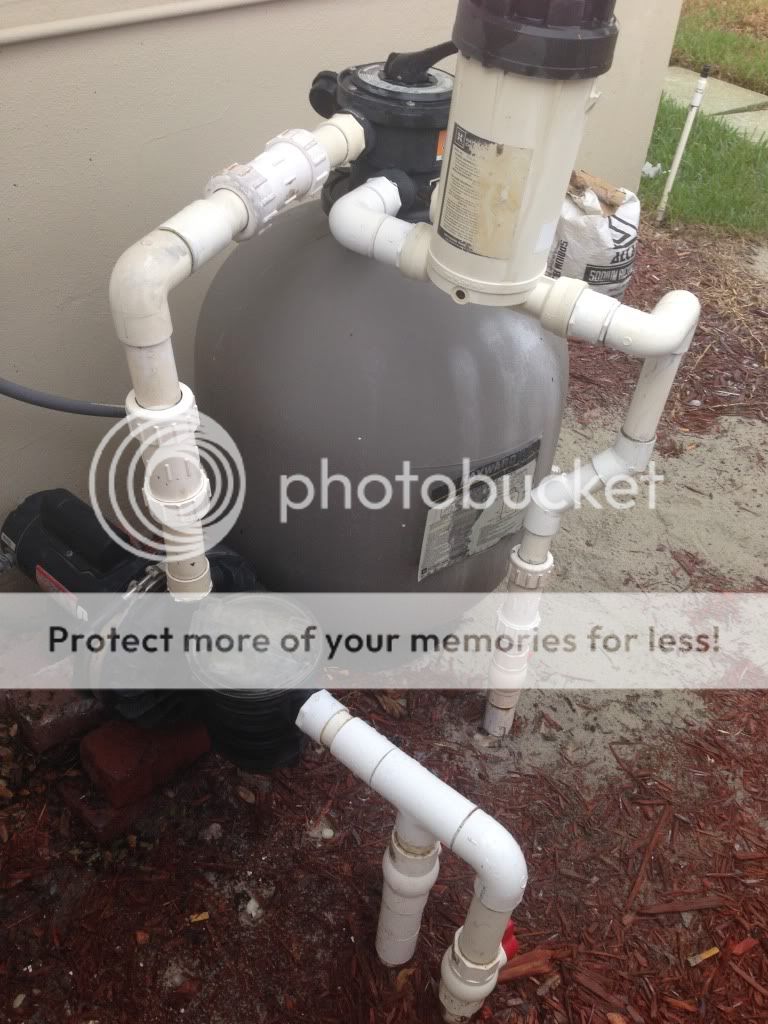

Lets go back to this pic and take a few more pics of the filter for me.
That other valve, why is it closed? Thats another return to the pool. You need to open that. You have two skimmers in the pool? You stated shallow and deep end right?... And you should have two jets that shoot water back to the pool. Aim these down somewhat and in the same direction to get a circular flow in the pool, and the stir up the bottom.
Open that second valve and psi should go down. Basckwash, then tell us the starting psi after backwash.

You have a chloronator there also. I dont like them and dont recommend them. They are only good for like if you go away. They are plauged by flow issues and cause staining and such..
Like I said trichlor tablets have stabilizer in it and will continually raise your CYA if you use them all the time. You will need to then keep higher levels of chlorine which costs money... Cal hypo is the only one that has no stabilizer but I believe is hard to fine and only comes granular. Never mix tri chlor and cal hypo... It can go BOOM!!!
What is that? 2.5 gallons of 10% for $3.49??? Thats great man.. I wish we had that here... Whats the catch though. Your not telling me everything... It says exchange... How much was the jug? I would take it that you need to bring that jug back and have them fill it? And only so many times? LOL.. Just asking is all...

-about the valves, almost 3 weeks working with it, i figure out here
-i took this picture 2 weeks ago, but now i changed something, after i removed all stuff on the bottom, sometime i open the "closed" valve, i relized it is the main drain,
and the "open" valve is the skimmer. so i keep both open from 3 4 days ago til today. the psi still 20. (i backwash every 8-10 hours)
that just what i figure out. i dont know right or wrong. can you help me what i should do? both open or just the skimmer?
my pressure gauge:
i've try to touch the bottom of the skimmer, it only have 1 hole.

-yes! I used and brought back. then they will fill for me. my nearest ace hardware cost me 6.98/5gals, i get those jugs from the house preowner.
the other ace hardware, last time i came, i saw they have a lot of empty 2.5gal jugs and will sell me almost $10/5gal, i think that $3 more is the price of those jugs.
leslie's pool store have it too. $6-$7/2.5gal,as i remember. all is 10.5%. i see that NJ have leslie's too.
Both open... Only for clean up close the skimmer while vacuum. Push stuff to main drain. Better suction..

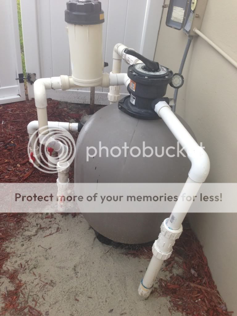

Tomorrow morning I will take more pictures of the pipes from different directions.

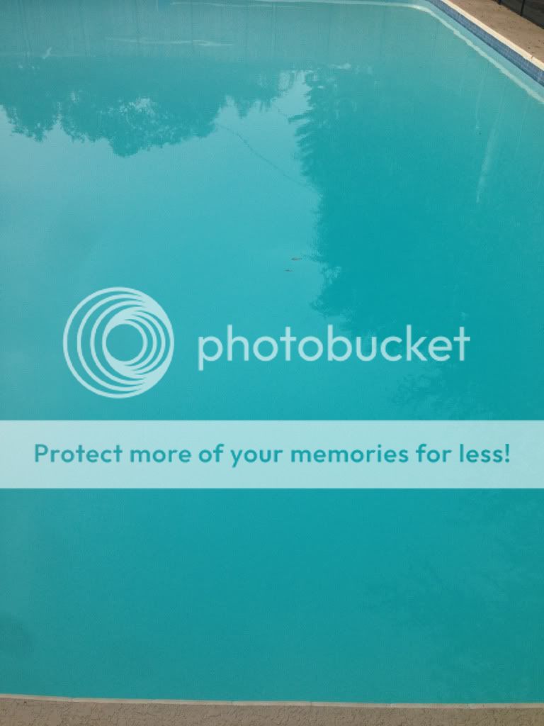

and this is some pics of my filter:

Good... Keep filtering 24/7.
You may want to raise the chlorine some say in the 18 range. So your saying its holding from the night before?
Now its just a filtering issue.
When you changed the sand did you inspect the distributer for cracks?
Did you replace the spider gasket in the filter valve?
These things can contribute to reduced filtering capacity. Dont backwash too much as dirt in the filter makes it filter better. Let the psi rise some 5 psi or so.
An old trick I used was to add DE to the skimmer until the psi in the filter raised about 1 psi. DE will make that filter far superior and filter better. But when you back wash you will need to add more DE.
Give all test #'s again please.
Also I see that is tile on the side of the pool? That means the pool is cement. We will need to get the calcium levels in check but I would like to see the #'s.

I just worry that my filter is having problems.
Is the pressure rising? Example: If you start with a 20 psi clean filter does the pressure rise overnight?
You should have checked the laterals when you had the sand out. The best way , and to retain the sand is use a shop vac and suck it out. When the vac gets full dump it on a tarp. Then pull the lateral. If the tube is cracked you can replace.

Old 09-23-13, 05:43 PM
Join Date: Sep 2013
Posts: 69
Good news: i can see the main drain on the bottom at deep end.
7:30pm
the chlorine still pretty high. today i didnt add anything, just rain all day
pH=7.5
alka=140ppm
hardness=160ppm
CYA= 30ppm
i'll test the chlorine before i add more chlorine to raise it to 18 tonight

OK let us know how the pool looks in the morning...
I had this trouble with my pool once. I will explain that later if yours does not clear soon.

Cool... Its a filter race now... just keep filtering, and I would maintain shock level until clear. It should not take much chlorine to maintain a 12-15ppm... But I would bump it to 18 before bed and see what results you get tomorrow...
