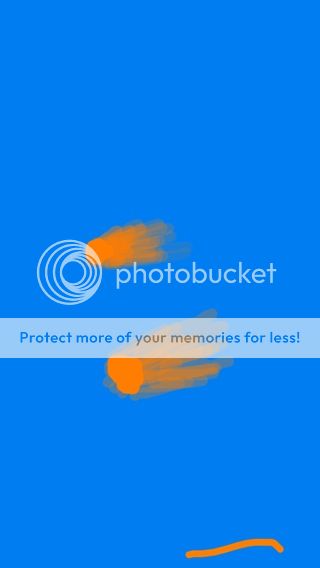

this morning I saw the bottom of my pool dirty. yesterday it didnt.
many dirt
i tried to brush it out but not work
this is how it look, i drawed it out, it's brown.
what is it??

It may be mustard algea but it should sweep away. Very Important.. Was it always there? Does it sweep away with a brush?
We need to know first. May just need to shock again. It is possible we could lower phosphates but your pool will cload if you add that IMO. All those other mustard out, yellow out stuff is amonia based and will mess up the pool further..
Adding borates may be best before any phosphate remover...
I still think your filter may have issues, but let me know if that stuff sweeps away. It may just be a stain....

Post all your test results again... Possibly you are letting your chlorine levels dip...
Stains can be calcium leaching. algea, or organic in nature....

it's not sweep away when i brush, but now it's better, ( dim; blurred....i dont know how it called )
ph=7.6
FC=2.5ppm
CC=0.0ppm
CH=200ppm
alka=130ppm
CYA=30ppm
i just added 3gals 10% chlorine to raise FC to 15ppm

If it did not sweep away its not algae...
It may be a stain of some sort... Possibly rust deposit on etched area of cement/plaster. Thats may be from adding acid.
I would not worry about it right now...
See pitting etching here..
Stain Library - For Homeowners - Jack's Magic Products, Inc.

i think i should more attention to my pool. that's my fault huh?
i always run the filter 8-10 hours/day. and shut off at the evening.
I realized that every morning when I wake up it reappears ( the stain )
and then when i turn on the filter, it gradually disappears after 2-3 hours.
i also think like you. maybe my filter has issues. dont know what i should do now.....
