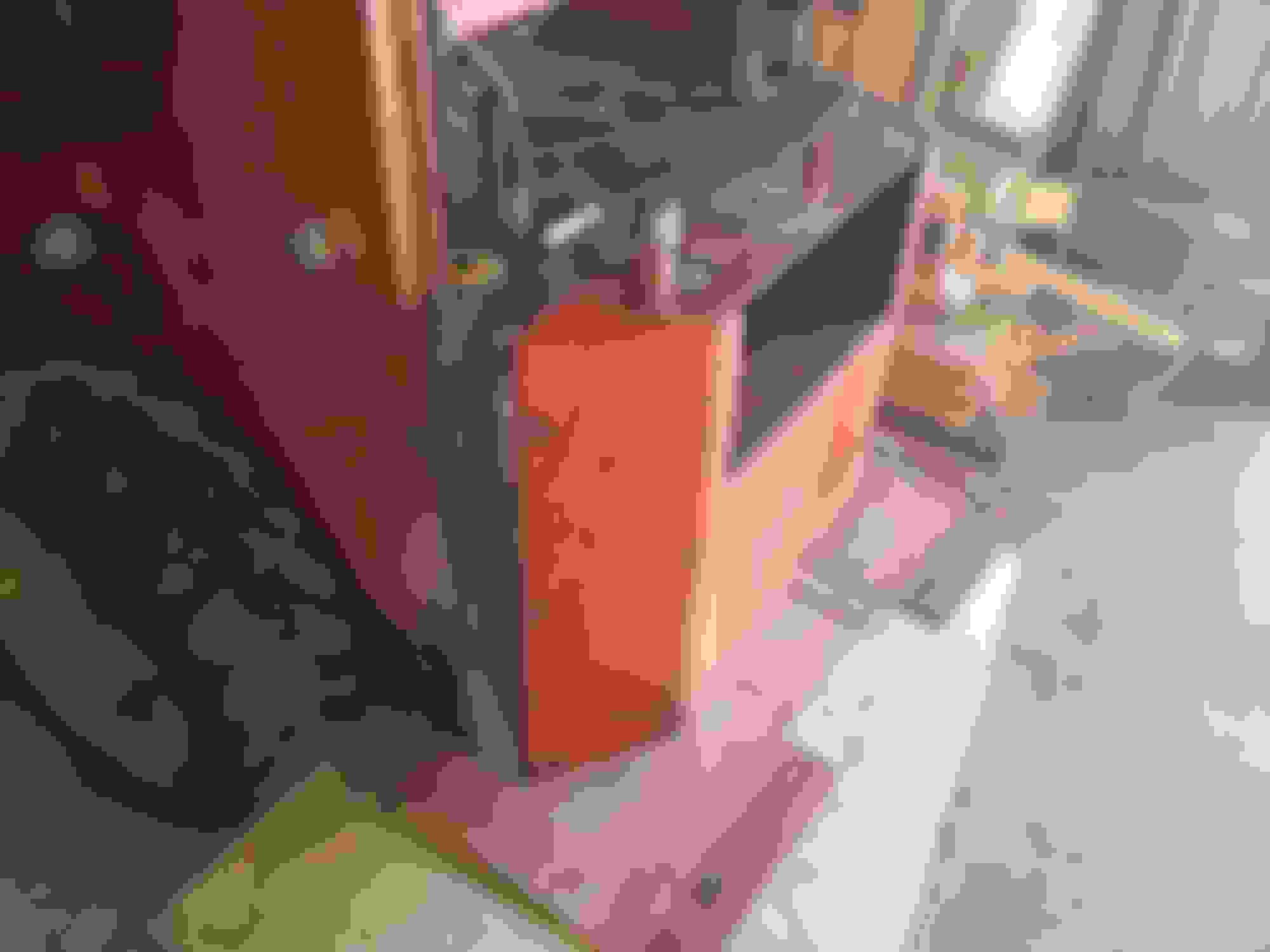

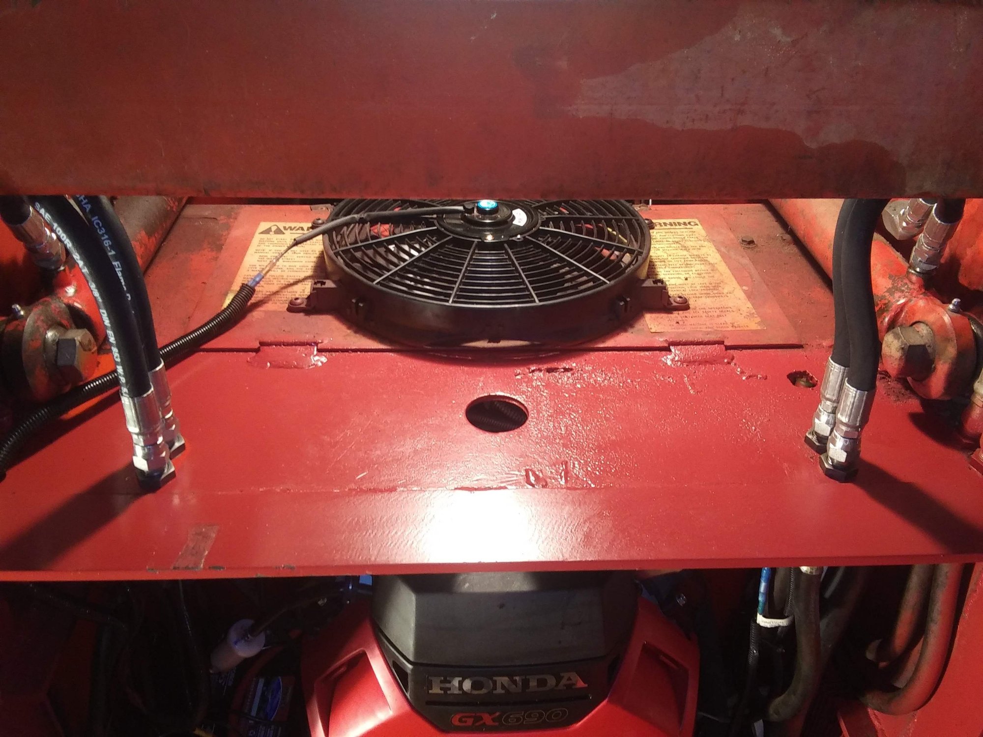

Repowering = removing an old worn out engine and replacing it with a new one. This presents some challenges especially at it is not an exact apples for apples exchange, since there are differences in the motor size, electrical hookups, location of exhaust, etc.
Thankfully I found a source for repower kits online that provided almost everything needed. Biggest hiccup was that the new motor was longer than the old one, so the back door would not close... making it necessary to remove the door, weld on a 3" extension, and weld the door hinges back on... along with longer supply and suction hoses.
Here are a few pics of the process.

Its a Gehl HL3000... not sure exactly of the year but im pretty sure its 1976-79. The old engine was an Onan NHCV/MS.
Its very similar in design to the IH4130 which was produced in 1978-9. One of the main features was a reverse flow air design where the engine shroud would exhaust air from the flywheel out the back door through a 90 degree exhaust hood and draw it in the front through air cooler vents by your feet. With a different engine, that flow is reversed, thus the need for an auxiliary fan to pressurize the compartment and blow air out. (Still need to block off that rear door opening.)

A few more photos... found a paint color in a satin sheen that matched the faded Gehl red pretty closely. Replaced 4 hydraulic hoses for the lift arms, and made a grille for the back end to cover up the opening where the old muffler used to be.

How does the new engine compare power wise with the original one? I put a 630 in my Gator replacing a 16 hp Briggs so I got a noticeable increase in horsepower.
Old 03-13-21, 06:53 AM
XSleeper's Avatar
Join Date: Dec 2004
Posts: 26,660
Received 1,809 Upvotes on 1,627 Posts
The specs are pretty much identical, which is ideal on this type of machine. (Top speed is 6.2 mph) 22.5 hp @ 3400 rpm (old) vs 22.1 hp @ 3600 rpm (new). I don't notice any drop in performance... in fact it probably has more power since the old engine was pretty worn out. And this one actually starts right up when you want it to!
