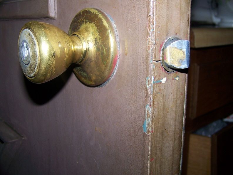

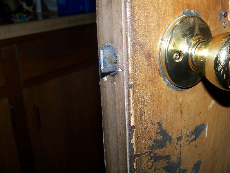

Hello. Here's doorknob working with:
When the door is closed and we try to open it, sometimes the following metal piece does not fully come out of the recessed part that it fits into when the door is closed:
The metal piece from a different angle (front of the door angle):

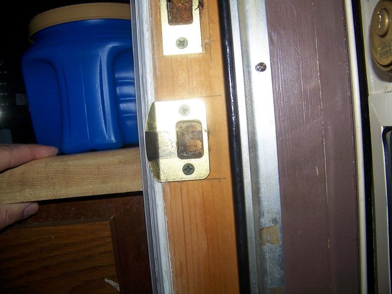

The recess, or niche, that it goes into. Bottom one:

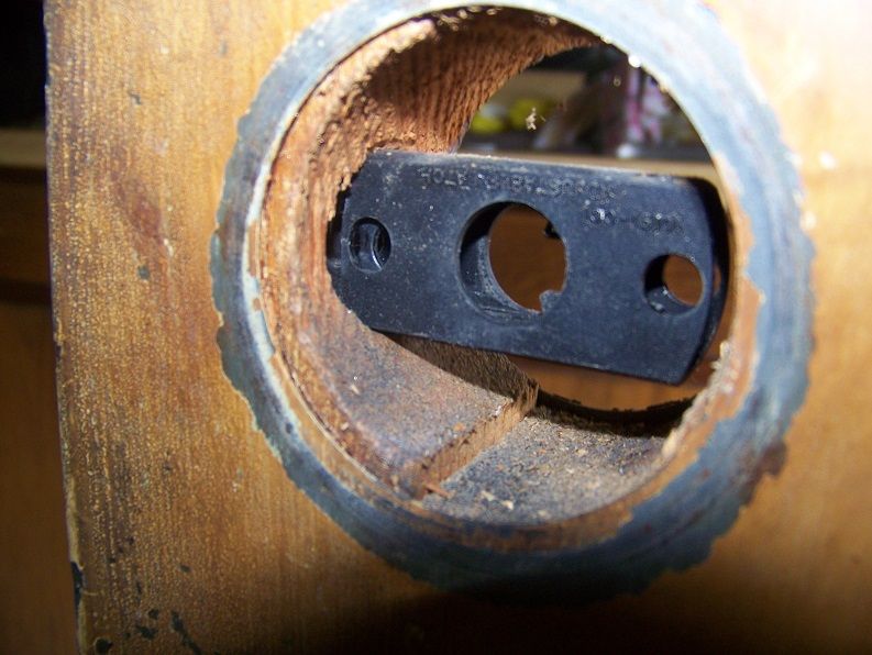

The aforementioned metal piece does not retract all the way when I turn the handle, irrespective of direction. IDK if that's part of the problem. See:
At any rate, how do I fix this is that I don't have to fiddle w/ the doorknob to get it to move that metal part far enough out of the recess so that I can open the door freely?

I approved your post with the pictures.
It looks like that lockset is fairly old and could probably use a replacement.

Loosen the screws and pull both sides of the knob up as high as it will go, then retighten. It looks like the latch is either way crooked or broken. I don't see the half-moon security lockpin, it could be jammed inside or just plain broken... if so, I bet you just need to replace the latch.
Kwikset, if I'm not mistaken. You can buy just the latch if you can't afford the whole entry set. A latch is like $5. You will want model Kwikset 1825-18.

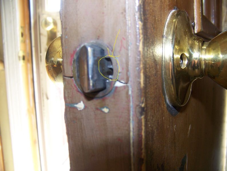

I raised the doorknob up. Didn't work. Here is a closer picture of that metal piece. Note the highlighted part:
Is it supposed to be in there like that? In any event, based on this additional picture, should I just forge ahead and try to replace the latch and/or entry set?
If so, could I get some more detail instructions, or at least a link to an applicable video? Thanks.

The part you have circled should not be stuck inside the door. Take the handles off and pull the latch out to see if its broke.

I took the doorknobs off. Here is the latch. What kind do I need?

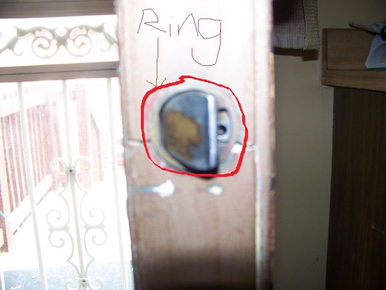

I can't get it out. There is no plate on the front of the end of the door where the latch comes out of the door. Just a round metal ring that is really low to the door. See:
So:
1. How do I take out this latch?
2. What kind do I need exactly? It doesn't look like the one above.

The replacement latch appears to be universal. You can use it without the plate.
Just use a screwdriver, where the red line is, to slide the latch in the direction of the yellow arrow.

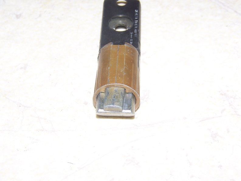

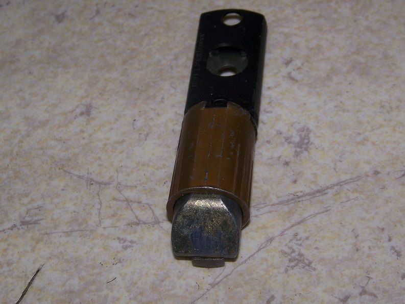

Here's what came out. One side:
The other:
Just go to hardware store and ask for one of these? Is the metal "crown" on the latch built into the latch?

It doesn't look like all the parts are there. Is something still in the door ?
I thought it was a Kwikset 81826-001 but on further investigation is matches the adjustable latches used by Master Lock.
A hardware store should be able to match it for you.
