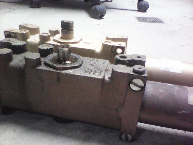

The closer in the foreground of the picture is an old bad leaking one that I plan on trying to replace with the identical closer shown in the background. These are LCN model 4114. There is a difference in height of the stem (or whatever it might be called) there that sticks up out of the central area of the top of the closers, to which the arm closer arm attaches. How do I get that stem on that one in the background down and staying on that lower position, like the old one in the foreground, instead of up high like it is?

Is the arm not clearing the door (assuming a standard mounting)? Look at the arm for the new closer. Does is have a larger offset than the old arm?

Well I do not have an arm for the new closer; I just have the closer itself. The old closer arm is standard mounted. Because both the old and new closer are otherwise identical, except for the difference in regard to the stem height as I mentioned and was pictured, I was planning/figuring I should be able to use the old arm with the new closer. But with that new closer the way it is with that stem sticking up like that and turned the wrong way at its apparent default position, I cannot affix the arm onto it that way.

One of the better closers ever made, the LCN Smoothie.....I've not seen a pinion shaft shaped like the one in the background......it doesn't even look square, nor does it appear to have a screw hole in the top to fasten the arm to. So it's either a really old model I've not run into, or it's made for a special purpose arm, like for a gate or something.
Hopefully Jess the Door Closer Doctor will see this, she's our expert closer person. That raised shaft almost looks like the type used on a "Floor Check" but I've never seen them used in that capacity. Maybe a very light weight door, I don't know.
The pinion shaft shape of the one in the background is the same as the one in the foreground. Probably just looks different in the photo because it's apparent default position is turned about 90 degrees from the default position of the one in the foreground. There's that difference, plus the other obvious one and that is the raised-up height of it compared to the one in the foreground. Yes hopefully we'll hear from others who may have familiarity/expertise in regard to these type closers. thanks

The one in the background, the newer one, has a sticker on it indicating it is model 4114. The one in the foreground is probably a whole lot older but the model sticker is unreadable. I'd been assuming both were identical models, but apparently they are not. They seem very similar, almost identical, in all other respects, except those I've mentioned and shown, as far as I can tell. The shape of the spindle or pinion or whatever it is called, is identical -- rectangular on both, with the short side edges of the rectangle(s) being rounded. The shaft on the one in the foreground does indeed have screw hole on the top that can accept the attachment screw like the other one, after the opening in the arm is fitted/slipped over the shaft (or pinion, or spindle, or stem, or whatever it should be called).

OK....well so it's not for Concealed Overhead use then, I looked it up and the 4114 is apparently handed only for left or right hand door, so that might explain the 90 degree difference on the "spindle" (I think is the correct terminology) position. The model you have in the foreground may be reversible, and that might explain the spindle height difference, so we'll both learn something when Jess chimes in. (hopefully!)

The different angle shaft closers (taller shaft) is used for track installations/concealed in frame, this technically can be set up as a paralell (like the leaker) but it would mess up the bolt hole locations and make closer body be positioned alittle lower being this (leaker) uses parallel rigid arm,
From seeing the bodies of the 2 closers, I am sorry to inform you that the taller shaft closer will not work, it is handed at the factory as a right handed closer (this cannot he changed!) Your closer is a LH (Left hand push side only)

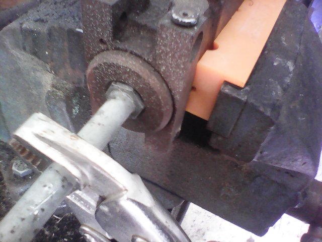

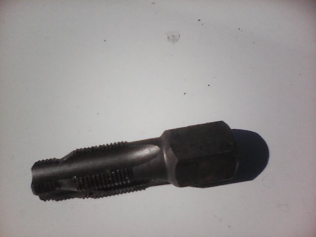

Update: I tried just about everything and more to get that plug unscrewed you just mentioned in your last two posts rstripe. Finally was able to manage using a 3/4" hex on the end of a tap, the tap inserted into a deep 3/4" socket on an impact wrench. Will post further progress. thanks!

That's quite an arrangement! Good luck!

Rstripe, The "ramp out" technique you talked about, I have had to do similar with a hammer and chisel on a 4040 from 1980. As for the king size channel lock pliers method, he's tried that as well as clamping the projecting part of end plug in vise and using a bar clamp to rotate the closer. Didn't work. As for the bolt, I have been keeping in touch with Sgull and the bolt broke in 2 from too much force, I have thrown other ideas at him other then those mentioned here and his tap method was what worked the best to get the end plug off the closer.
