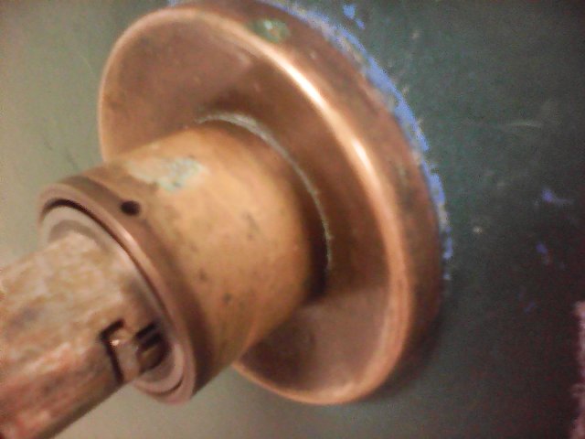

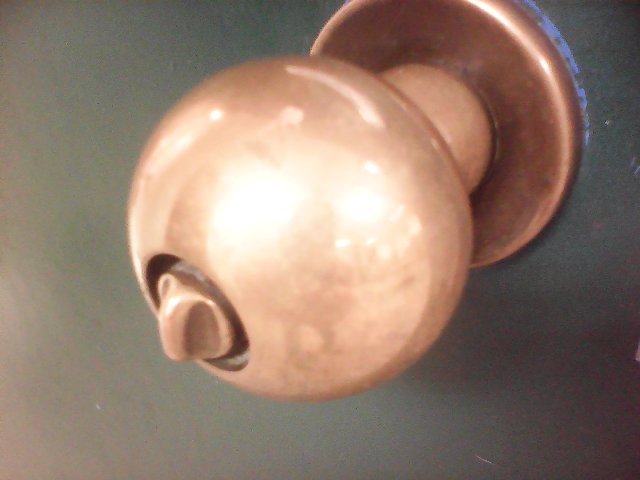

Getting ready to try to take out this old-school doorknob. I have a release pin to stick in the hole in the back of the one knob but then not so sure what I might encounter next, screws I would hope/guess. I think these can be somewhat complicating/baffling when it comes to takin' em out, especially for me. Any tips/comments/suggestions before I have at it appreciated.

Once you have the handle off you will need to pop the rose plate off the door. A thin putty knife works well. Occasionally they will be glued on by the paint. Under that rose will be the screws that hold the opposite doorknob on.

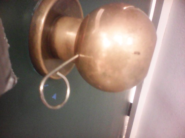

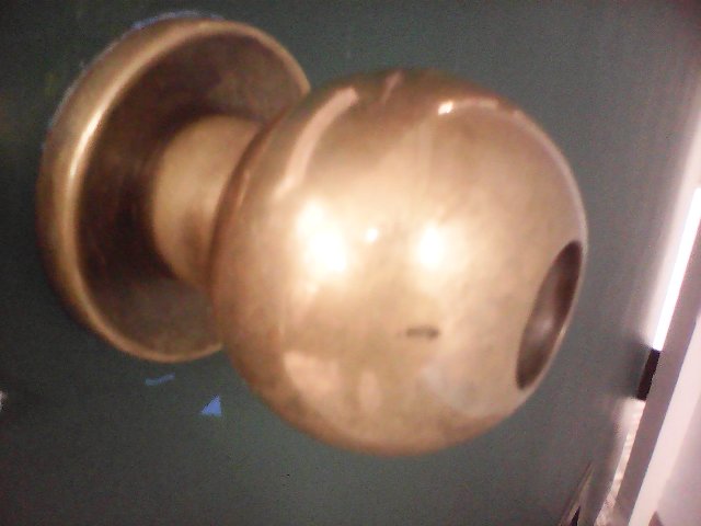

The rose, despite my loosening it from the paint with a thin putty knife, and being able to turn it around and around freely, does not want to pull out/off. I gave quite a bit of encouragement with prying behind it with thin screwdriver and putty knife and even grabbed it with big channel locks pliers and tried turning it and pulling on it at the same time, but that rose remains stubbornly in place just does not want to slide out/off. Any further comment/advice appreciated. Must be some trick to it, I hate to try to force it so hard I cause damage or make things worse.
Edit: On the opposite side knob, I didn't realize it until now but it also has a hole I can push my release pin tool into to try to release that knob. But I've been pushing my pin in there like crazy, but it doesn't seem to be pushing/releasing anything, it just goes in there and stays solid it won't push in. So, need any helpful comments on all this please. Seem to be stuck.

It's possible that the rose unscrews on those. Lefty loosey. And the pin should be identical to the other side. You're pushing in the tab that's in your first photo, if you can feel it. A bit tricky sometimes to pull the knob while pushing the pin. I'm sure you will get it.

The first rose I finally got off with a lot of prying/pulling. It was pretty tight around that cylindrical shaft or whatever they call it, been on that bronze or brass or whatever it is there like that for a good 50 years. Scratched it up some but oh well. Then behind that rose was no screws. That cylindrical shaft itself unscrews, it is fine-threaded onto the opposite side assembly. Then the whole business comes out; didn't have to pull the other knob off at all. Yup got it. thanks

Late to the party again, I'll throw in 2 cents worth for future ref tho. It does appear to be a Corbin-Russwin (or Corbin or Russwin before they merged....Russwin itself was a merger of Russell and Erwin, many moons before that). Unfortunately the grade 1 and grade 2 in the ball knob design during this era look almost identical, but they are installed/removed quite differently. (A photo of the latch would show the difference, as the grade 1 is noticeably larger).
The grade1 is removed by using a spanner tool to unscrew the spindle collar as far as it will go, which allows the rose to back away from the door about 3/8". This gap allows a thin screwdriver to be inserted toward the interior mechanism and push a spring loaded retainer which allows the knob and spindle assembly (as a single unit) to be removed.
The grade 2 (which I think is yours) can be kind of tricky, because a long poke tool (like a large paperclip) must be inserted into the interior knob hole to push the retainer pin. It has to be lined up carefully to catch the pin. The problem is that on occasion, the outer rose was not adjusted properly for the door thickness when it was installed, and that would result in the inner retainer pin being just under the edge of the collar, where you can't access it with the paperclip. In this case, you have to try to unscrew the outer rose (not easy if its on tight, as the indexing tits will resist movement), and this will allow the inner spindle to emerge from under the collar so you can poke the retainer. Then the decorative rose cover is gently pried off, and a large screwdriver can be inserted in one of the slots in the rose to unscrew it, (if it wasn't already loose as result of loosening the outer rose)....whew!
