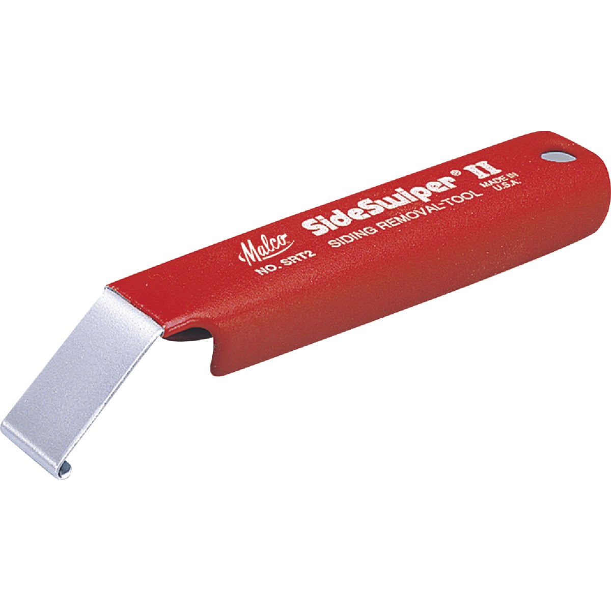

Get yourself a vinyl siding unlock tool. Here's the one I use:
Unlocking vinyl siding is easy, just insert the tool underneath the siding (start from the end) and slide it under the siding. Pull down and toward you while you slide the tool along (left to right or vice versa). Unlock the piece ABOVE the one you want to remove. You can then remove the nails holding the piece you would like to remove and push down on it until it unlocks. Sometimes it's easier to just unhook the siding from the nails and leave the nails in place so that you can rehook the siding later.
Vinyl siding allows water to get behind it, so you might have wind blown rain running down the housewrap. So you'd want to look for step flashings or roof flashings that are on TOP of the housewrap, where water could run behind them. All flashings where the bottoms of your chimney walls meet the roof line should be behind the housewrap.
If there is no housewrap, it should be very obvious where water is getting behind the siding.
