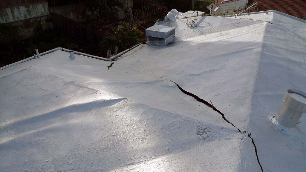

I'm a bit hung up on selecting a replacement roof!
The proposed roofs:
I've received a number of quotes, and my two leading candidates are both reputable companies with long-standing in our area. Both submitted equal bids ($8k).
(1) Modified bituminous, 105 mil thickness applied over fiberglass underlayment. Seams sealed with torches. Uses the house's existing "swale-type" roof drains built in around the edges of the roof. 10 year warranty.
(2) Comp asphalt shingles over two plies of paper + felt. Will sheet over the "swale drains" to provide a sloped run off the roof, and will install gutters to the appropriate edges of the roof (bypassing the built-in drains). 20-25 year warranty.
The house (photos below):
3-story undergoing extensive foundation work. Roof is approximately 1350 sq ft. Leveling the house caused the existing 10-year-old built-up roof to fracture diagonally.
Roof pitch is 3 in 10, as measured in the attic on the underside of the rafters. Steep enough meet the criteria for shingles.
As you can see from the second photo, the roof is not visible from the street. In fact, it's only visible to three or four neighbors behind us, as the property slopes up a hill in the back yard. So aesthetics are not really a concern. For what it's worth, most homes in the area use comp shingles (and on a number, wind damage is evident).

A gash in the roof running 30+ feet opened up after the house was set on its new level foundation.
Note that there are a number of "architectural features" on the roof that need to be addressed during installation. The square box is not an air conditioner or chimney, but the back side of the rising "vertical columns" visible in the front view of the house. There are six of these for the installer to contend with, and have been water entry points in the past.
Also note the roof drainage system around the perimeter.

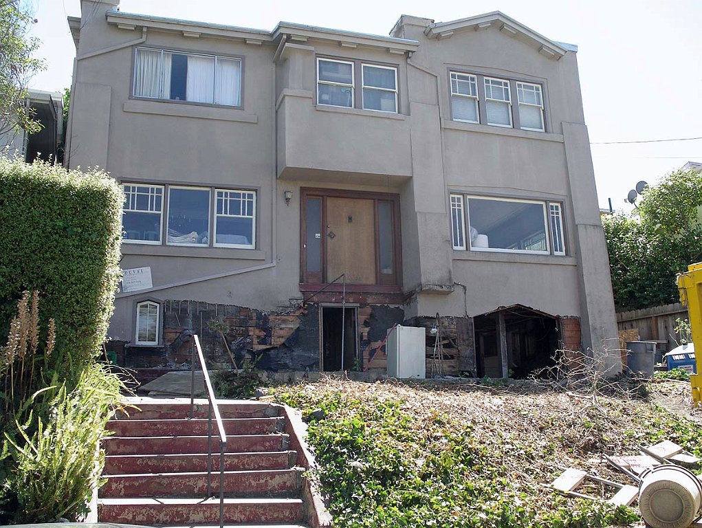

The house as viewed from the street (early in the construction project).
The roof is not visible from the street, so the appearance of the roofing material is not important.
On the other hand, a shingled roof would require gutter installation along portions of the front of the house, which could be a visual detractor.

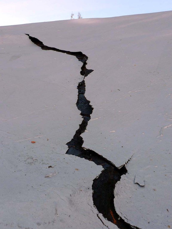

Another view of the fracture:

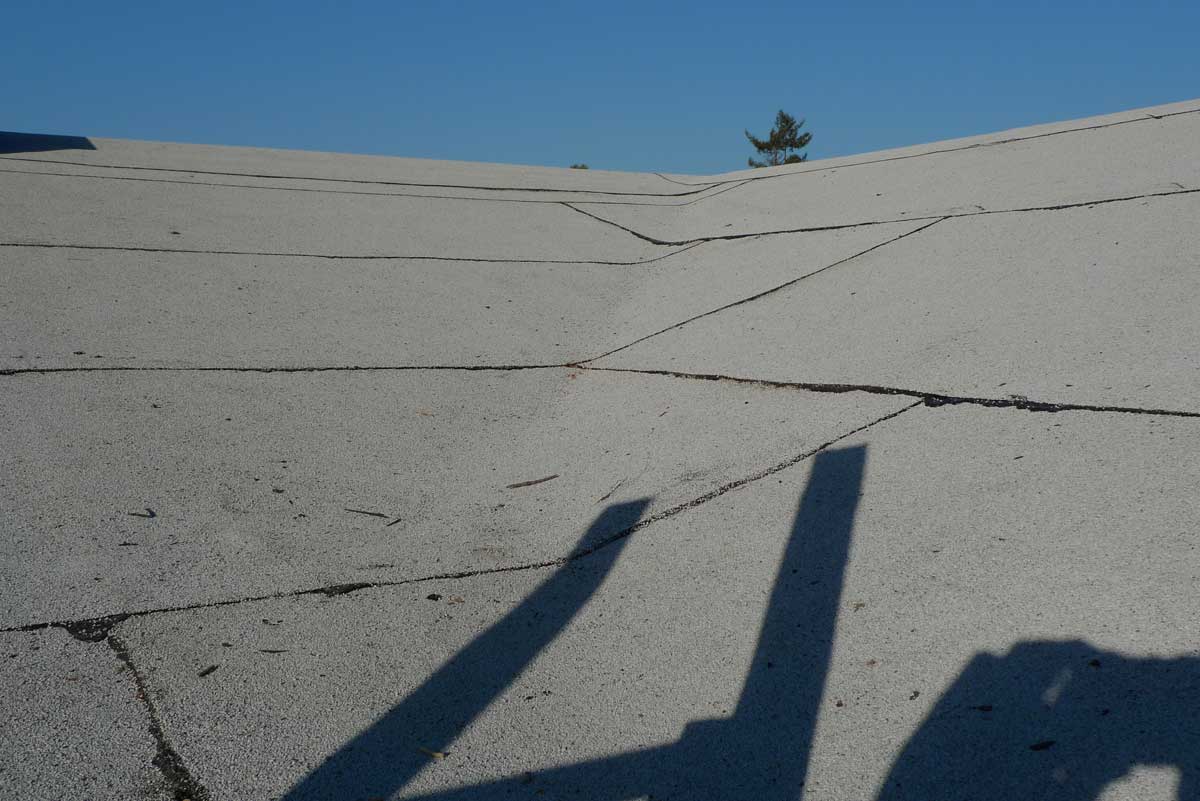

After stripping off the old, we found the roof was in pretty decent shape. Only a few areas needed repair:
Here's the same crease area pictured two above, where the separation occurred:
