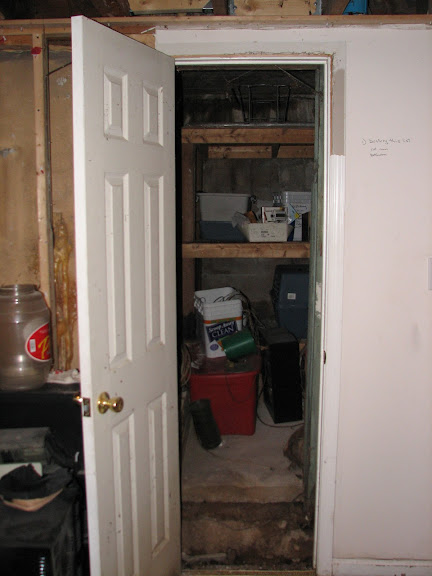

We have a cold room under our front porch which is accessible from the basement, shown here after demolition of the old finished basement has been nearly finished:
And here's a view into it from before demo - note the bottom of the opening:

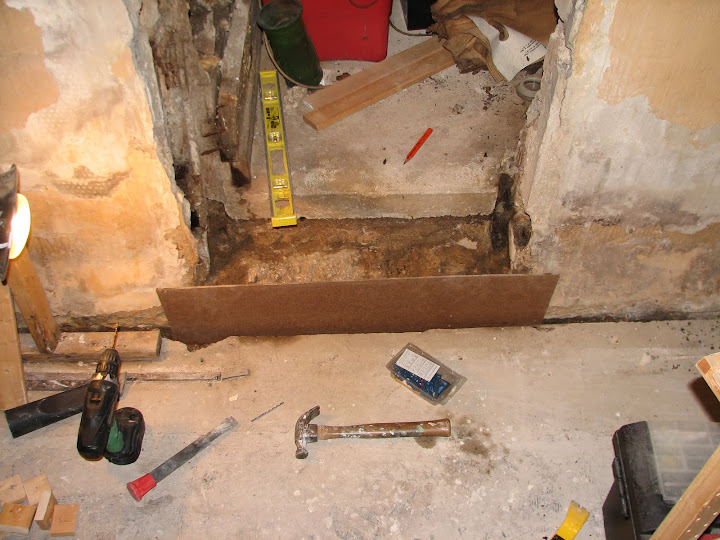

This bottom area is the problem:
When it rains, or when my wife waters her front garden beds, water will trickle around and come in at the corners of this rough spot. Below the rough spot, and around the entire basement, there is a shallow trough that has been cut into the concrete (or perhaps it was poured that way), which I presume was intended for water drainage.
So - I need to figure out how to waterproof this because we intend to re-finish the basement, eventually. I was thinking that I could pull out the old door frame and set up a form which protects the trough and creates a step up into the cold room, then re-install new wood in the door frame and build out from there to put in an exterior door for access.
Does that seem feasible, or should I take another approach? Another thought I had was to chisel out more of the existing concrete and put in a trough drain that runs to the sump pump (4' to the left of this shot).
Any input, suggestions, advice, ideas are welcome - I'm a bit out of my depth here and don't want to go down the wrong path.
Thanks

I don't think you will have much luck trying to seal the area to prevent water from eventually getting in. Keeping the water out is difficult/expensive unless it is tackled up front during construction. I would give the water a good path to your sump pump.
After watching the water come into that cold room for the last fortnight or so during heavy rains, I've concluded that you are absolutely right.
So I decided just to "clean up" the step a bit and make it look more solid, and I think when I begin to frame in the new finished basement, what I'll do is hang very heavy plastic loosely over the opening just to act as a water shield to keep it from splashing into the new wall on its way to the drainage trough.
Built the form and poured last night - removed the form this AM but didn't upload those pics yet:

You could always try whatever waterproofing you can easily do to help limit the amount of water coming in at that location. I don't think you can stop it 100% but you might be able to slow the flow down.
