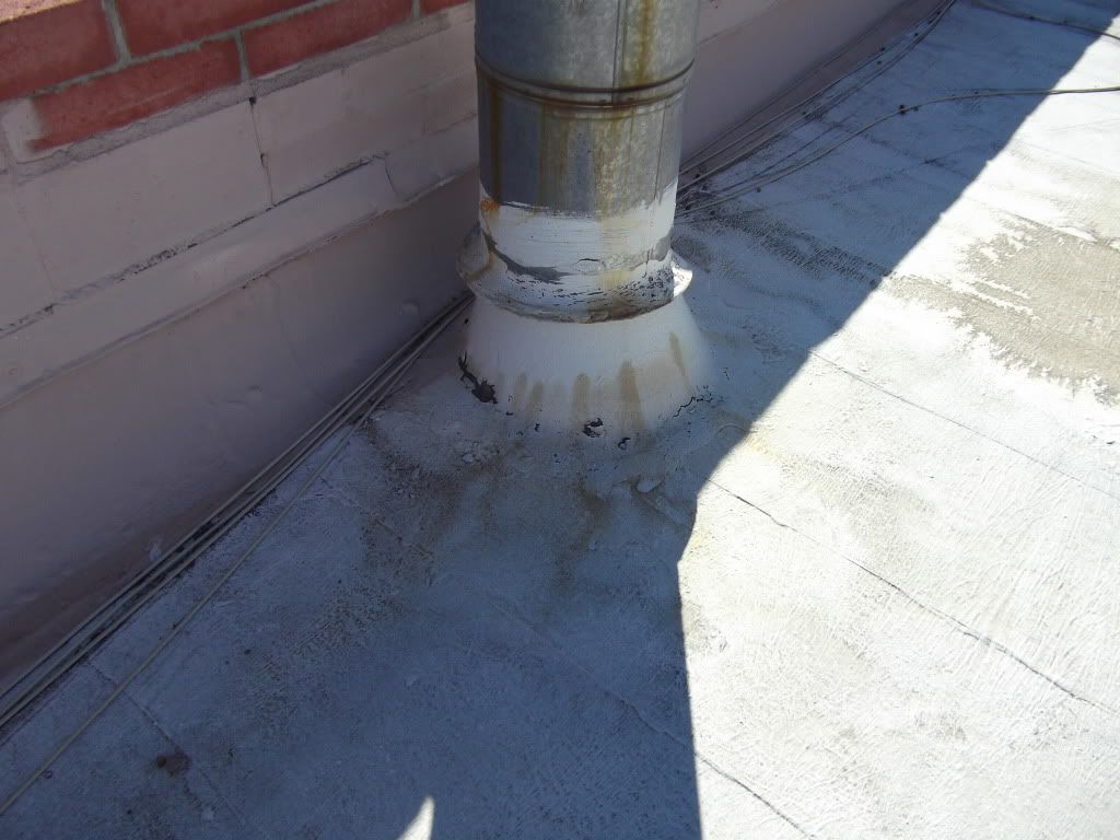

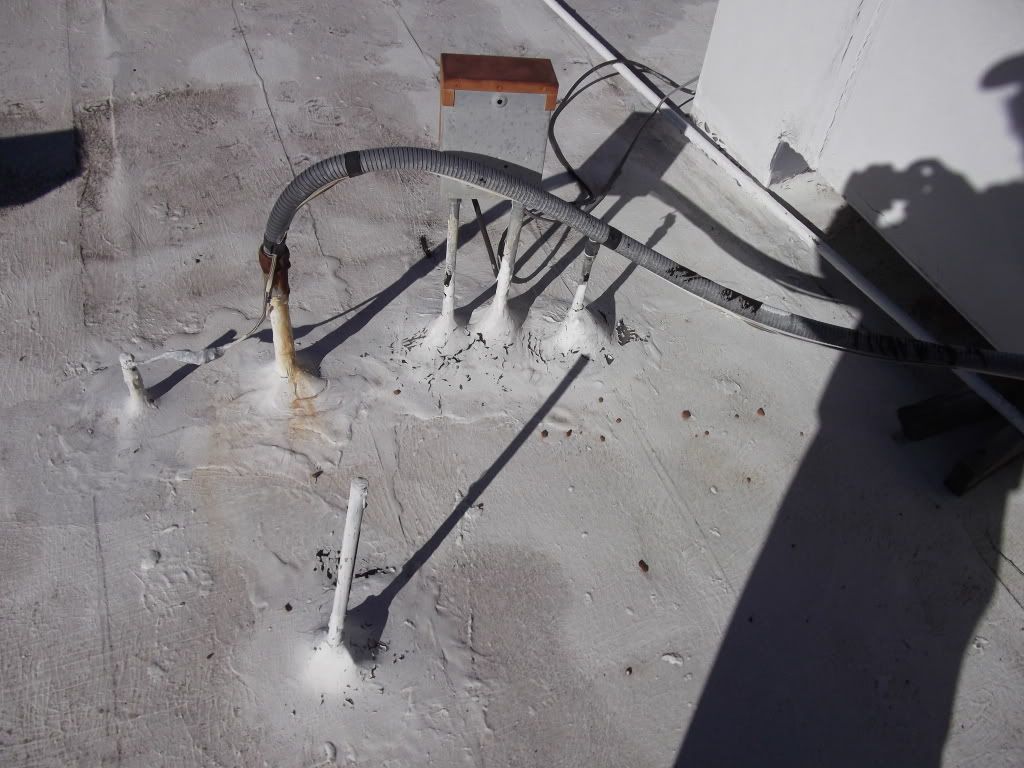

i'm considering purchasing a 1300 sf fannie mae foreclosure in tucson, az. the flat roof appears to need some cleanup and another coat of elastomeric at very least. theres no blistering or cracking of what appears to be 2 ply bur, but the elastomeric is peeling in some places, particularly around the pipes coming up through the roof.
would a diyer simply dump elastomeric, on the roof, a 1/2 gallon at a time, and spread or roll it with a roller until the proper coverage is achieved?
in places where there is no peeling, since the roof has been coated with elastomeric before, is one coat all thats needed?
can a garden hose with a nozzle be used to wash the roof prior to painting?

While I used to work for a company that did some elastomeric roof work, I wasn't very involved in that part. Is the elastromeric peeling or is it where the tar underneath it has expanded and contracted stretching the limits of the sealant?
As long as the roof is clean and any loose material dealt with - a fresh coat of elastromeric should do fine.

A pressure washer can make cleaning easier but improper use can cause damage. Too much pressure in the wrong spot can produce a leak. You could use a water hose although you might need to add detergent, an old broom and elbow grease to the mix Make sure the roof is good and dry before applying the elastromeric coating.

if you have a lot of mold or mildew I would pressure was but your pics don't look like there's not much
