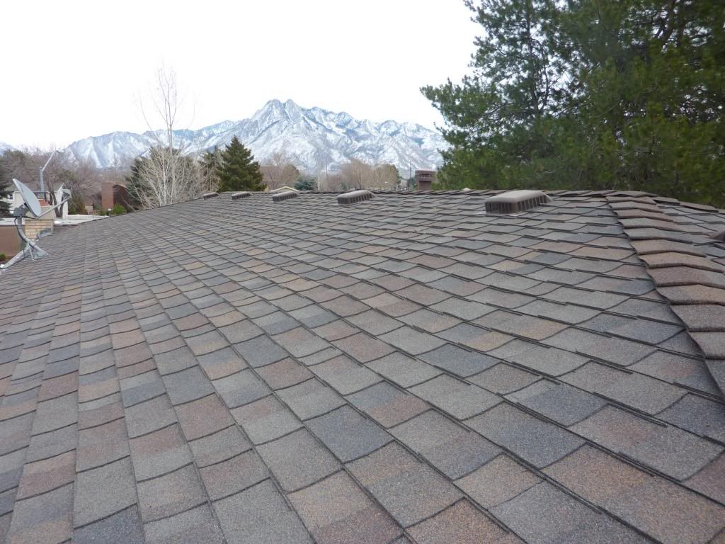

I hate to beat the ventilation thread to death but have read most of them and nothing is answering my question so here goes. I have a mansard roof that was retrofit over an existing tar and gravel. I had the roof replaced 4 years ago and now am see the shingles starting to curl which tells me I have inadequate venting. Problem is that I have no soffit to install venting, no place for gable vents. I have turtle vents on the ridge-line but nothing down by the eaves. Would it be ok to install turtle vents near the eaves to promote air movement. The original gravel roof has venting but no way to install any soffit venting for the mansard roof. Thank you for your help.

Sorry for the delay for more info on my problem the sun came out and the snow melted so now I can post some pictures.
Vents on ridgeline
Soffit venting for old tar and gravel roof.
Mansard roof that covers soffit vents for gravel roof so there is no way to install any venting for the roof addition.
What would be the best way to vent this area. As for being in cold climate it gets hot here 100+ with very dry air. Thanks for your help

I hate to ask for more pictures
, but I'm just not familiar with how that style building is put together. How large are the attic spaces and where are they? Maybe a picture from farther back will help me?
Here's another link on interesting options. SmartVent Midroof Application - Do you have a ventialtion question? Call 1-800-622-4455
