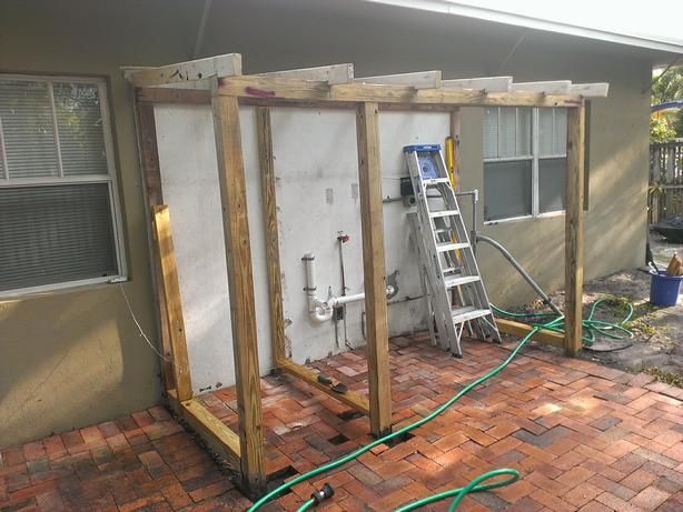

Just tore down an old lean-to wood shed in the back that lasted about 20 years.
The old shed.
The new one has just been framed in, with 3/4" plywood all around - which I learned later on is not the best material but the old T1-11 was thin and warped badly so I wanted something thicker. In any case it's all in and I need to paint the whole thing over...it's been pouring the last few days so the wood is being soaked.
Here are the newer pictures.
I just realized on the two sides the way I framed it I have a flushed wall with the roof. Not even a little overhang. I wonder if I need to fasten a piece of 2X4 along the top just to have a little bit of overhang so the rain won't be spilling over the sides constantly. Well even with a 2X4 with gives only another 1.5" it probably will anyways. Is it going to help any?
The next question is now that I have a roof deck of an area about 11' wide by 4' deep. What is the best way to roof this? Do I hire a regular roofing company to come put flashing on the back with the concrete wall, drop edge all around, then felt and shingle/metal? or is there a more economical way for sheds like this? A neighbor suggested just flash the back wall and put a shower pan liner over the whole thing.

In apposition of using a false rafter system, installing a 2x4 on the side matching the rafters will at least give some run off protection. Your decking can extend a little beyond that, too. I would use two sheets of decking, cut to where it is equal on both sides (slightly offset due to your rafter positioning). You want to span at least 3 rafters with any sheet goods. Why hire anything done on such a small project? You can do it. You have the technique (with the exception of your neighbor's suggestion) in place. flash the back onto the deck, install drip edge all around, Plytanium or felt, then shingles using 7/8" nails.

I'll have to step back a little on my previous post due to Mark bringing it up. Is that your roof??? If so, it is horribly too low a pitch. I was thinking you would install a roof over this with a pitch. Shingles won't work here.

There is a pitch, about 5" over 4 feet. It looks flat due to the camera angle.
I am open to suggestions in the roof materials.

That is still almost flat. No shingle roof will work with that pitch! I think the only options would be a hot tar roof or maybe metal ..... but I'm a painter not a roofer so wait and see what they say.

Do you have room to add more height at the back so you could increase the pitch?
I don't think you're going to get to a pitch which would allow shingles but any little bit might help.
At this point something metal seems the best option.

I vote on slatting it and installing a metal roof since the pitch is so shallow.

Might consider using mineral surfaced roll roofing.

Way to late to be asking once it's already been built, but there is a way to make lemon aid out of lemon's.
Should have been at least 2 X 6's as a bare minimum to gain some slope.
Now your stuck with having to cut some tapered 2 X 8'S and attach them to the top of the 2 X 4's to gain enough slope.
And add at least 2 X 6's so the over hang on the two outside edge's.
That house wall also will need to be cut with a diamond blade in a ciruler saw or 4-1/2" right angle grinder to be able to slip in the needed Z molding.

Well I pretty much matched the previous footprint & slope, and the old shed lasted over 20 years. I don't necessarily need 20 years out of this, 10 years I am hoping. The 4X4 posts would rot out first.

I remeasured and the slope is 12%, so over that 4' depth, the drop is 5.8". A little less than half is under the main house's roof overhang.

If my figuring is right that is about a 1.5/12 pitch. Shingles require a 3/12 minimum. My biggest concern with a metal roof would be sealing the flashing well. While it would be protected from straight falling rain any wind driven rain has the potential to find it's way to the flashing.

With there being that much overhang from the main house's roof/eave as well as the shed roof being that close to the underside of the house's roof I would just use 50 lb. roll roofing with the seam between the upper and lower course being sealed with a swath of roofing cement about four inches wide under the lower edge of the upper course. I probably wouldn't even bother with a head flashing with it being that far back.
