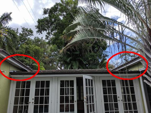

I have a roof leak (wet stain in the ceiling) only during driving rain. I know where it is leaking but I am not sure the best approach to fix this. I may end up hiring a roofer but still would appreciate knowing the best practice.
Here is a overview picture. You can see in the middle I have a lower roof that slopes to the front, but I have a higher roof on the left and right sides that slopes towards the lower roof. So on the left and right side there is basically a triangular sliver of a "wall".
The leaks are under these two walls. The right side leaks much more when it's raining.

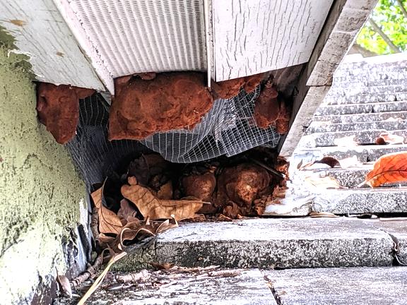

Here are pictures of the left side wall.

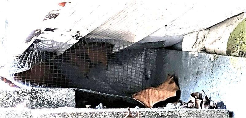

The flashing is visible. It should be under right? Where the two tapers together is basically a 1/4" rabbit guard pushed back there then a bunch of foam which seems to be half way disintegrated and very brittle.

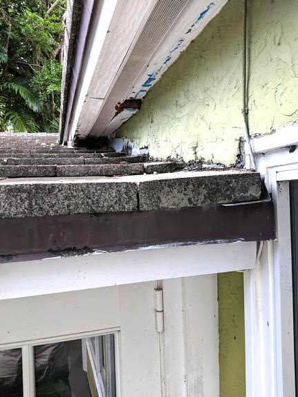

On the right side it's more of the same.

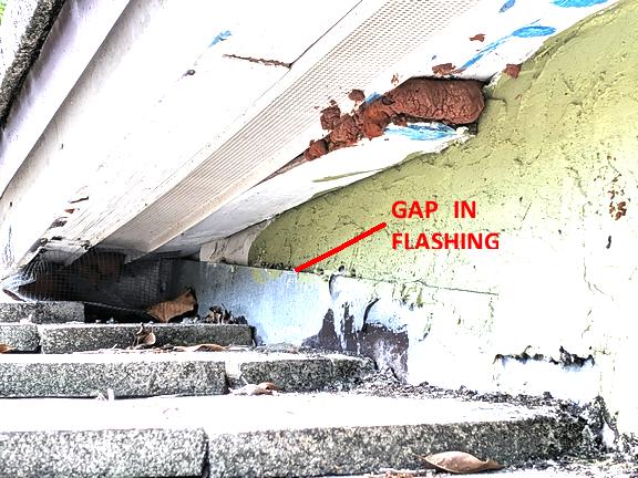

There is a soffit coming loose and it was sealed with foam. I also see a slight gap between the flashing and the stucco which I think is where the water may be getting in.
If I get real close to feel around I also see silicone caulk, and some dried up cracking tar, so I think it's been a problem for a while and repeat attempts to fix the leak.
What is the proper way to correct this?

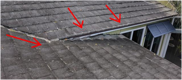

Here is a view from the top where the two roofs come together on one side, the other side is the same but mirror image.
As you can see, there is a lot of water coming down that path. The higher roof is dropping everything from the crown down to that edge, and there is a valley higher up that also lead to that spot. With a gutter taking the water from the higher roof would reduce the water coming down there, but won't impede the flow from the higher valley. May be a tear out of the stucco to expose the bad flashing is evitable, but I am not sure what is the correct way to seal and finish where the eave/soffit converge, it can't be just shoving some wire cloth and large quantities of spray foam right?

It is hard to tell if this is a one piece flashing or a step flashing.
In the second picture it looks like there is an overlap but the overlap is wrong re: the lower flashing overlaps the upper piece and it should be the other way around.
Also looks like there is rot but again hard to tell with all that spray foam.

I would say that the most likely spot for a leak is that intersect point or the channel between the roof lines.

But the concrete roof tiles are applied over some very thick paper membrane and attached with foam. It was permitted and complied with Florida hurricane code - but over ten years ago. I think the eave/soffit issue came later, this can't be original but someone has been hacking at it multiple times - there is tar, there is white caulk, there is clear silicone, wire cloth, spray foam.
I don't know if the wire cloth + foam is supposed to be a way to stop critters from invading, or whether the wire cloth was intended to act as lath/key for the spray foam to hold as an effort to stop water penetration.

None of these materials is an acceptable solution to your issue!
Correct. That's not what I was suggesting. I was describing what is there now...existing conditions.

Hey I'm from the north east did u see you say you were in Florida? Up here yeas ago probably 15 or plus I would see that alot on older houses and the undereavr there covered by the wire is actually your fascia soffit. Its venting the walls and roof of your attic. The wire is there to keep the rodents out. Check out the valley where both groves meet first. That way if its dry you can eliminate probably the only other place you'd be getting water from. And yes I'd do some material swap there. The rake is supposed to be wrapped with metal when on a roof and exposed to so much water exposure.
The lower roof has a shallower slope than the upper roofs. Does the lower roof tilt toward either or both problem areas (walls under higher roofs)?
