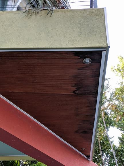

I have a couple of projects that would require me to work on the underside of my second floor. However there is no first floor, the second floor is overhanging my swimming pool.
First, I need to change out (or eliminate) the light fixtures on the under side, it's basically impossible to replace the light bulbs. Right now the bulbs are out and I can't even figure out what circuit it's on.
Second, there is an electrical receptacle up there, and I guess it was intended for Christmas lights. I need to check the wiring and see about relocating or eliminating that receptacle.
Lastly, half the bead board soffit has water stain on it, which I assume it's from a leak coming from above. Right above that is the second floor balcony. Once I fixed the leak I will change out the soffit to something else. May be T1-11 or stucco.
So in summary I will need to figure out how to work on that area for a number of days to do electrical, carpentry, waterproofing, painting etc...safely. I think a scaffold is needed.
The pool section directly underneath is 11' wide. The soffit section directly above the pool is 13' wide. From the pool coping to the soffit is 12' of height.

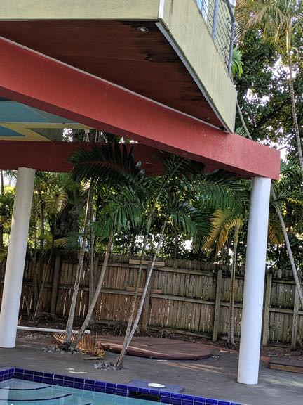

Should I rent something, buy something, or rig something up myself that will give me the height I need and yet would span over the pool?

It's hard to recommend anything without actually being there.
From what I'm seeing I don't see how a scaffold will even work with the pool under it.

How wide is the pool? If its only 20 feet you could rent a 24ft long, 20-24" wide x 6" aluminum walk plank. Also rent a couple sections of scaffolding and 8 screw jack lags with mud sills. This would enable you to set up a section on each side of the pool to rest the plank on. You want the kind of scaffolding with the ladder built into the sides.

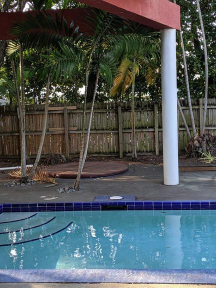

The pool is L shaped, but the section below the balcony is 11' wide.
The balcony is 13' wide, slightly wider then the pool.
The height of the soffit is 12' above the pool deck.
Scaffold is 5 ft high... screw jacks get you another 12" higher. The plank is 6". So you'd be standing 6.5ft high. If your 5'6" to 6ft tall that's about the right height. Screw jacks could go up another 6-8" or so if needed.
