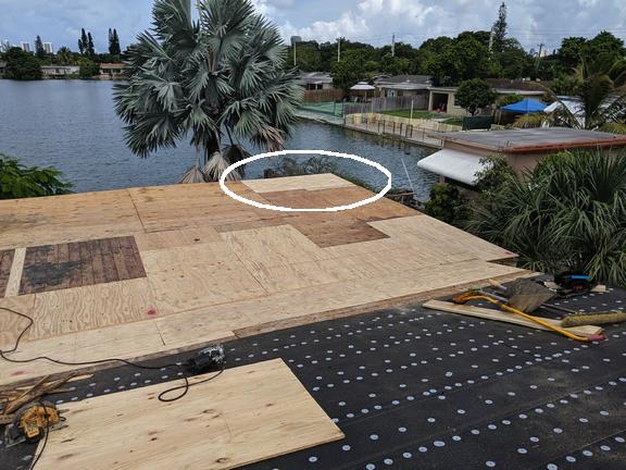

I hired a roofer to do a complete roof replacement. There are quite a bit of rotted lumber from leaks as well as termite damages. They had to sister in some 2X8 on the flat roof because the rafter tails had to be reinforced to install the sub-fascia and fascia.

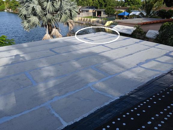

The top side of the flat roof is already completed and passed inspection. I have circled the area where the issue is on the underside. Unfortunately I do not have a picture of the framing on the top side prior to the plywood installation.

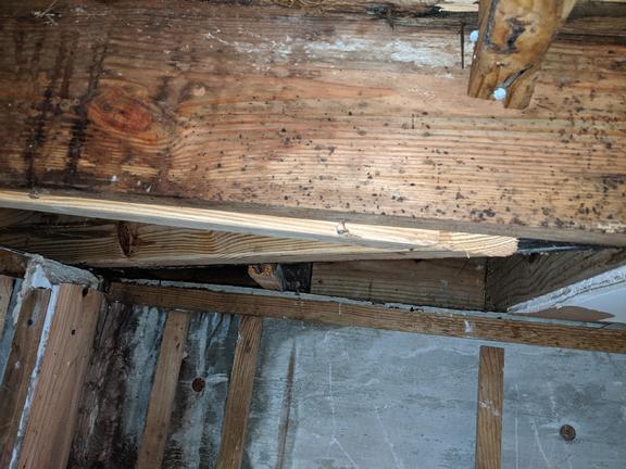

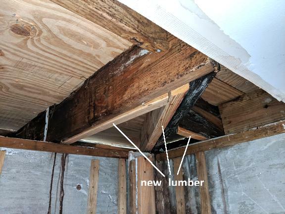

What I noticed is the new sistered 2X8s is lower then the original 2X8s. In the picture below, you can see three pieces of new 2X8s (lighter color), and those were installed lower than the original 2X8s.

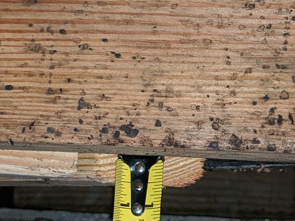

They lined up with the original 2X8 at the top of the exterior walls, but dropped down below them on the other end. How much lower? About 5/8".
I am thinking the ceiling collapsed because when they inserted the new 2X8, there were debris on top of the ceiling, they hammered the lumber down anyway, causing it to come loose. Once it got loose and dropped down 1/2" or so, they continue to hammer the lumber to match the loose ceiling.
If I feel the top of those new 2X8s, I can insert my fingers between the 2X and the bottom of the plywood, I can even feel the shafts of some nails.

I have many such repairs and don't see anything out of the ordinary. Trying to scab on sisters with old rotten and crooked wood with nails in the way can be difficult. If there were a roofing nail sticking down it probably kept them from getting that end of the sister all the way up. As Xsleeper mentioned fixing it is a simple matter of cutting off the offending bit that's sticking down. I would use a reciprocating saw but anything from a hand saw to a chisel could nip off the part hanging down.

OK I know it can be corrected from below with a sawzall, or a planar, or even an angle grinder with an aggressive flap disc.
But my concern was the top side. It's unusual to have ALL THREE pieces of 2X8s sistered crooked and off by this much. When you sister in typically you tap the new piece down until flush with the top of the original piece, yet all three pieces were tapped lower by 1/2" to 5/8". Why?
The only reason I can think of is they have pushed the ceiling loose somehow probably debris in the way of the sistered piece as they hammer it down pushing the ceiling out of the way, now they tapped the new pieces flushed with the loose ceiling at the bottom, but then they could have clearly see the top being off, but they didn't, and my only explanation is the top side was so rotted it crumbled enough to make it hard to judge. But there was enough loose material on the original 2X8 to allow the plywood to sit "right".
So now, my worry is I have the original rotted piece kind of holding up the plywood. The new 2X8s are sitting low on one side. The nails they shot in from the top is only partly secured to the new wood, so if I walk on that corner, the plywood may flex a little to allow the nail head to back out of the plywood and rip the paper and mopped tar. As I said I could fit my fingers in between the bottom of the plywood deck and the top of the new 2X8s as well as touched the shafts of the nails in between. Do I need to make small shims to tap in between and pack some wood filler into the slivers or am I overthinking?
