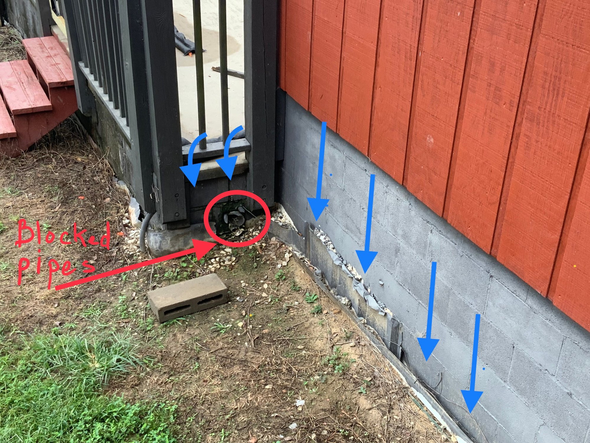

Water leaking into basement…how would you fix this?

We bought an older house and the basement leaked. We’ve repaired everything to stop the leak except this one corner. Any thoughts on blocking it off or sealing it? TIA

Welcome to the forums!,,,,,,,,,,, Is that covering up an old window?

That looks like a mess. Possible below grade window, possible dryer vent at ground level. Some sheet metal or other stuff in the ground...
Normally I'd say do the usual stuff like make sure the house has working gutters and downspouts and the water is directed well away from the house. And to grade around the house so all water flows at least 10 feet or more away from the house. But, in your case I'd start digging to find the source of the leak and what is going on in that area.

That looks like somebody poured a concrete patio and re-routed a downspout right into a boarded over basement window.
As said above- use downspouts to get as much water away from the house as possible.
IF that IS a downspout poking out of the concrete base, I'd consider re-doing the downspout so the water leaves at a higher point, and point the downspout away from the house.

You don't say anything about gutters and it would be good to know if they're nearby. There are two ways for water to get into the basement, either up from the ground or down from rain. I would get some 10'X25' plastic sheeting and slope it away from the house to see what happens. If that solves your problem, do something to make it permanent. If you have water with the sheeting, you may have an underground issue which requires a bigger fix.

Thanks for the responses. I’ll clarify the best I can.
We recently purchased this house and the previous occupants thought themselves quite handy, They were not.
The entire basement was leaky so we, and professionals, sealed it up and now it’s perfectly dry except for this corner. Those pipes you see, literally go nowhere and do nothing. They are capped off on the other end. There’s no window.
So I grabbed a hose and some handhelds and pinpointed where the water was getting in.
Gutters aren’t part of the equation. The water flows from the deck toward that corner and pours into the gaps you see. If you look closely you can see the quikdam diverting water and that’s how I know where the water is entering. (Or not entering with the dam in place)
I could divert the water by creating a barrier diverting the water, but that’s not the answer.
What I’d like to do is lay a cement slab covering that entire wall and corner, sloping away from the house.
Having said that, I feel like that’s to simple of a solution, or there’s an even better way to fill up that entire gap and make it look good as well.
Apologies for not being more clear and thanks again for reading.

Water is either coming in from the surface or under ground. Best to eliminate and ground source water to see if water stops. You cannot block water. You can only divert it to give it a more desirable place to go. If the source is above ground it should be easy to build up around your house, keep gutters clean and discharging 10 feet out and run further out. I suspect from the photo you need to build up and grade away in the area in the photo. If it underground water you either divert or pump it out but much more work involved. hope this helps.

It looks like you are purposely diverting water to the foundation. There should be no rain funnel there. What is in the pink circle ? Looks like a perfect area for the rain to follow.
Typically the ground is sloped up to the foundation so that the rain water is directed away from the house.

You are correct Pete. It’s a hot mess. I have no I idea what the previous owners were thinking or the DIY disabilities that plagued them.
So, that’s my question. What’s the best way to plug all of that…the craziness against the wall as well as the corner area…
I was thinking fill it all with concrete and create a slope away from that area, but asking around for a better solution if one exists.

You've asked several times how to divert the water away and several people have asked about that weird panel that's half buried but we've gotten not answer from you what it is. You need to find out what it is before simply burying it under concrete.
