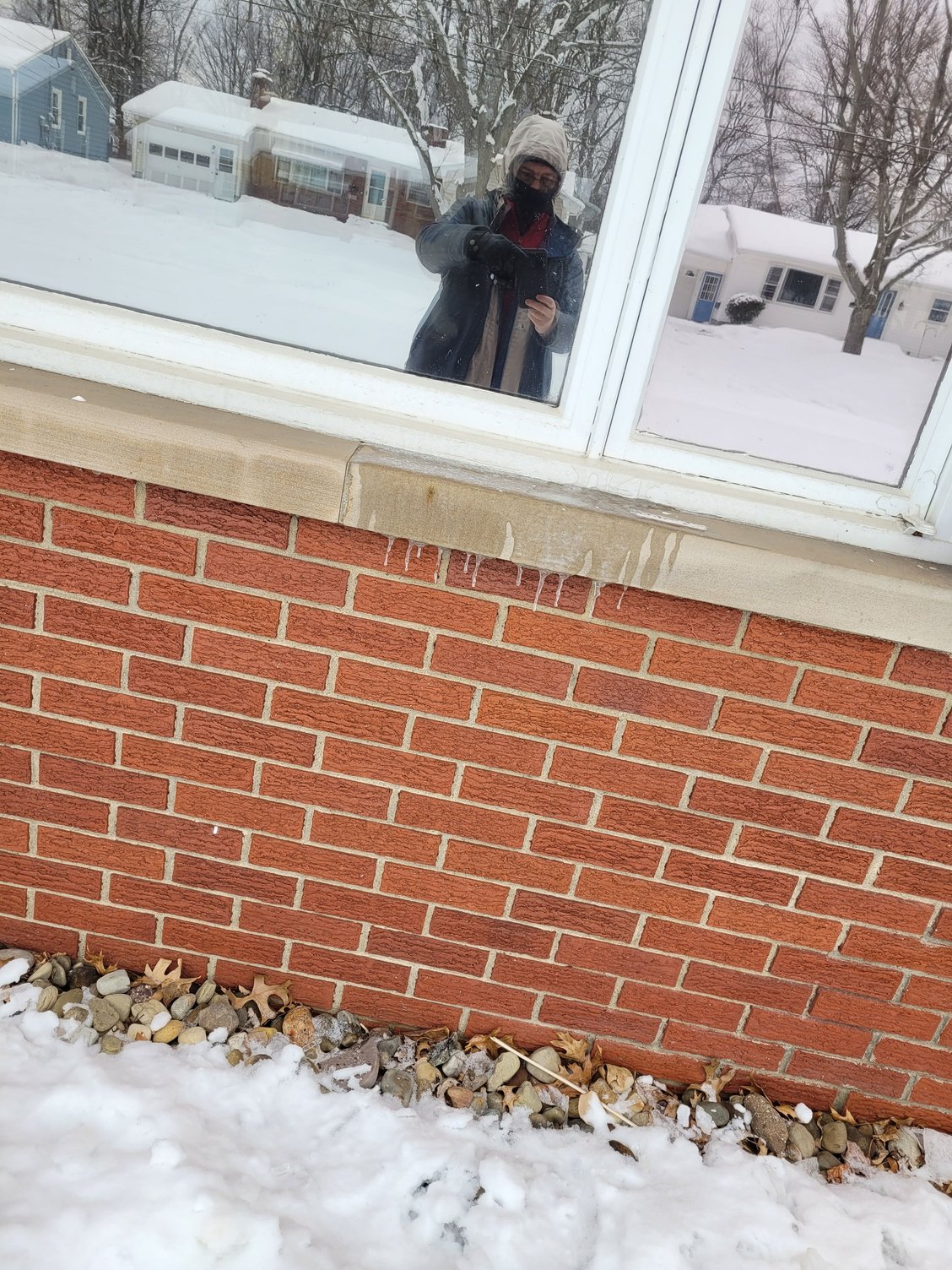

Question Water coming in top of large bay window
I have a large bay window. There is currently ice and snow right above it on the roof. In certain spots along the top between the wood, water is getting in here and there and dripping down. I did what I could with what I had: spray silicone water repellent into it while drying it with paper towels and a hairdryer. It seems to have stopped for now. I plan to use some NeverWet on it inside and outside to repel the water more thoroughly for a more extended period. Someone suggested it could be a roofing problem.
What could it be? What would you do? Should I call a roofer?
Shows area in window frame water was coming in between. You can tell it by what I patched with silicone spray.

In my opinion a roofer is the place to start. Could be the flashing between the wall and bay window roof shingles has deteriorated and is allowing water to enter. Is it possible to sweep the snow off the bay window roof after storms?

Could be an ice dam. Without seeing it, it's hard to say.

We don't really need pics of the inside, it's the outside that we need to see so that we can tell where the leak is coming from.

Trying to fix it from inside is a waste of time.
You will just trap moisture up there and it will cause a lot of damage in the long run.
Unless you can see something obvious outside get a roofer.
You cannot even say it is an ice dam so until there is more info you cannot go any further.

We need a picture of the area where the water is coming in and above. Take a picture from further away and maybe one from the side so we can see the roof over the window. Judging by the snow and ice in your photo I don't know if we will be able to see much though. We are looking for details of how the bay window roof meets the house and how it is flashed to keep water out.

First, this is a picture window not a bay window. A bay window protrudes out from the house. They need a roof of their own since they are not flush with the exterior wall. Just a clarification.
My guess is you have severe ice dams built up starting at the eves and going back/up the roof. These are usually caused by heat from the ceiling heating the bottom side of the roof and melting the snow. The snow above it hides this from view. As the snowmelt runs down the roof it hits the cold roof under the overhang and freezes to the roof. This continues unseen and builds up to an ice dam working back up the roof. Eventually the water works up under the shingles and finds its way into the underside of the roof. Then it runs down the underside until it reaches the exterior wall. It then flows down the wall often inside the wall cavity. This water is likely hitting a horizontal framing member above your window and then exiting and running down the window frame. This is what you are seeing.
I suggest you go into the attic and see if you can get to the area of the roof where it meets this exterior wall above this window. See if the underside of the roof is wet. If so, it can be because there is not sufficient insulation there thus allowing the heat leaving the house through the ceiling below. Or, it could be because the insulation is blocking the soffit vents from allowing cold air to flow up from the soffit or eve vents toward the ridge vents.
This is a lot to understand. There are many threads here and elsewhere on the net explaining the causes an ice dams and resulting water damage. I suggest you spend some time reading about this. Then go into your attic and explore what I explained above.
