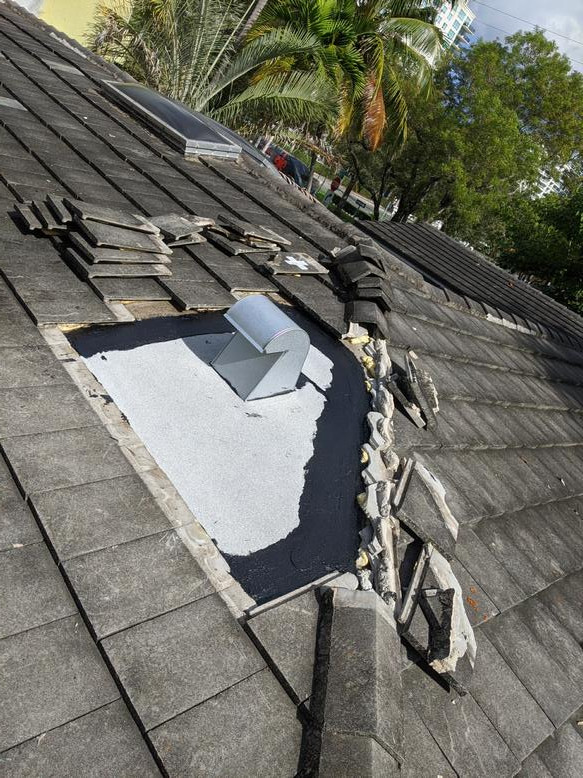

Here are some pictures.
This one shows the waterproofing before the tiles are put back. The existing tiles were also attached with some expansion foam.
The original tiles have holes for nails but never used. The replacement tiles for repair have no nail holes.

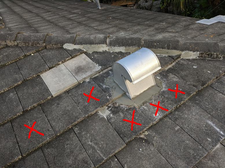

The next picture shows the five tiles I removed (RED X) due to the expansion of the foam raised the tiles. The stucco patched between the tiles and the vent cracked also due to the tiles moving.
The top of these concrete tiles are flat, but the back side is a bit curved.
By how much were the tile raised? Was the foam unsightly. The waterproofing should be fine and I don’t see a problem as it is now. I notice that your roofer used mortar instead of cutting a new tile on the left side of the vent. A new tile cut to fit would have been more appropriate. If the tile are not nailed what prevents them from sliding down the roof? If the existing underlayment below what has been repaired is water proof you should be fine.
