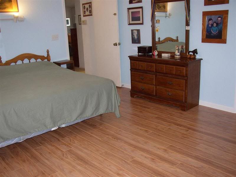

the_tow_guy's Avatar
Join Date: Feb 2001
Location: SW Fla USA
Posts: 11,859
Received 38 Votes on 30 Posts
Love mine. Did our bedroom recently (concrete slab) and I have no complaints with feel or sound. I think OneBowl makes an excellent suggestion to break open a box and trial lay a section; that should either confirm your fears or put them to rest. BTW, ours is laminate, but with beveled edges and a surface texture it has a very good look and, out of the box it did seem a little flimsy as you say:
Old 06-08-08, 08:23 AM
Join Date: Oct 2006
Location: sw sub chicago
Posts: 1,130
that floor looks nice.
so, tom, what did you end up doing ? i am going with the engineered, myself.
