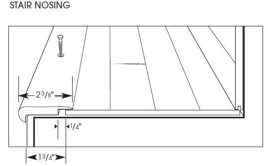

we had to order a stair nose for the flooring we're putting in. it has'nt come in yet, but we need to know what end of the laminate board will go into the stair nose?

Doesn't matter. The nosing rests on top of the plank, but does not attach to it.
