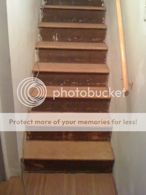

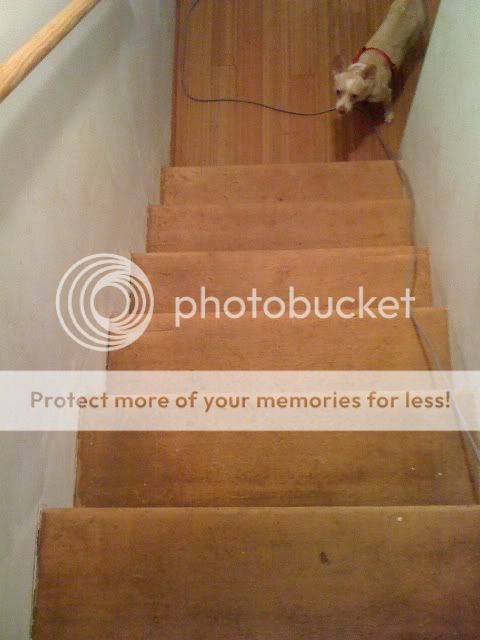

As for the way it's looking, maybe I can post some pictures. I'll see how it goes.
[IMG][/IMG]

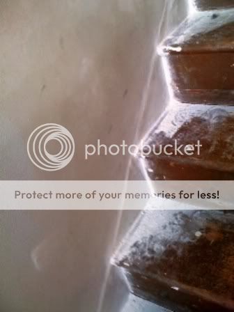

Mid - The wall doesn't even make sense! These lines were clearly visible with the carpet...
[IMG][/IMG]
Now
[IMG][/IMG]
- Almost there
[IMG][/IMG]
- So far so good
[IMG][/IMG]
God help us all.

The lines along the stairwell is where someone added a layer of sheetrock over the skirtboard. Sheetrock is 1/2" and the skirtboard is 3/4", so you will always have a telltale line there.
